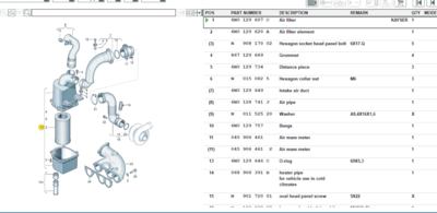

I'm looking to reinstate the OEM air filter box on my 1.4 TDI and was hoping someone could help me out with correct part numbers? I made the mistake of installing an induction kit and chucking out the old one! :roll:
This was few years ago now so please correct me if I'm wrong, does it come in two parts? An upper box which connects to the AMF sensor and a lower box which actually houses the filter? I've seen two variations for the lower box with one or 2 exit points, part numbers 6N0 129 620 A and 6N0 129 607 C?
Does anyone know what the setup is for a 2000 model with engine code AMF? Any diagrams or photos would be great! Cheers

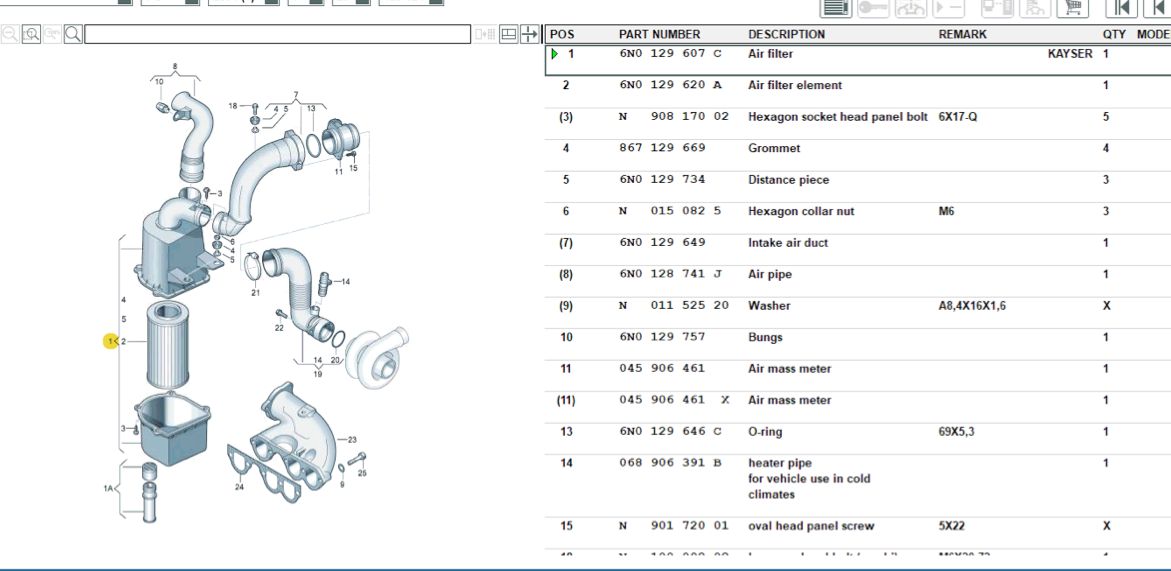

While you're at it, would be able to get the diagram for the following, this is what I believe sits on top?
eBay item no: 273030004900
(There's a part number in one of the pics)
Much appreciated!
alexperkins
Site Admin
Posts: 14866
Joined: Sat Nov 11, 2006 5:29 pm
Drives: 91 Golf GTI, 01 TT 225, 54 T5 174
Location: Poole, Dorset, UK.
Re: Air filter box for 1.4 TDI code AMF
Post by alexperkins »
Ok, so that is part 7 on the same diagram. The part number in the ebay listing has been superseded to 6N0 129 649
