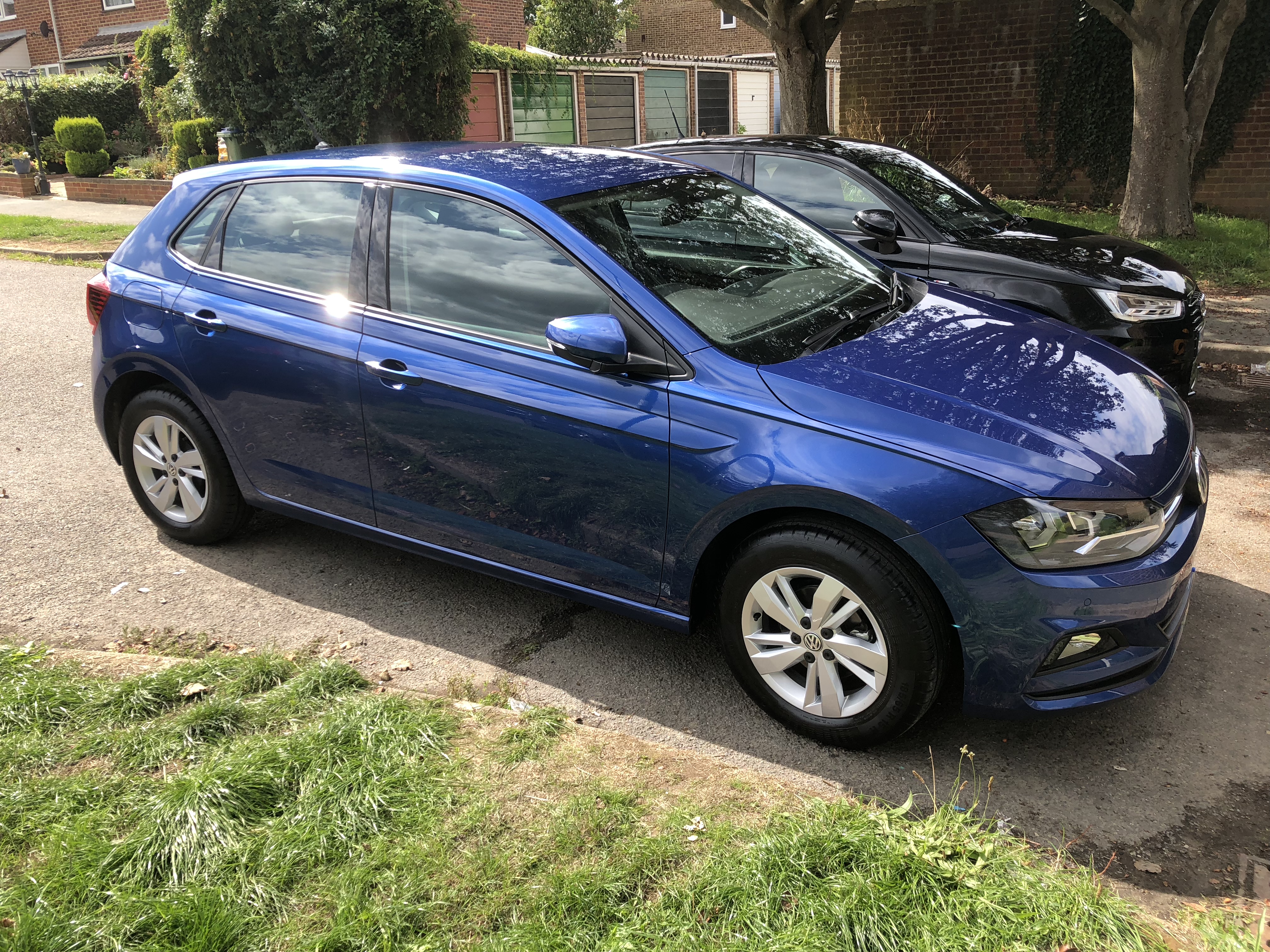

As my daughter is away for a few days I thought I would clean her car for her.
The process went like this.
Snow foamed the car and wheels using Bilt Hamber and left for 10 minutes
Jet washed the car and wheels
Hand washed using Swissvax Carbath and Swissvax Washpudel and I used the two bucket method
Jet washed to make sure all suds were rinsed off
Hand dried using Swissvax drying cloth
Pre cleaned the car using Swissvax cleaner fluid and polished with Swissvax micro fluffy cloth red
Applied Swiss Shield wax, left for 5-8 minutes and polished using Swissvax micro fluffy cloth grey
Pre cleaned wheels and then applied Swissvax autobahn wax and polished using Swissvax micro fluffy
Meguiar’s tyre gel applied and any excess wiped off
Glass cleaned using Autoglym Glass polish
303 Protectant applied to interior and exterior plastic
As you can see I use a lot of Swissvax products and although they cost more, I find the finish is better and the shine lasts a long time. Slim’s detailing or Polish Bliss are both excellent and always helpful if you are unsure about what products to use.

car looks really good, something I'm looking at doing to mine very soon.
great job
