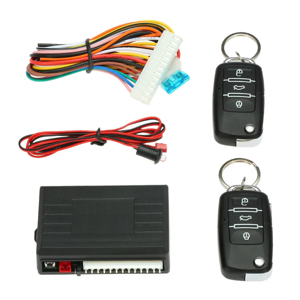

My polo was a trendline basic version. It did only come with central locking in the doors not with a remote key fob.
I installed a 3rd party remote keyfob keyless entry system. Does the process for config the keys apply to my situation? Or does it only apply if u have OEM remote keys ?

You should check with the manufacturer or installer of your remote control system, but I'm afraid your non-OEM remote control system will not work with the new BCM ... I don't know, I'm not sure.

Im using something like this. (Looks a lot like this)
https://nl.aliexpress.com/item/32863159 ... hweb201603_
It is connected on a signal wire trough the door. With another BCM the same signal wire will be used so im not sure why a newer BCM would affect this?

The new BCM 087 will request/require the integration of remote controls in the central locking system and I suppose this will generate incompatibilities.
I hope someone can shed some more light on this matter, I never made this modification/upgrade (086 to 087).

I wend from 85 to 87. I just did it this evening and the remote controls seem to work fine.
No problems at all and also no fault codes related to the immobilizer or central locking stuff.
