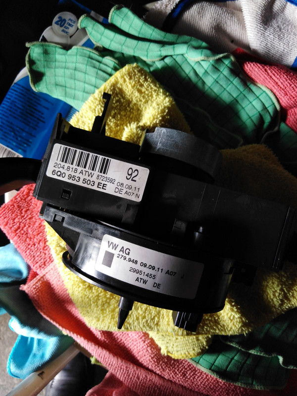

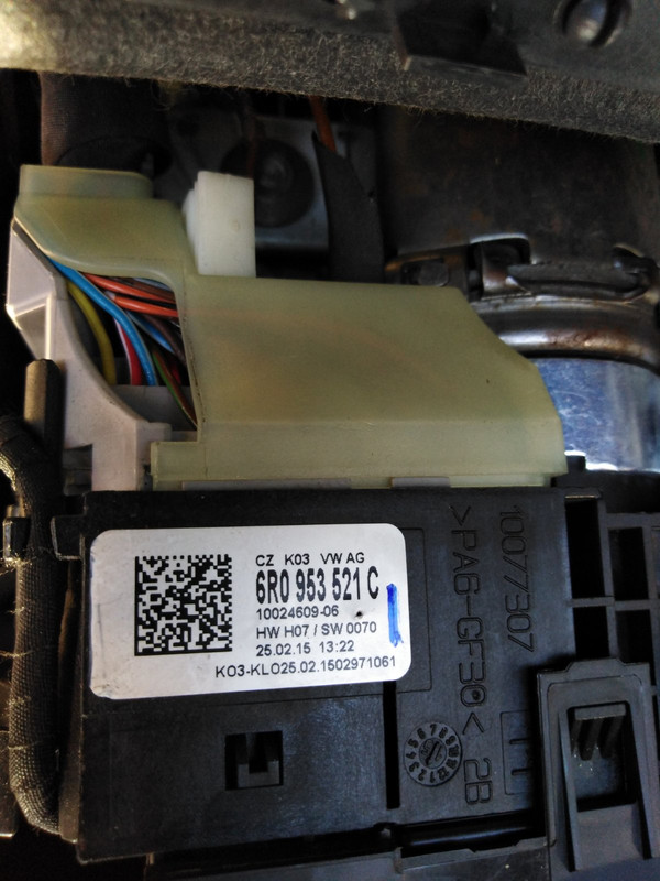

I think I have solved the mystery of the J745 unit, I'm not sure. According to my conclusions, it is not a problem with BCM or the J745 unit.
The mystery is here: (your SK FII VRS)
You currently have:
https://www.ebay.de/sch/i.html?_from=R4 ... 4&_sacat=0
You need:
https://www.ebay.de/sch/i.html?_from=R4 ... D&_sacat=0
These rings were also installed in the 6R according to the manufacturing dates.
In the Skoda Roomster the ring 6Q0959654D is used until the end of its production.(2015)
What is the problem here? The Stalks (levers) that are installed for one ring are not compatible with the other ring.
This is not a problem because for each set of levers of one ring there is an identical counterpart for the other ring.
Tell me the reference number of your current levers, maybe we will find a set of levers and ring at a good price.

Re: Skoda Fabia VRS 2012. Auto lights retrofit OEM
Post by exantas » Thu Oct 24, 2019 10:50 am
I believe that 6Q0953513AN is the number you're looking for. It's the stalks used with the 6Q slip rings I believe.
Alternativly 6Q0953513AL, but this part doesn't have the trips button for the maxi dot. In case Vasileios have MFSW buttons
Sent from my MI 5 using Tapatalk
Yes, but we will allow Vasilis to reply so that we are 100% sure of that.
In the last autoscan posted by Vasilis:
Subsystem 4 - Part No SW: 3T0 959 537 E HW: 3T0 959 537 E
Component: E221__MFL-URO H07 0012
Serial number: 2164426
Coding: 810000
VASILEIOS1972
Posts: 180
Joined: Tue Feb 12, 2019 2:53 pm
Drives: Polo 6R 1.2 tsi , Skoda Fabia 5J Vrs 1.4
Location: Greece
Post by VASILEIOS1972 » Thu Oct 24, 2019 3:09 pm
Hello my friends Fernando and Theodore .
Thank you for the help that you giving me .
I am posting above three photos with stalks .
One with oem no cc stalk from factory and two with retrofitted cc stalk , photos above
cc retrofit in my fabia
no cc stalk from factory in my fabia , before cc installation
best regards
Vasilis
