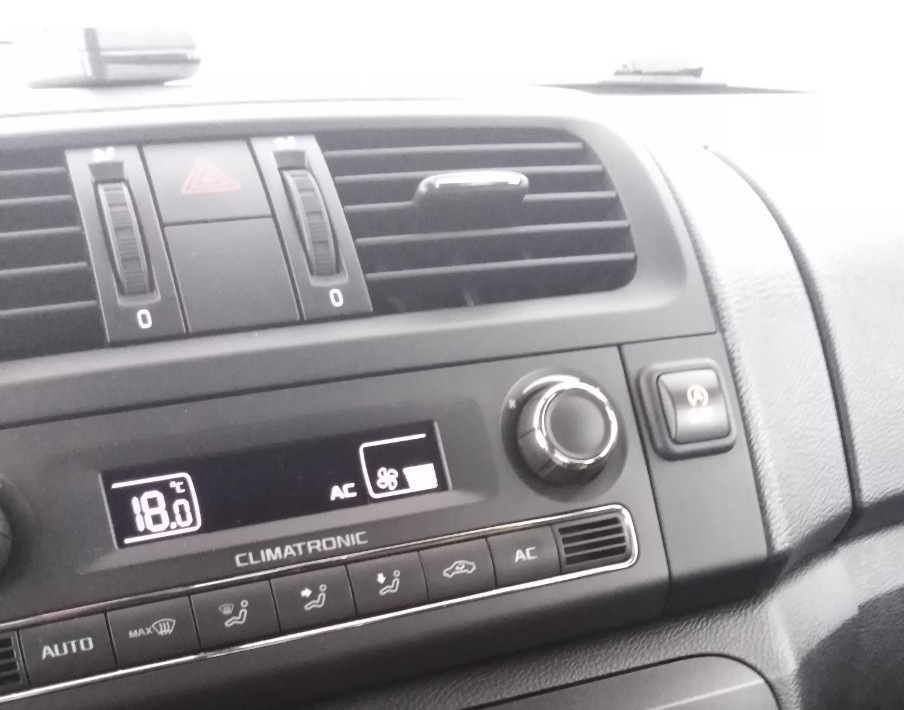

Also can you share a picture of where you placed the parking sensor disable button?

For disable button I used start stop button from Fabia and the location showed above
