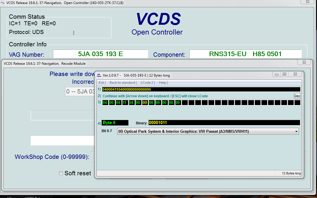

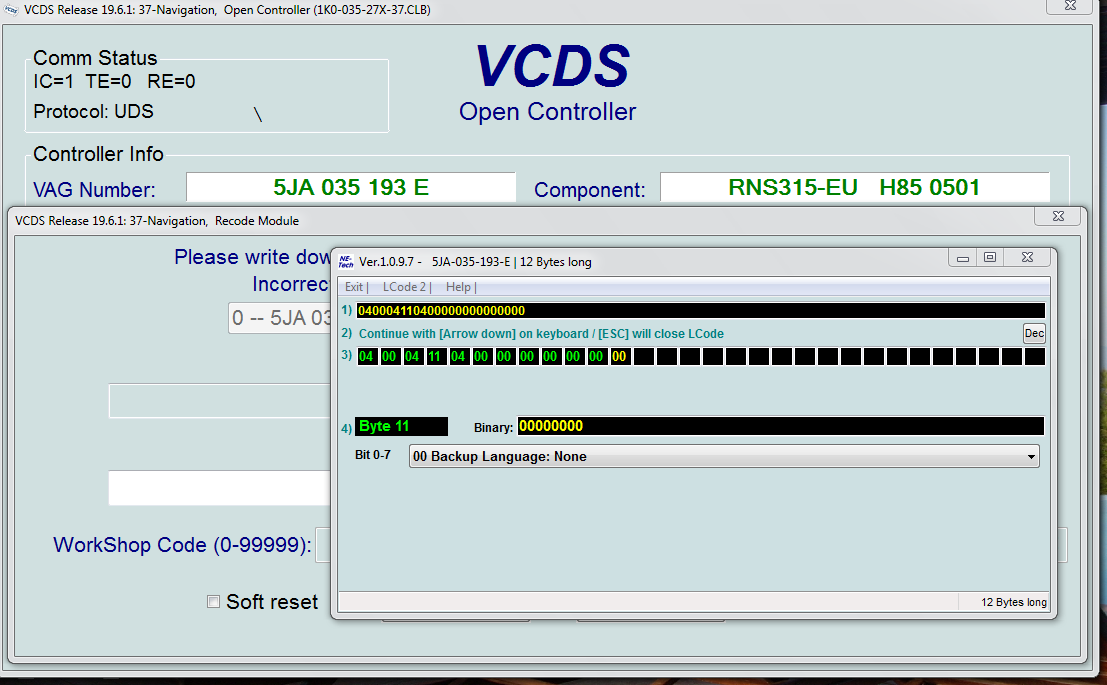

Hello Fernando again, i have insert the coding but nothing happens for another time . I am sending you some screenshots if you can figure out .

Ok, I see that RNS315 has a different way of being coded than RNS510. Thanks for the images.
Sorry for my big mistake. :oops:
