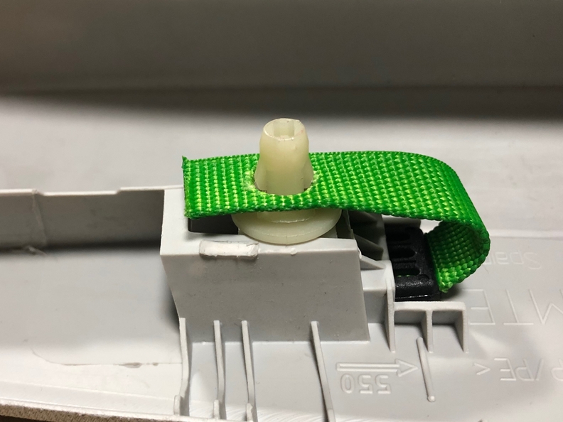

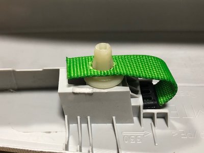

Having a hard time trying to remove the A pillar trim on my 9N3. Basically, I need to remove old TV antennas, install a DVR, route an ETC and GPS antenna. I broke the airbag clip/cover when I was trying to remove the topmost clip.
The topmost clip is the most difficult to remove. I am using trim removal tools but it still won't come off. Any tips or tricks from those who have done this before? Thank you.

I have finally removed both A pillar trims but this has cost me a broken airbag clip/cover and the top clip broken. The technique is to use a trim removal tool. Insert it all the way, until the tool squeezes the plastic clip/peg then use tool as a lever to pull the peg out of the pillar. Now I have to start looking for replacement parts.
