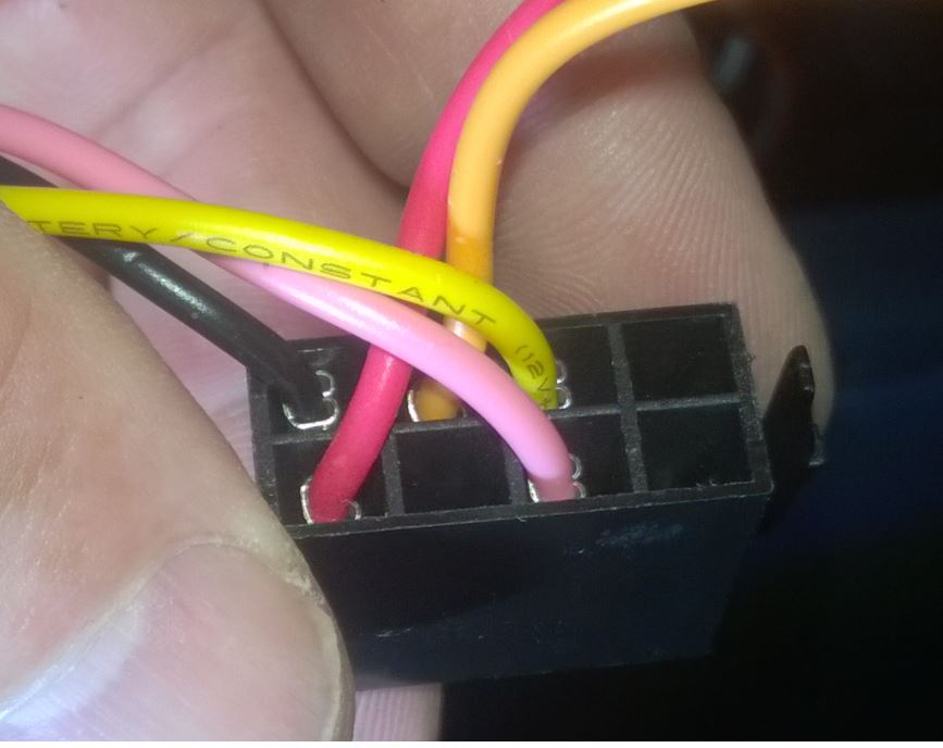

Radio is up and running and BT works correctly for both calls and audio. However I got what i think is a CANbus emulator with the unit and am currently using it. The only issue i have now is the illumination. I have got the light connection at the ciggy lighter, but where does it connect to in the radio harness. I have tried tracing with a meter, but have not had any success.

Found this pic of the ISO plug from when I was changing the stereo the orange was the illumination

Thanks for the reply. eventually found time to get back on to this. However mine doesnt have any orange wires.
