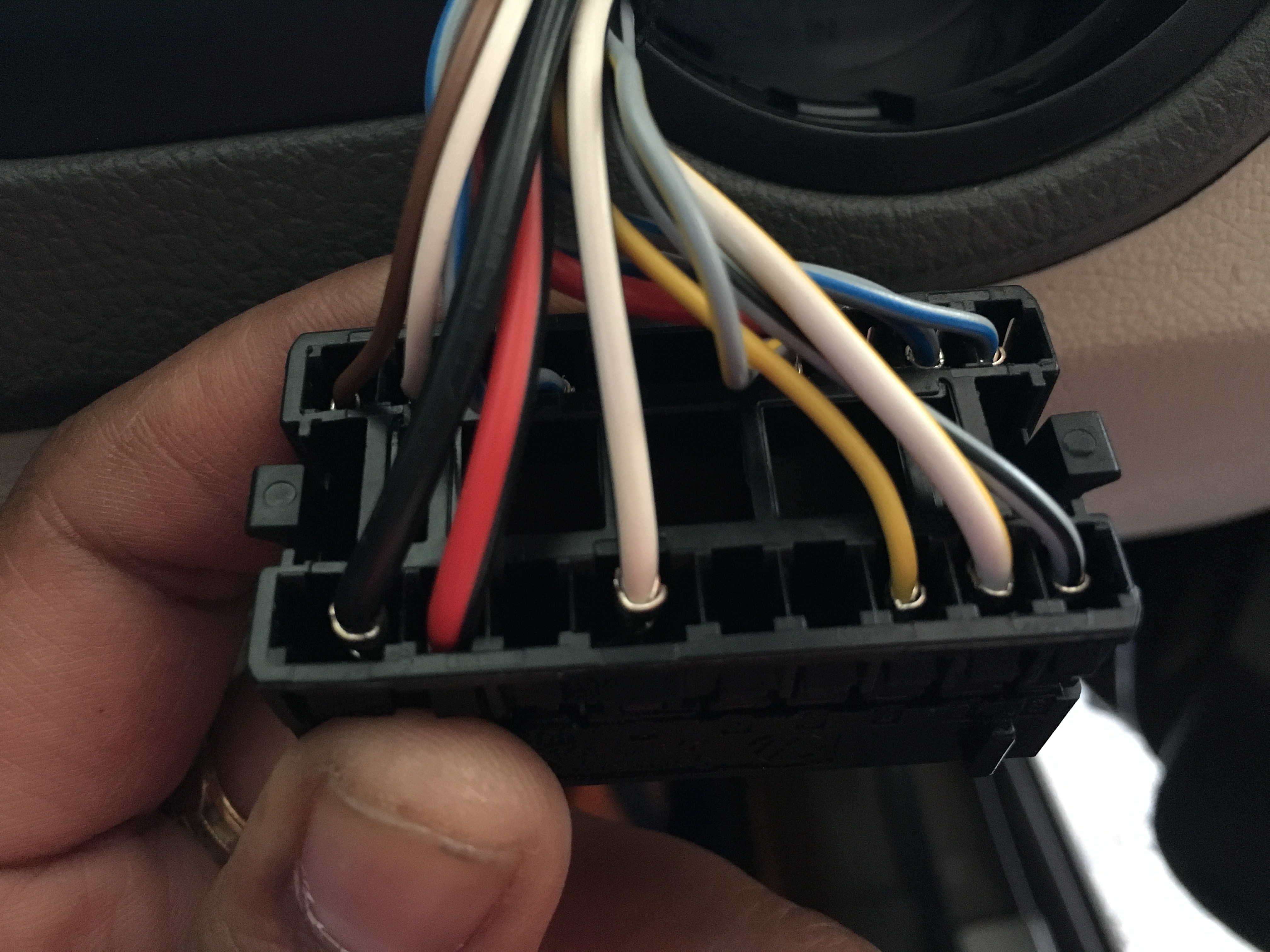

Pictures from; (see the installation guide for reference)
Relay carrier. :?:
Light Switch connector. (colors of wires, both sides) :?:

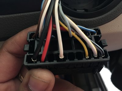

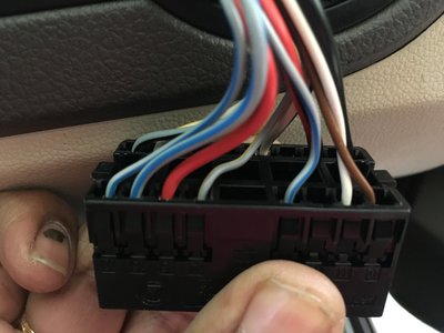

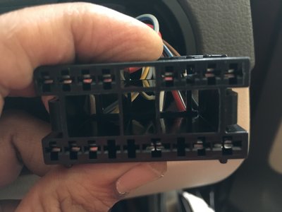

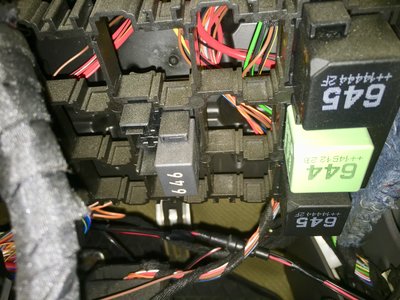

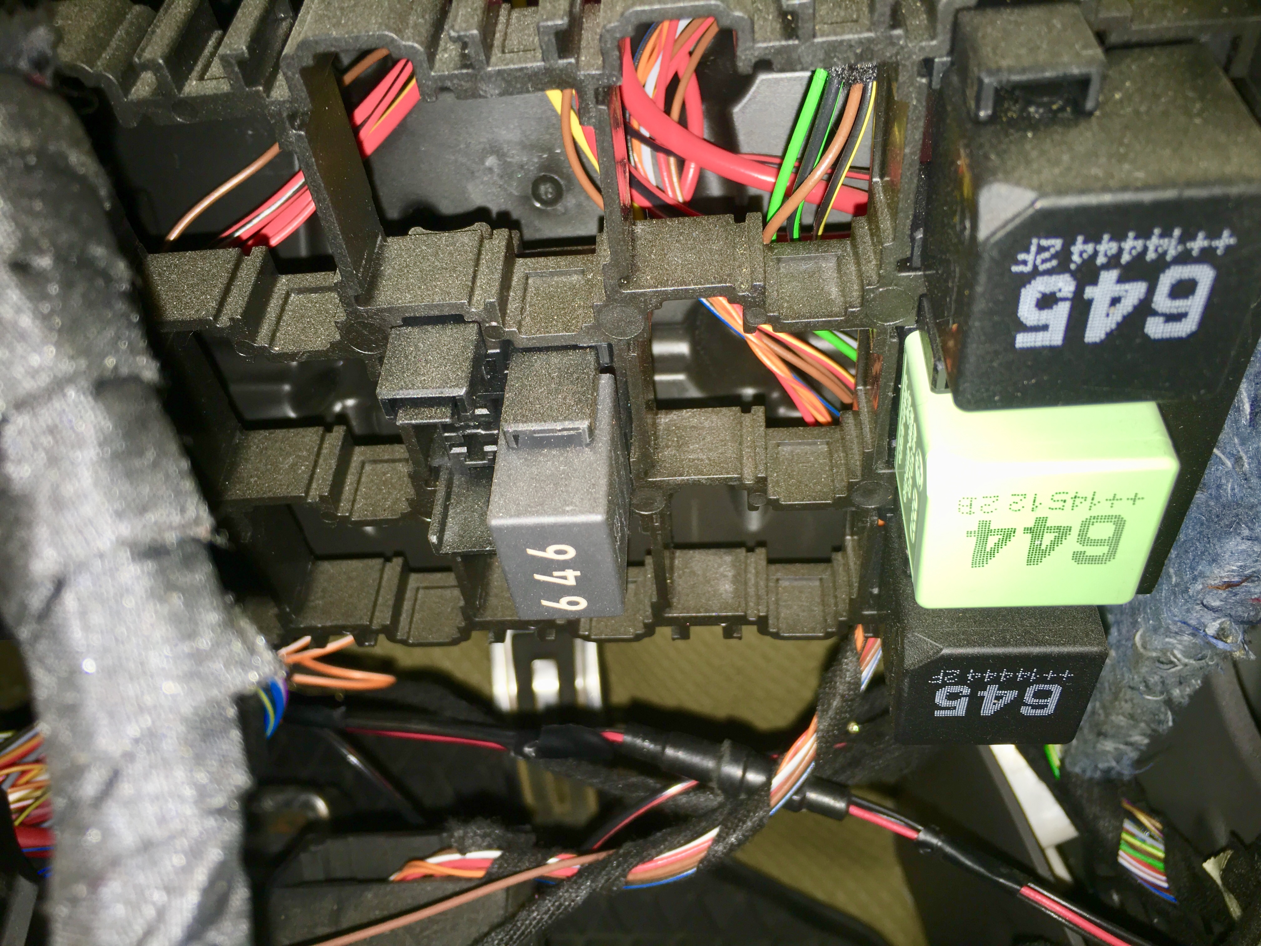

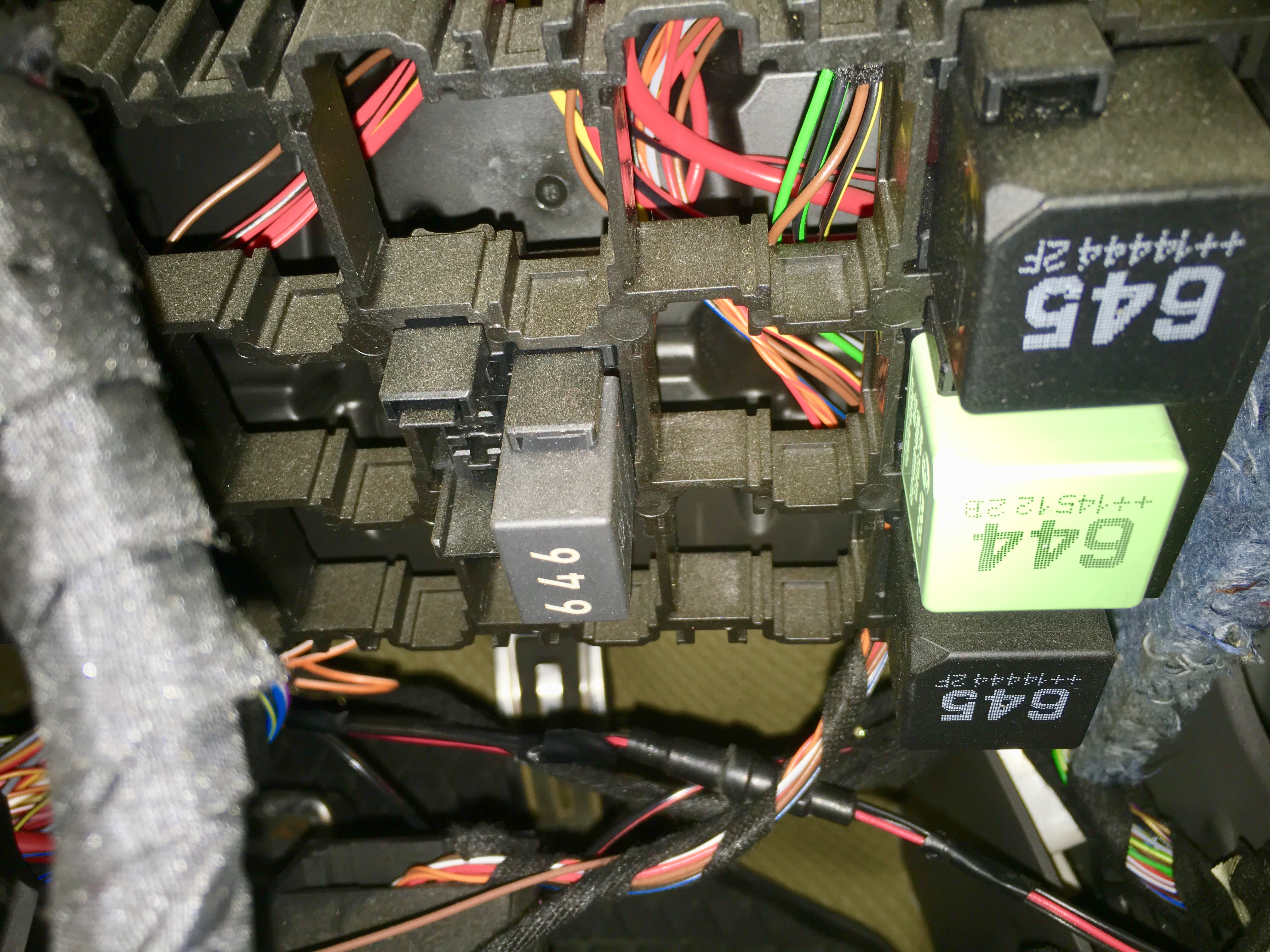

1. Relay carrier.
Relay Carrier
Relay Carrier

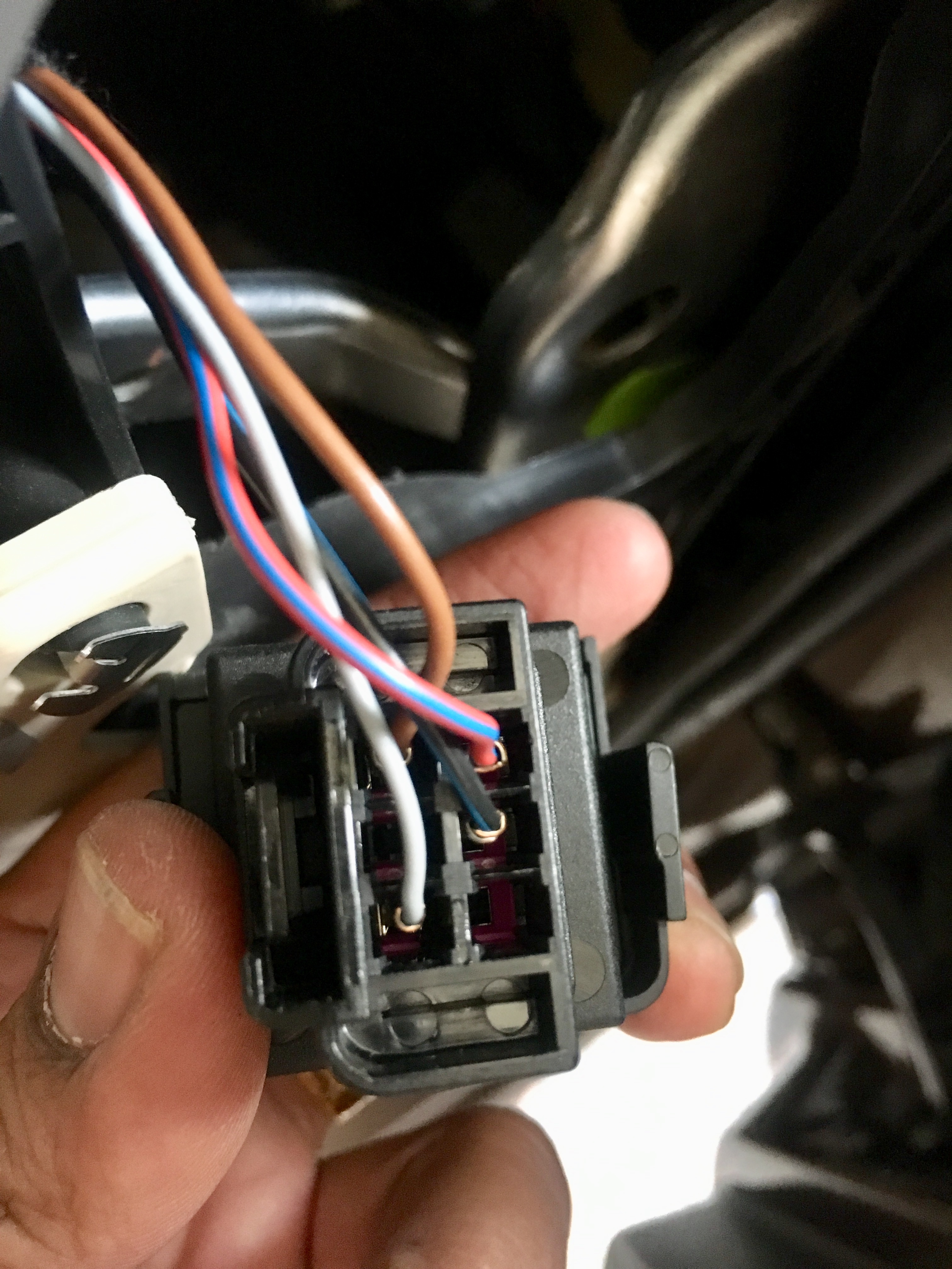

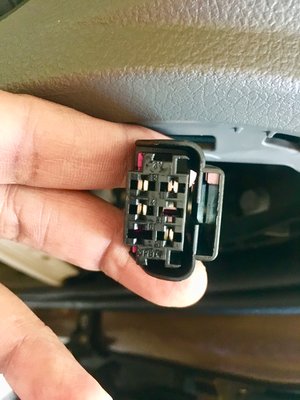

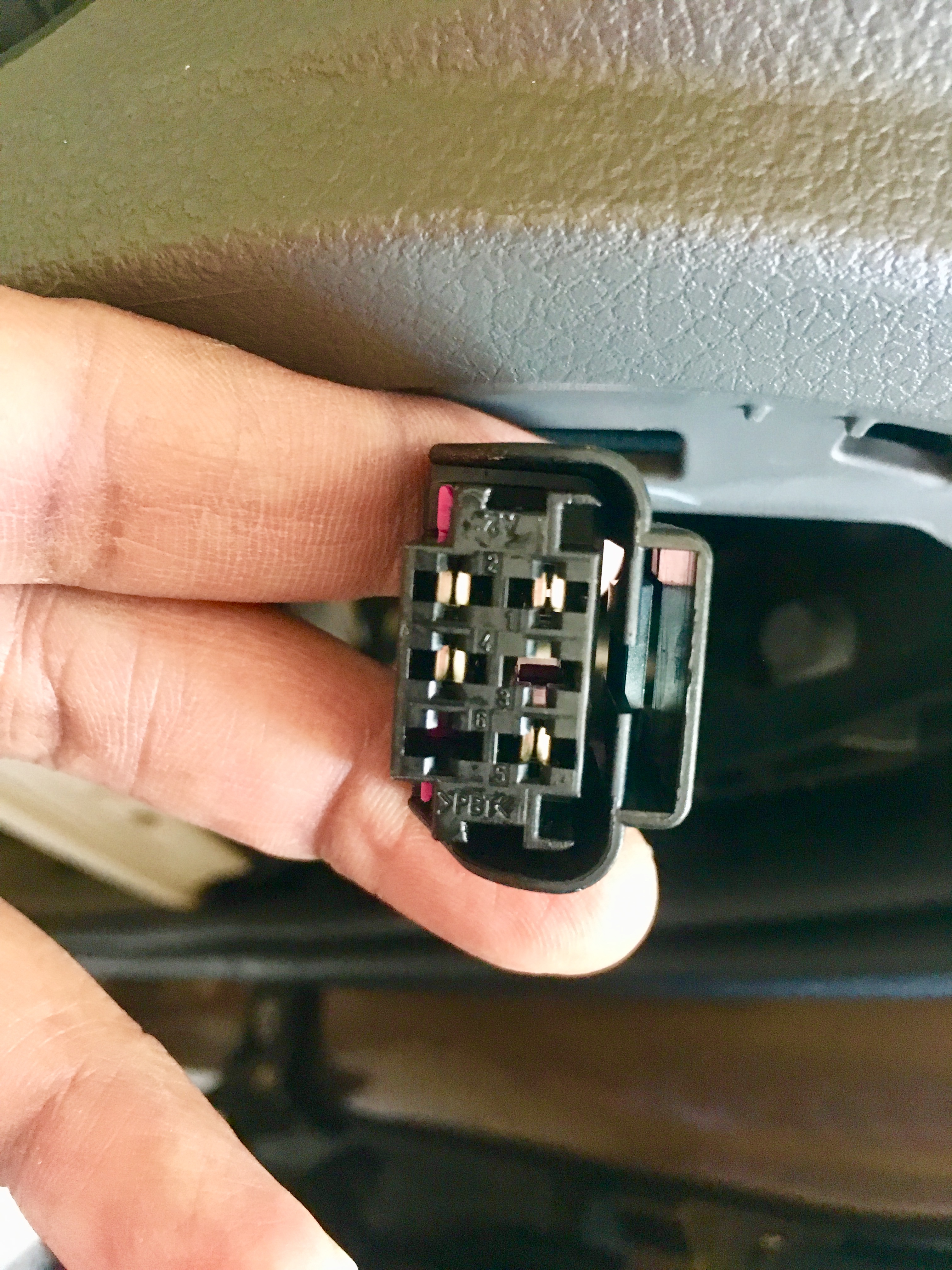

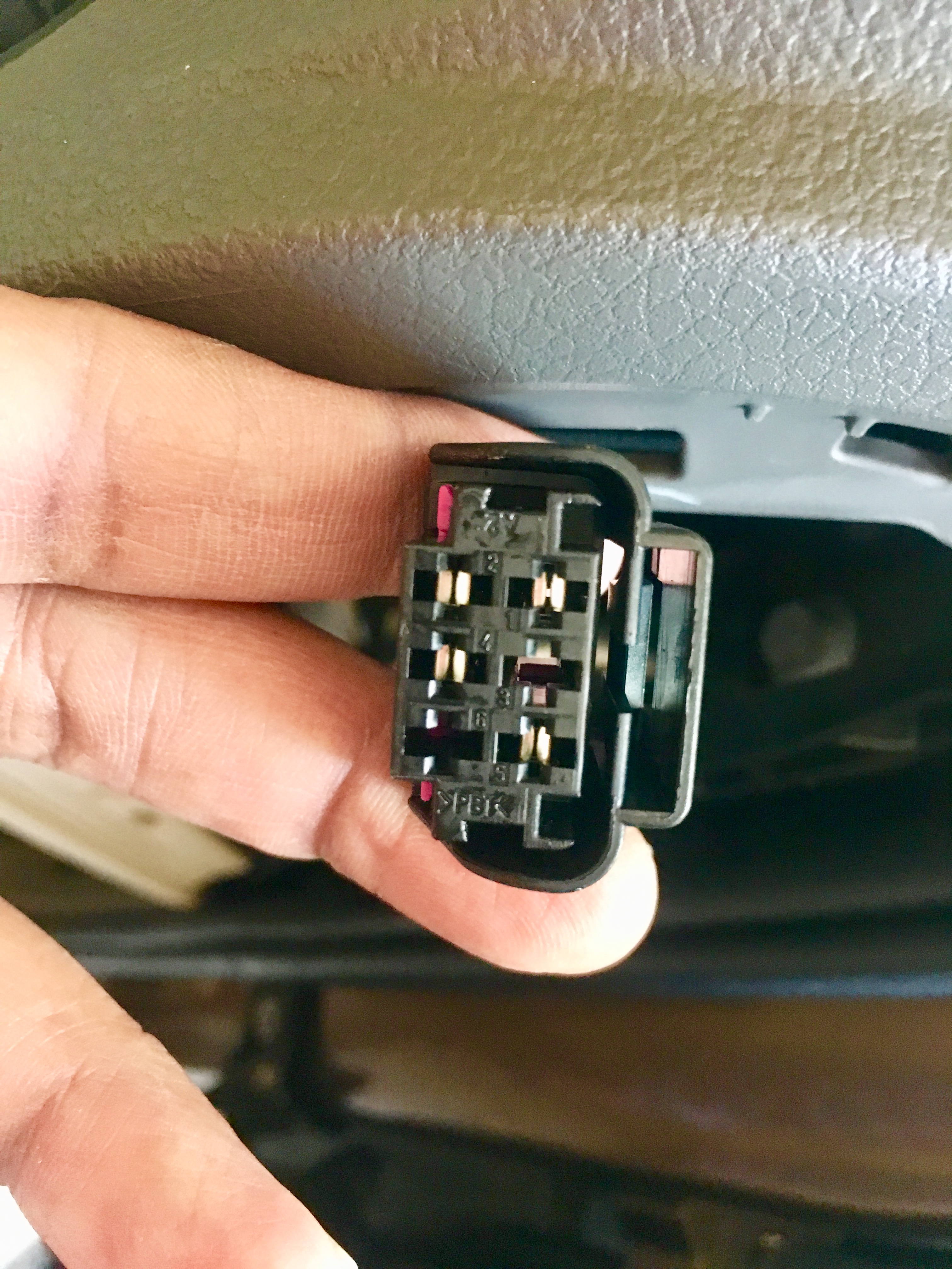

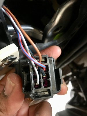

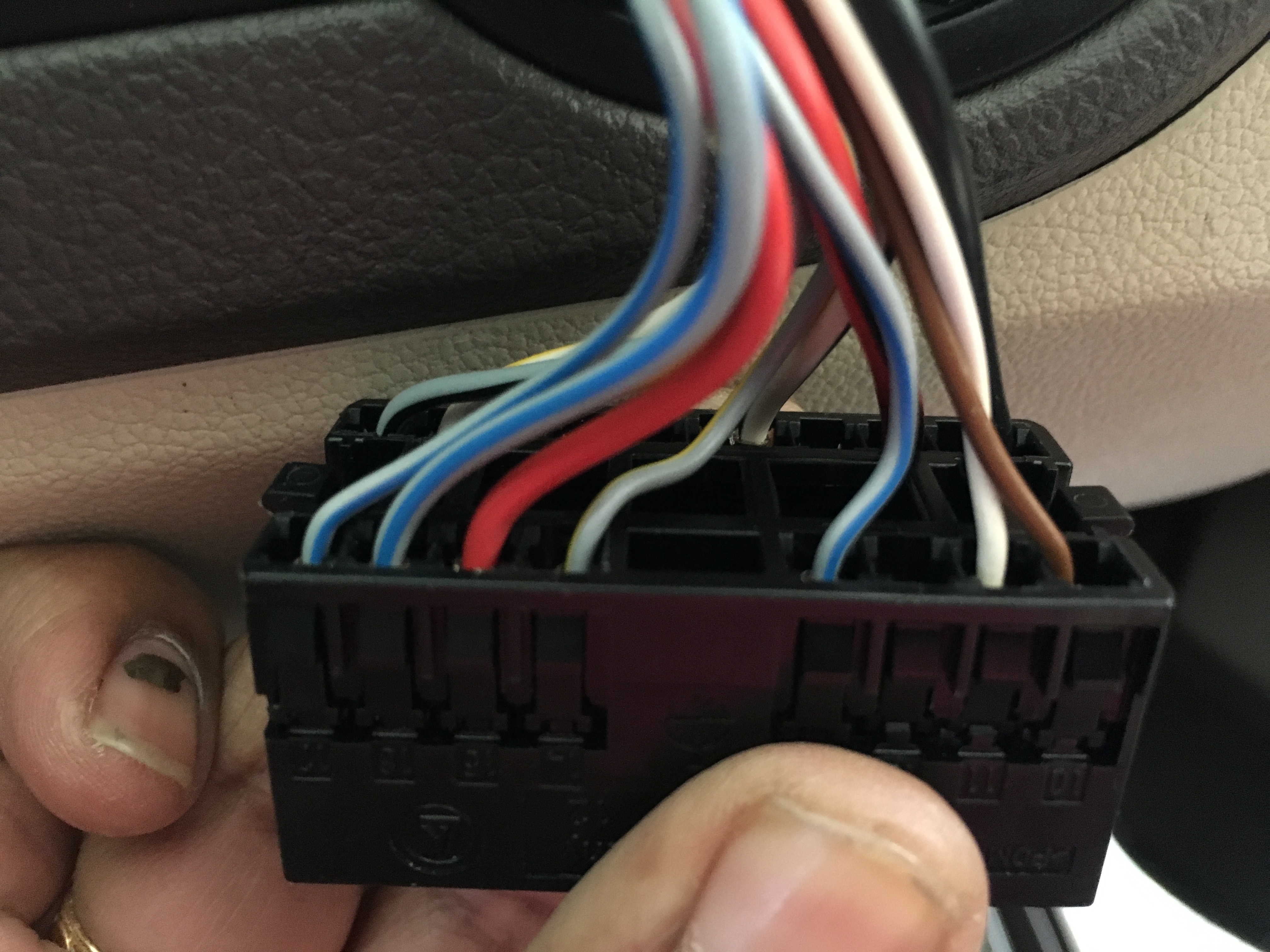

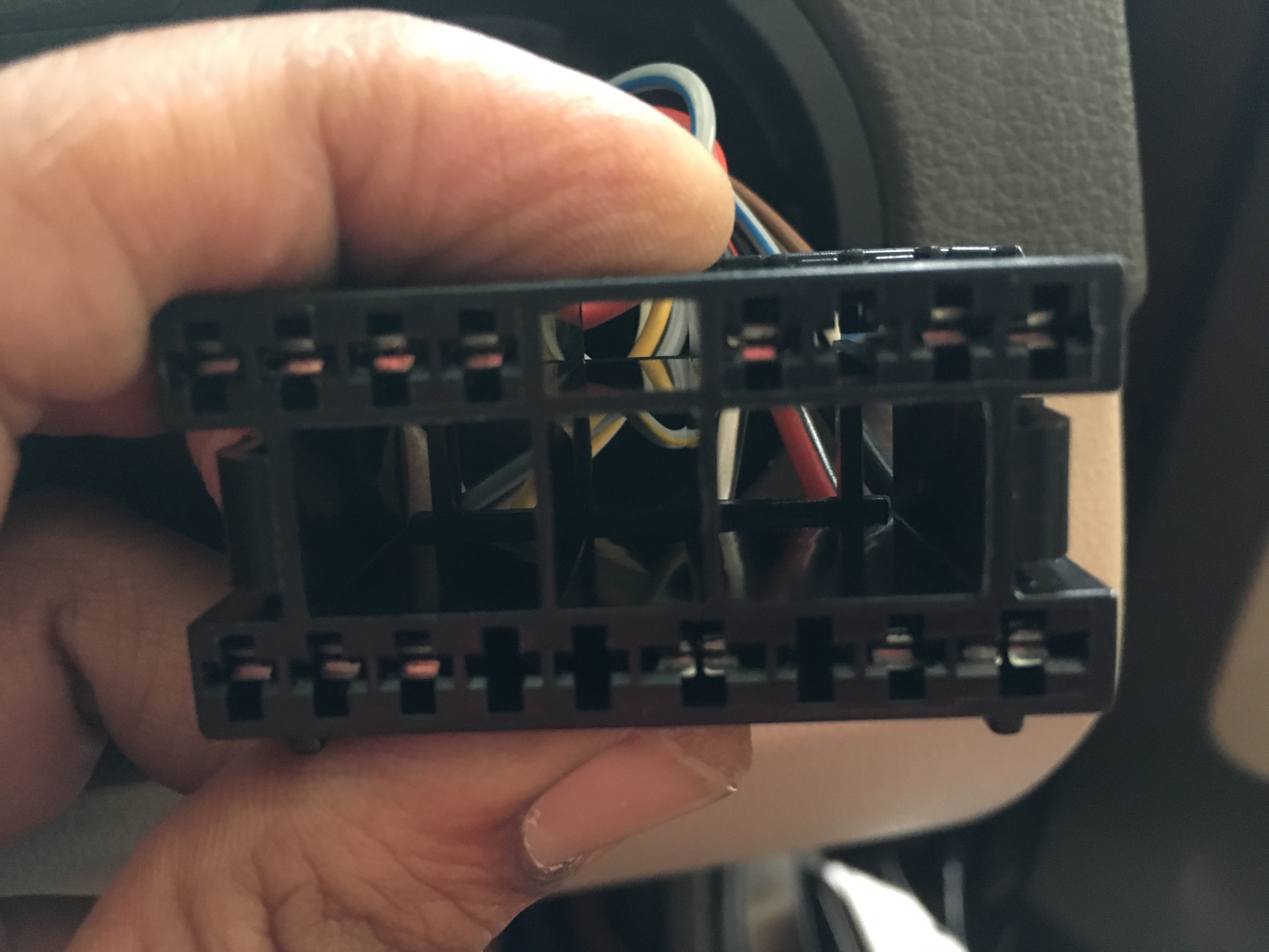

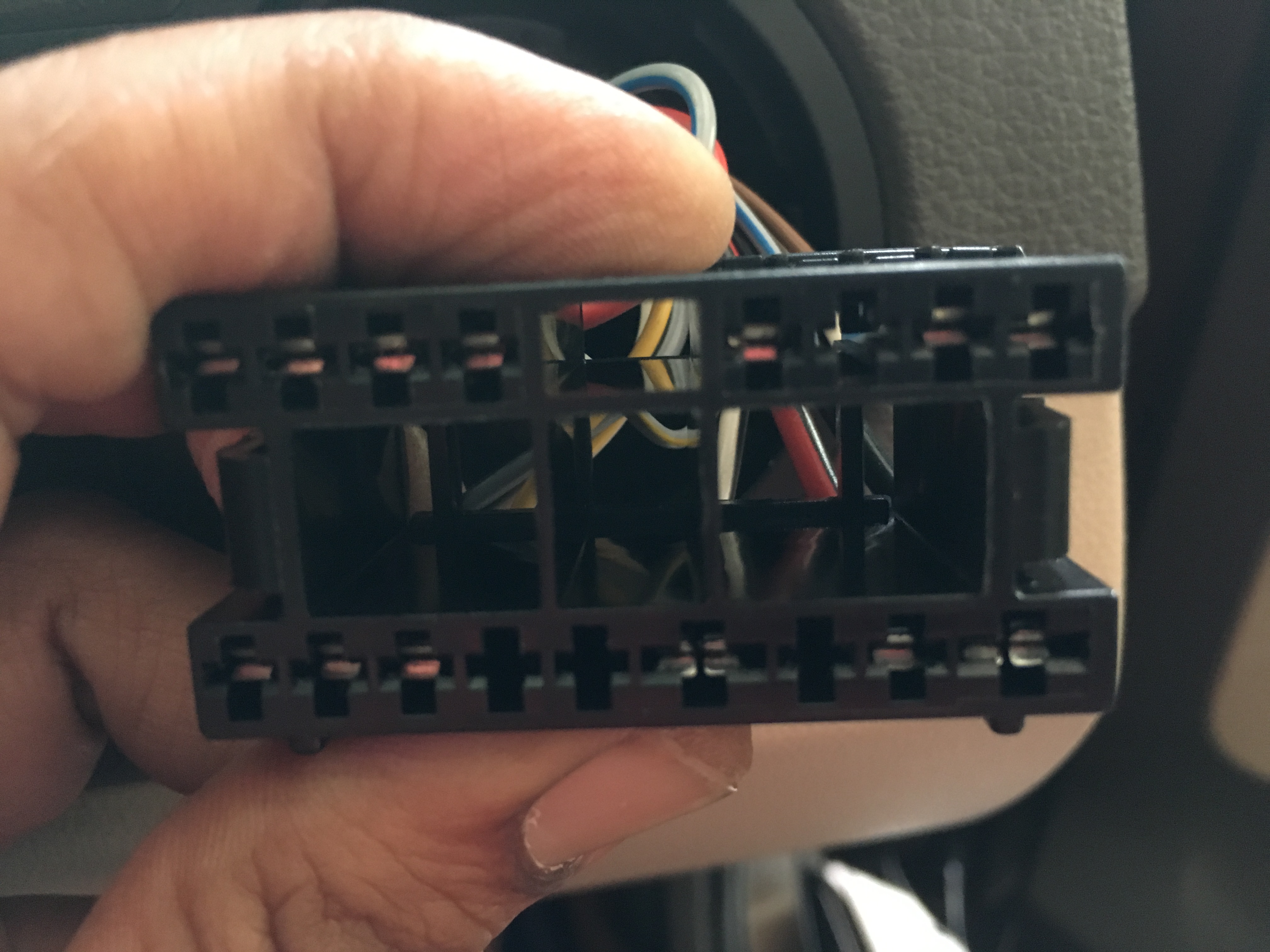

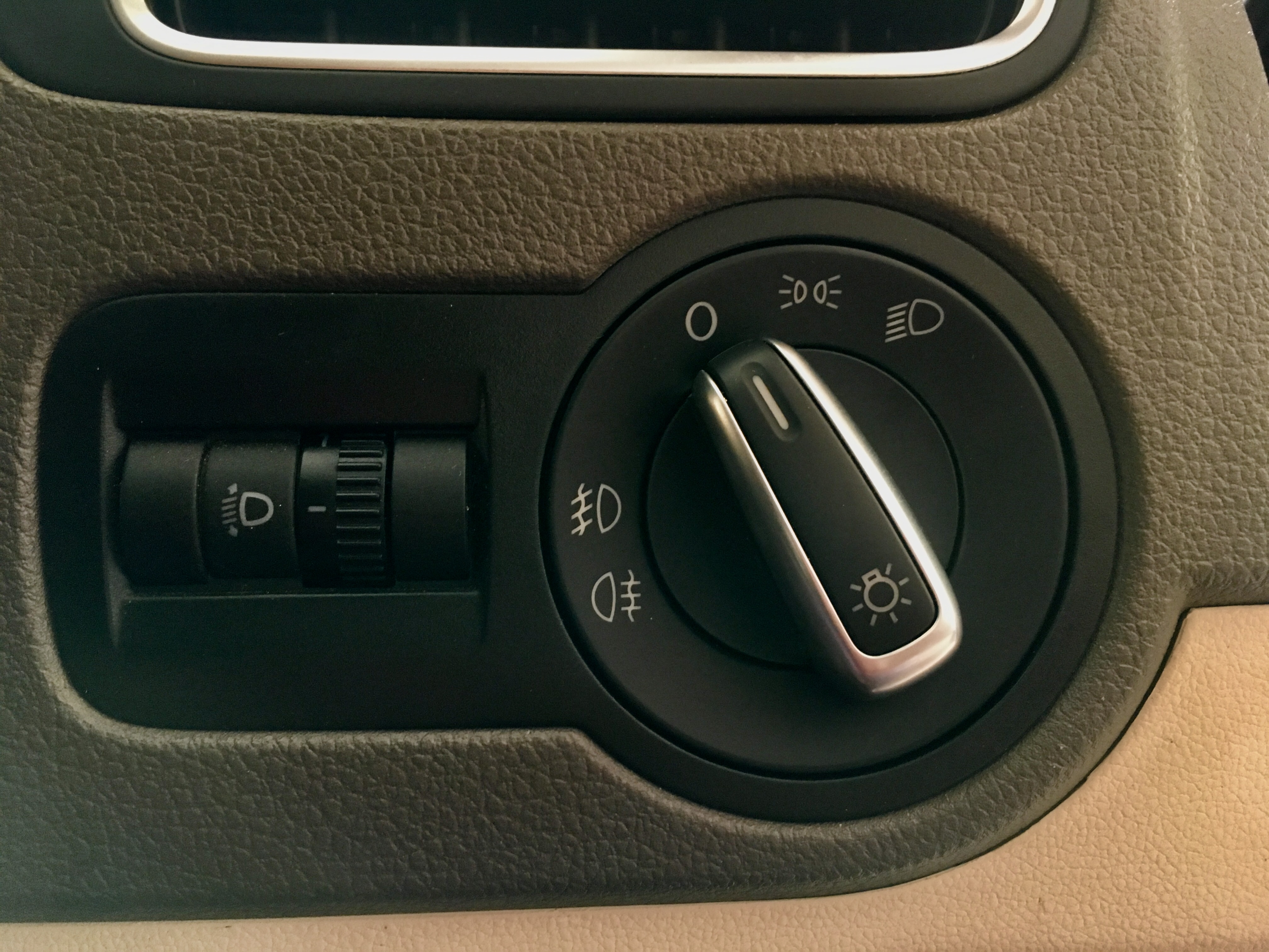

2. Light Switch connector. (colors of wires, both sides)
Light Connector 1
Light Connector 1
Light Connector 2
Light Connector 2
Light Connector 3
Light Connector 3

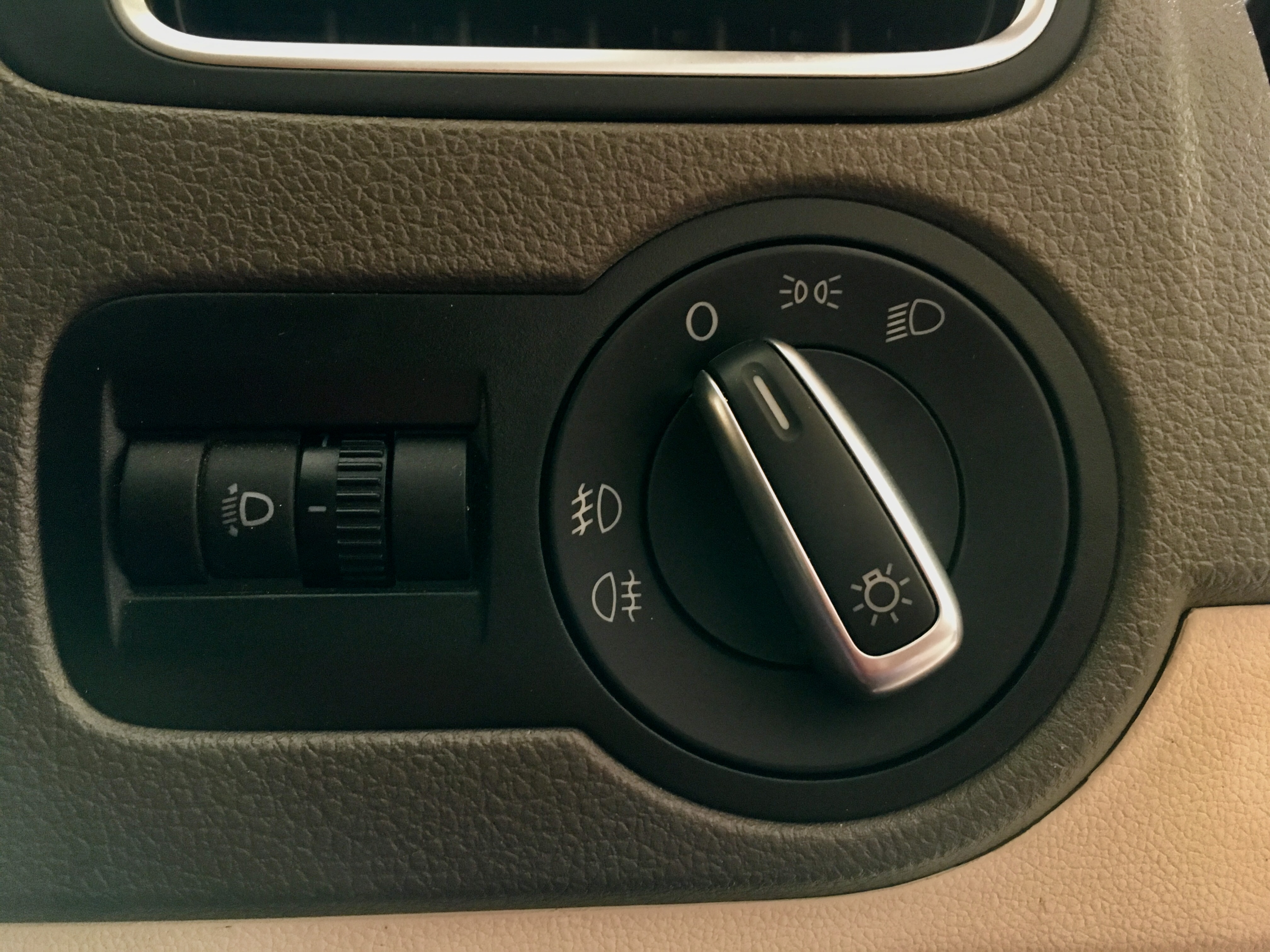

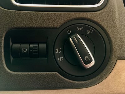

3. Current headlight and dimmer switch
Light Switch
Light Switch

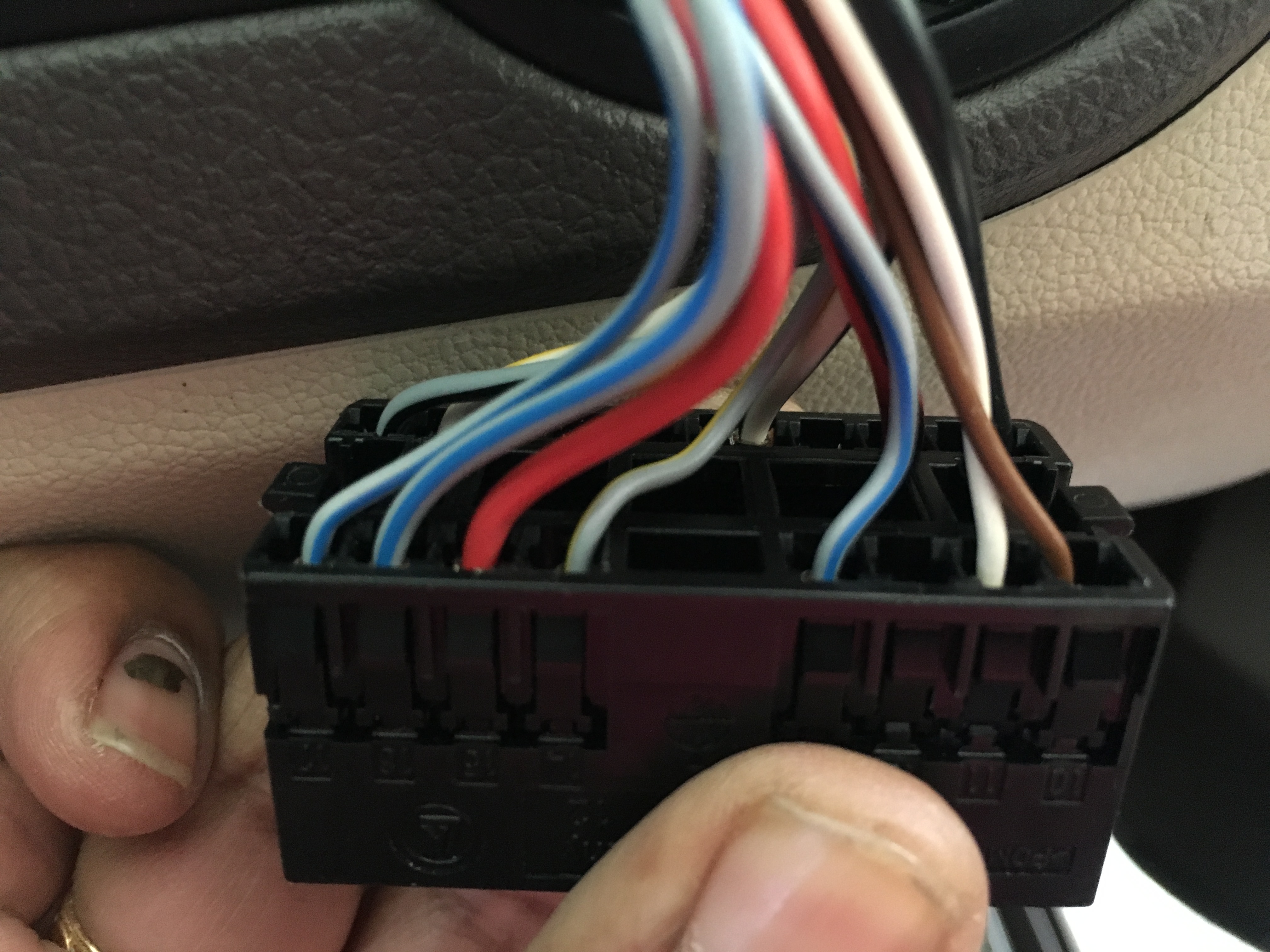

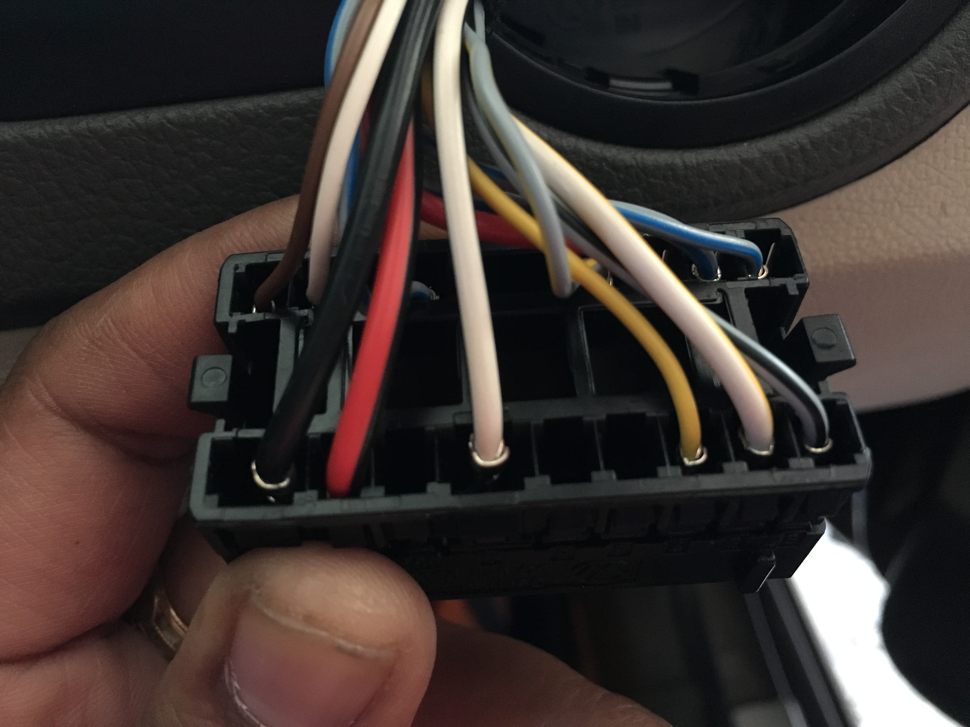

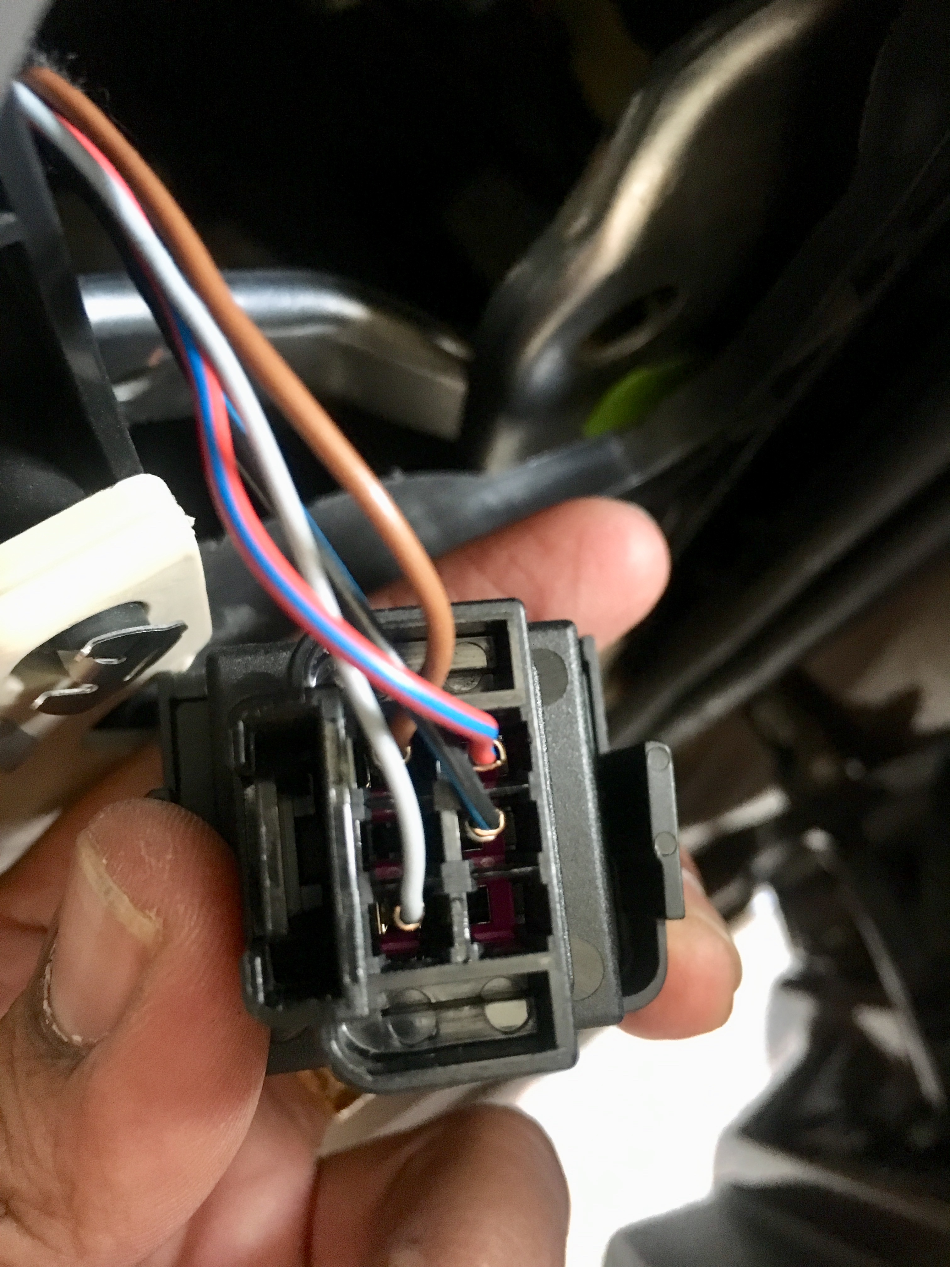

4. Dimmer connector.
Dimmer connector
Dimmer connector
Dimmer connector
Dimmer connector

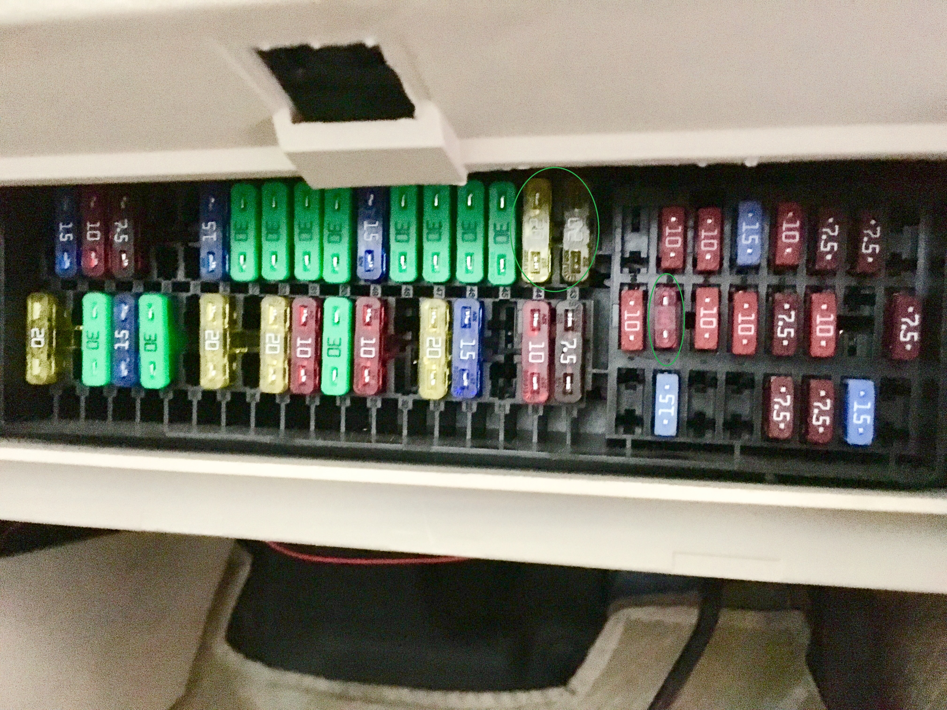

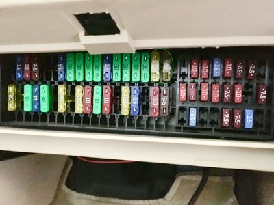

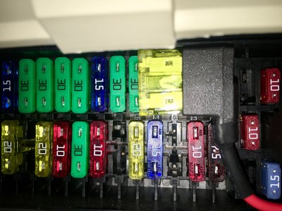

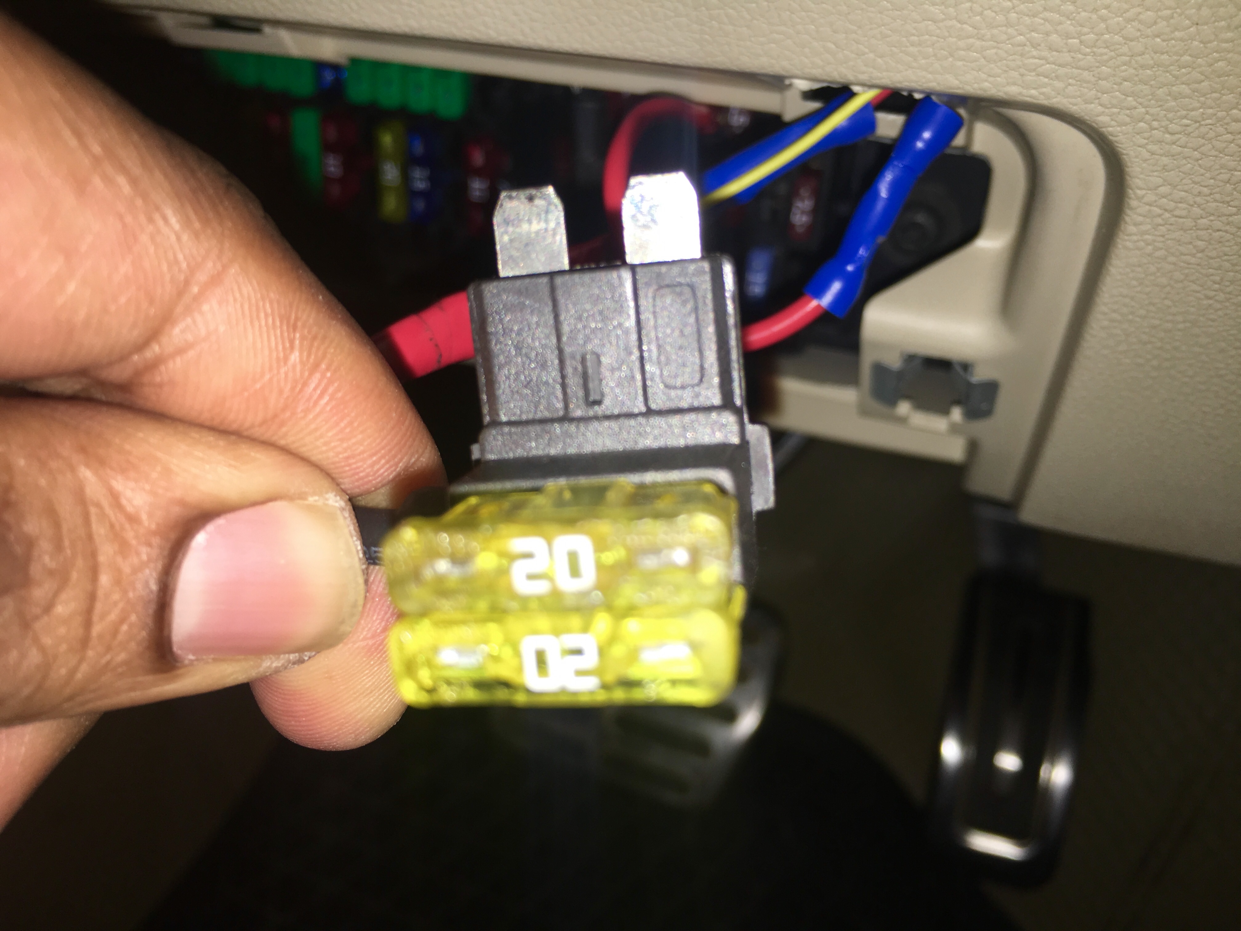

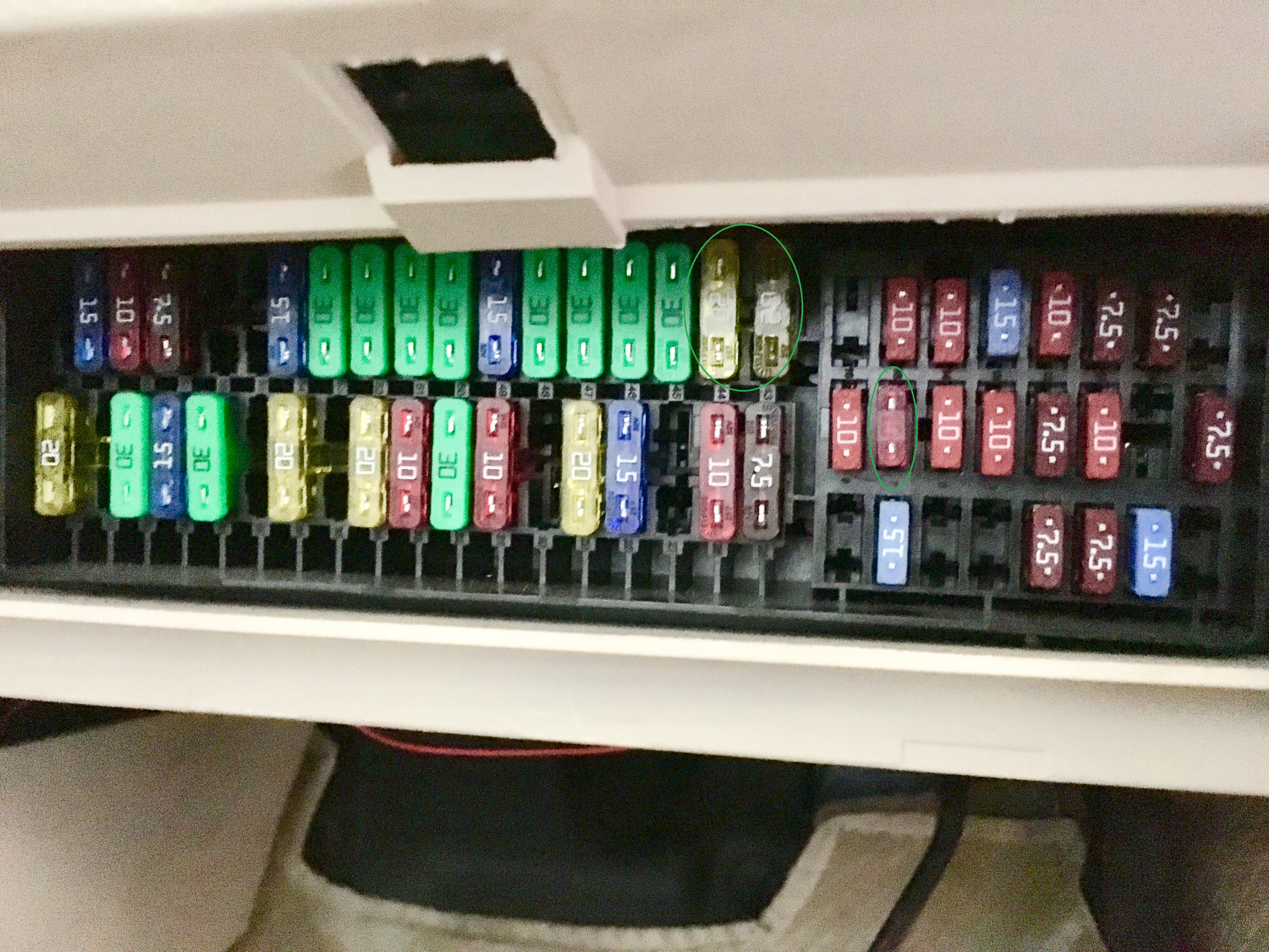

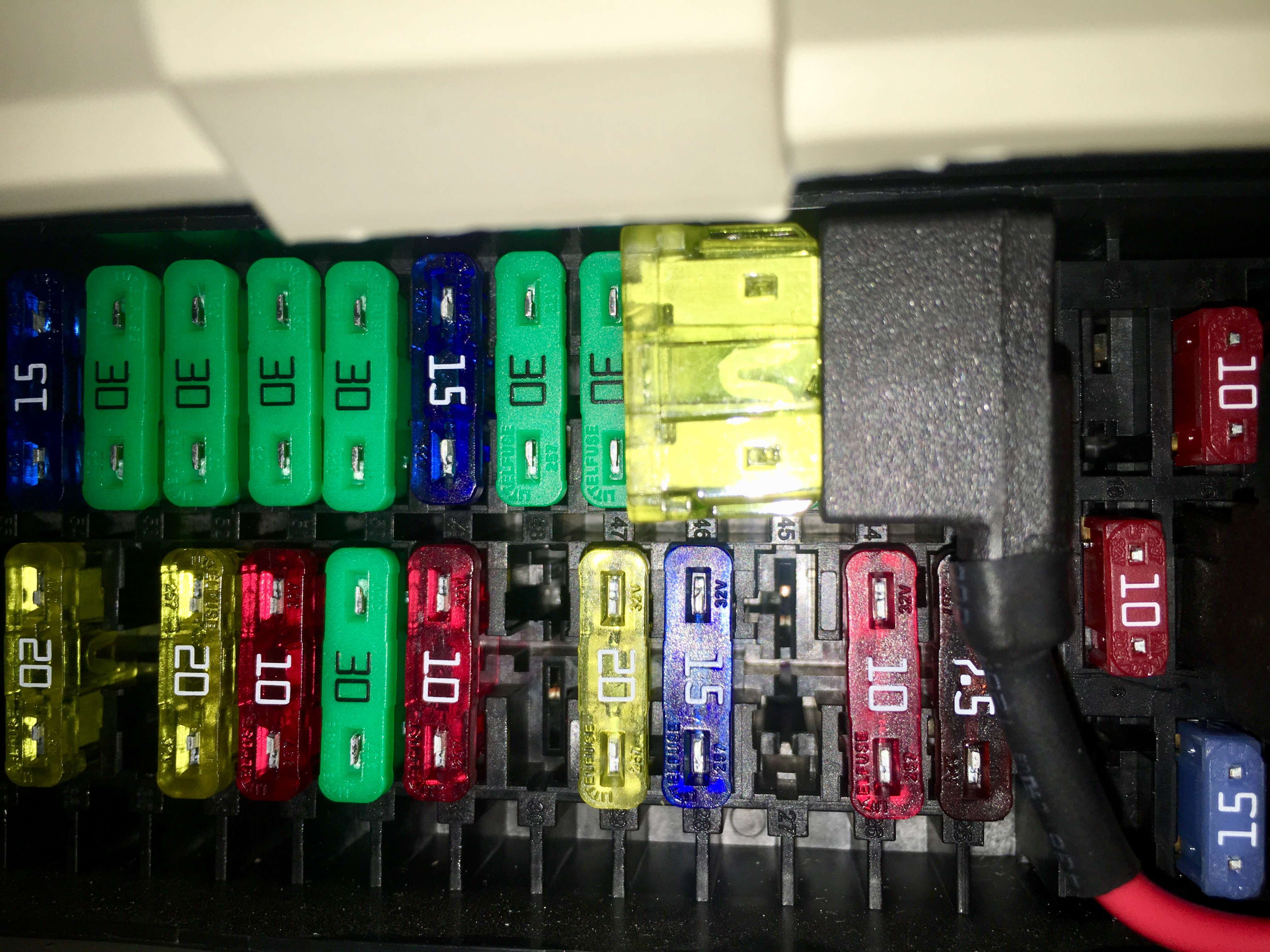

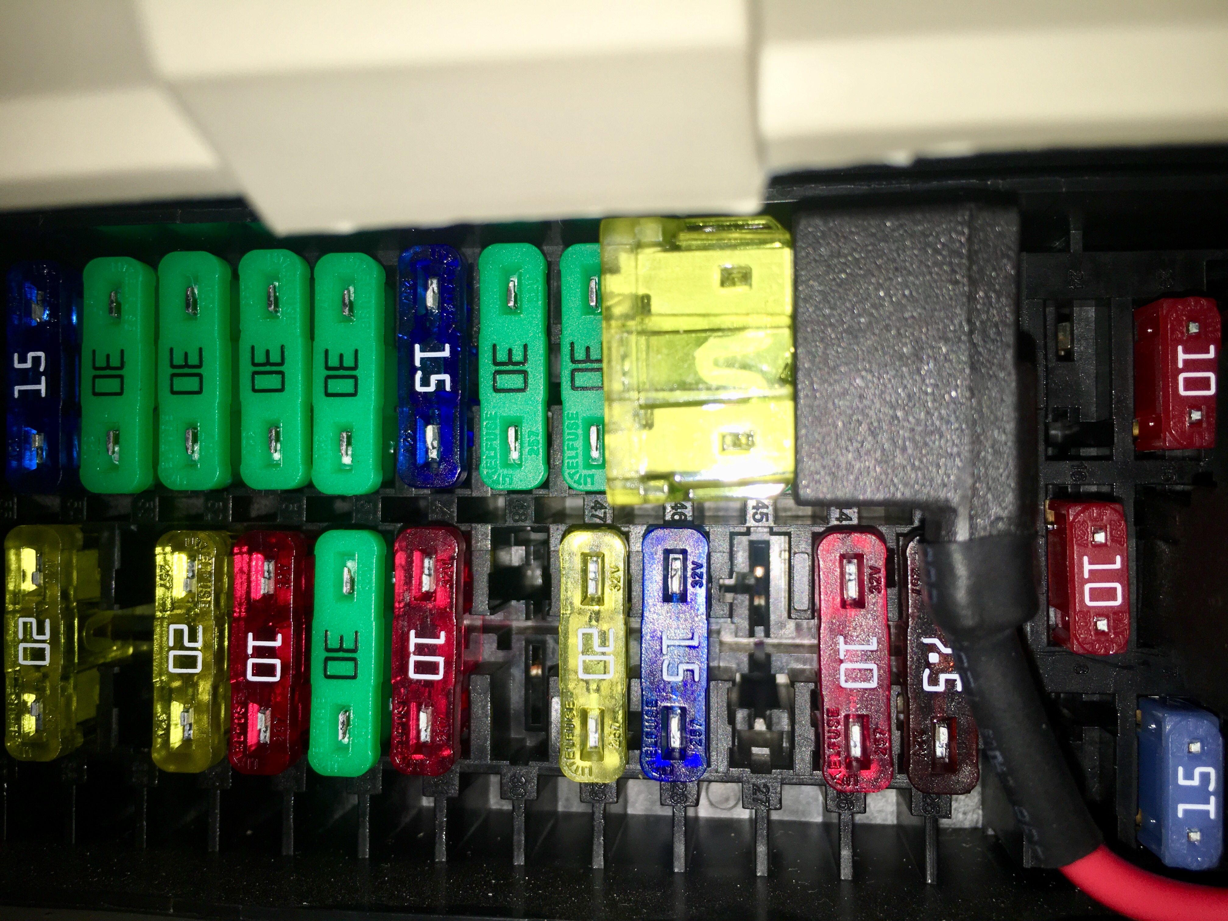

4. Fuse box.
Fuse
Fuse
Please note I've highlighted two fuses which are actually retrofitted via fuse plug. The two green ones are for dash cam and the single red one is for existing Gentex auto dimming mirror.

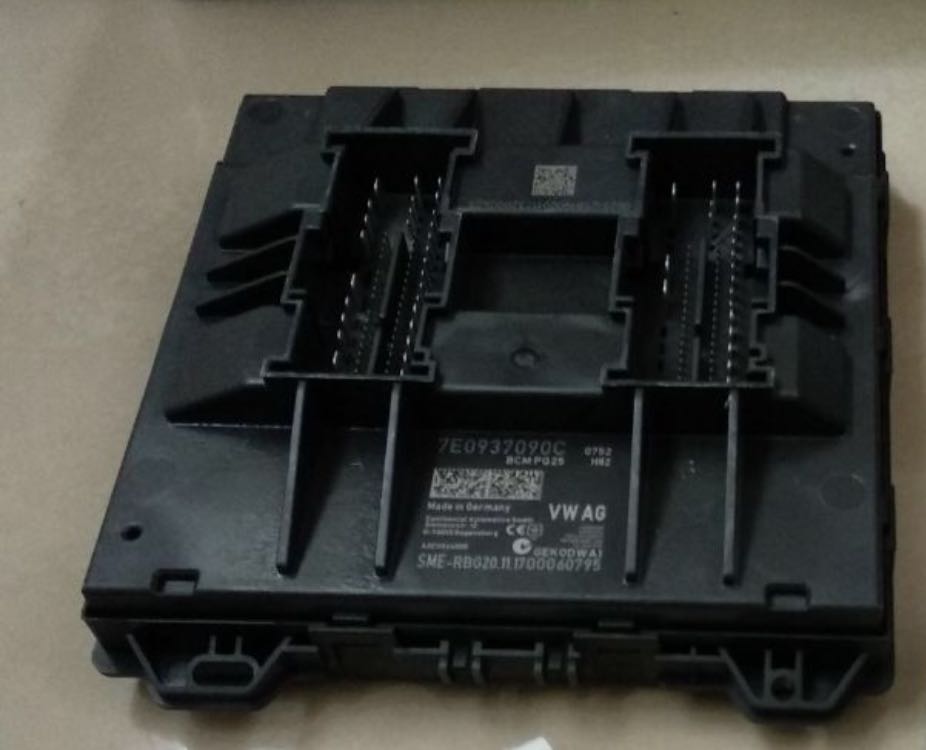

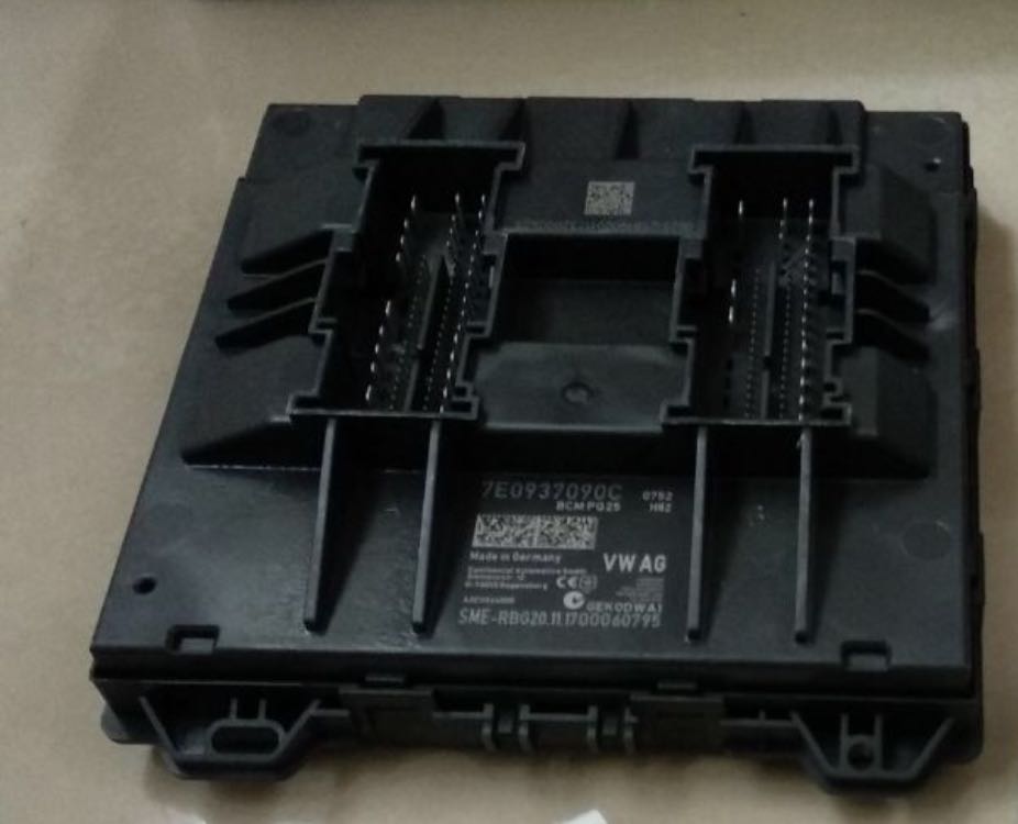

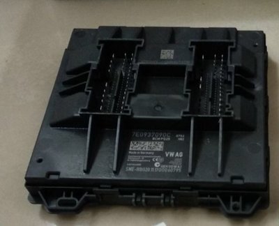

5. New BCM.
BCM Max
BCM Max

1. Auto dimming mirror - 3G0.857.511.AC 9B9
2. Rain and light sensor - 5K7.955.559.C
3. Light switch with auto mode - 3С8941431А
And yes, I'll also go for the dimmer 6Q0941334 you have suggested.

Very good pictures 8) , thank you very much!
- Dimmer ordered to my VW dealer. It will take 7 to 10 days to get from Germany to Spain.
- In the meantime I will manufacture your wiring looms and inform you of the process here.
It is not clear to me if you want the wiring for Auto dimming mirror and RLS.
:arrow: https://uk-polos.net/viewtopic.php?f=56 ... 60#p524696
Can you please explain to me why you need to use two fuses for the dash cam (43,44)?
Or is it just fuse 44?
It will be necessary to reassign the power/feed of the dash cam in another slot, we need the slot 44 for a better installation. No problem for this, I'll tell you how to do it, it's very easy.

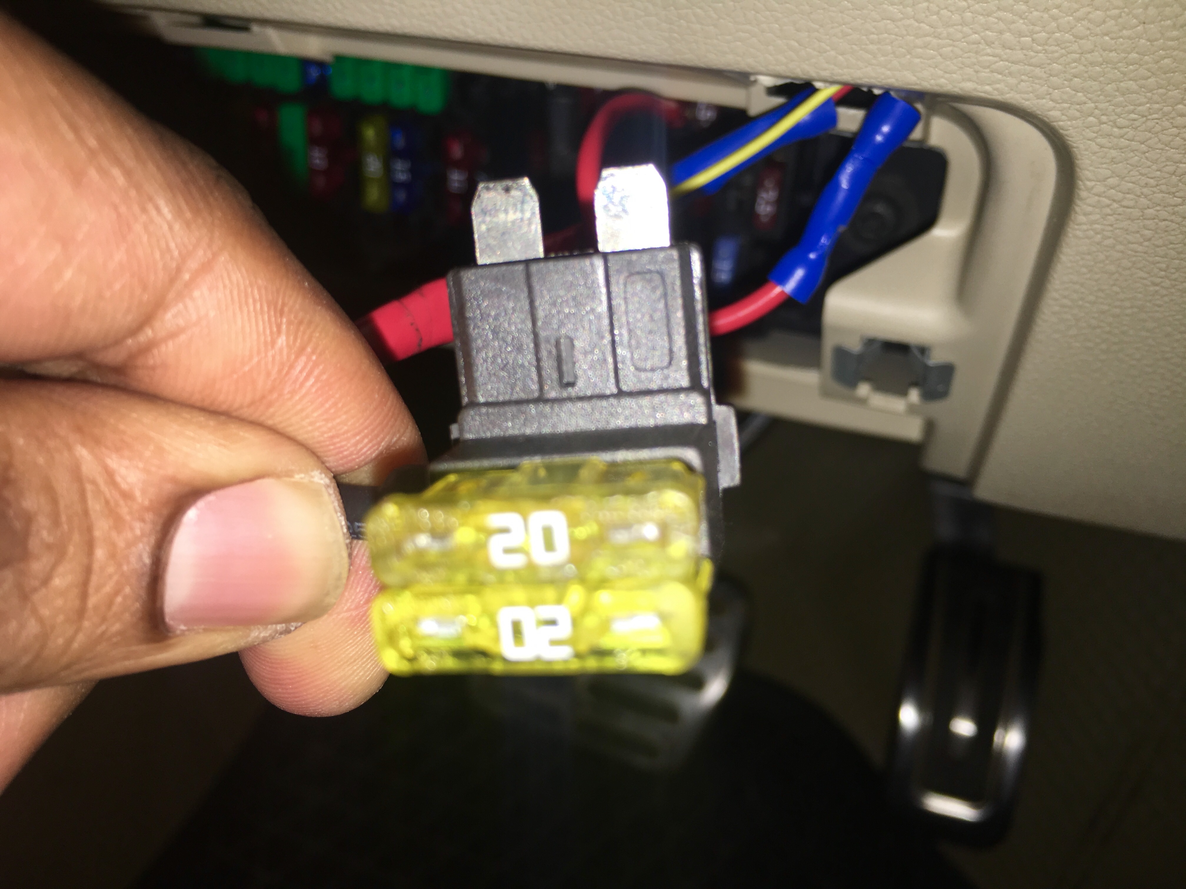

Regarding the dashcam, the 2 fuses are slotted into 43 via a single fuse tap (done by the dash cam installer). I removed fuse tap and connected fuses directly to 43,44 for sending the picture to you. Apologies if it had caused any confusion.
Thanks and Regards,
-Sree.
Posts: 8992
Re: BCM max, RLS, Bixenon adaptation for my 6R Sedan
OK.
To prevent confusions, can you draw in the next image how the feed of the Dash Cam is connected?

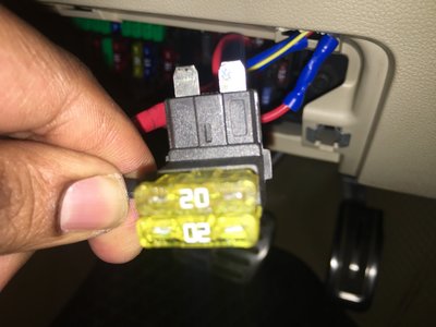

HI Ciclo,
Attaching a couple of pictures to help understand.
1. The wire from dashcom is connected to the fuse box using this fuse tap
2. The fuse tap on the fuse box in slot 43. 44 is empty but covered by the fuse tap. I removed the fuses and connected them to the main fuse box in earlier picture. Apologies if it had caused any confusion.

Hi, thank you for your explanations. All is clear now.
It's a horrible way (pardon for my words :lol:) to connect Dash Cam feed in the fusebox. Hides other fuses.
I will provide you with a clearer and easier way (with an image to install it). :wink:

sreeramkumars wrote: Thu May 31, 2018 9:28 am If the kit can be delivered on or before 20th June, I'll take it in UK..Any later will have to be shipped to India. We can decide this few days later.
Ok, hope we have luck. :wink:
100%
:arrow: https://i62.servimg.com/u/f62/18/94/39/39/133.jpg
Installation guide :arrow: https://drive.google.com/file/d/0B2nv91 ... sp=sharing
:arrow: https://i62.servimg.com/u/f62/18/94/39/39/231.jpg
:wink:
https://i62.servimg.com/u/f62/18/94/39/39/811.jpg
Note: Use the SB10b slot instead of SB15b, or not. :lol: (currently occupied by Gentex Auto Dimming Mirror).
I'll send you my email by private message when I receive the Dimmer. (for payment, etc)

Still wondering why need a 20A fuse for a dashcam. Does it come with an integrated heater? ;) (just kidding)
As always, big respect for your wiring skills ciclo!
Posts: 8992
iichel wrote: Thu May 31, 2018 1:19 pm Still wondering why need a 20A fuse for a dashcam. Does it come with an integrated heater? ;) (just kidding)
I wonder the same thing. However, I respect the decisions of the installer or manufacturer (I don't know what the appropriate value of the fuse will be, 3A?, 5A?,10A? Max, 5A is more than enough). In any case it will work until it burns :lol: (just kidding too).
