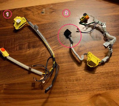

Hey,
I just bought a mfsw for my 6C that I'm trying to install. I'm unsure how to do the wiring. My airbag fits it, so the plan is to reuse it. I found a thread talking about that the airbag should have two ground points, which mine has.
The new steering wheel came with two wiring looms. I decided to go with the second one. It looked more alike with the original one, despite having another connector that would connect to the steering wheel.

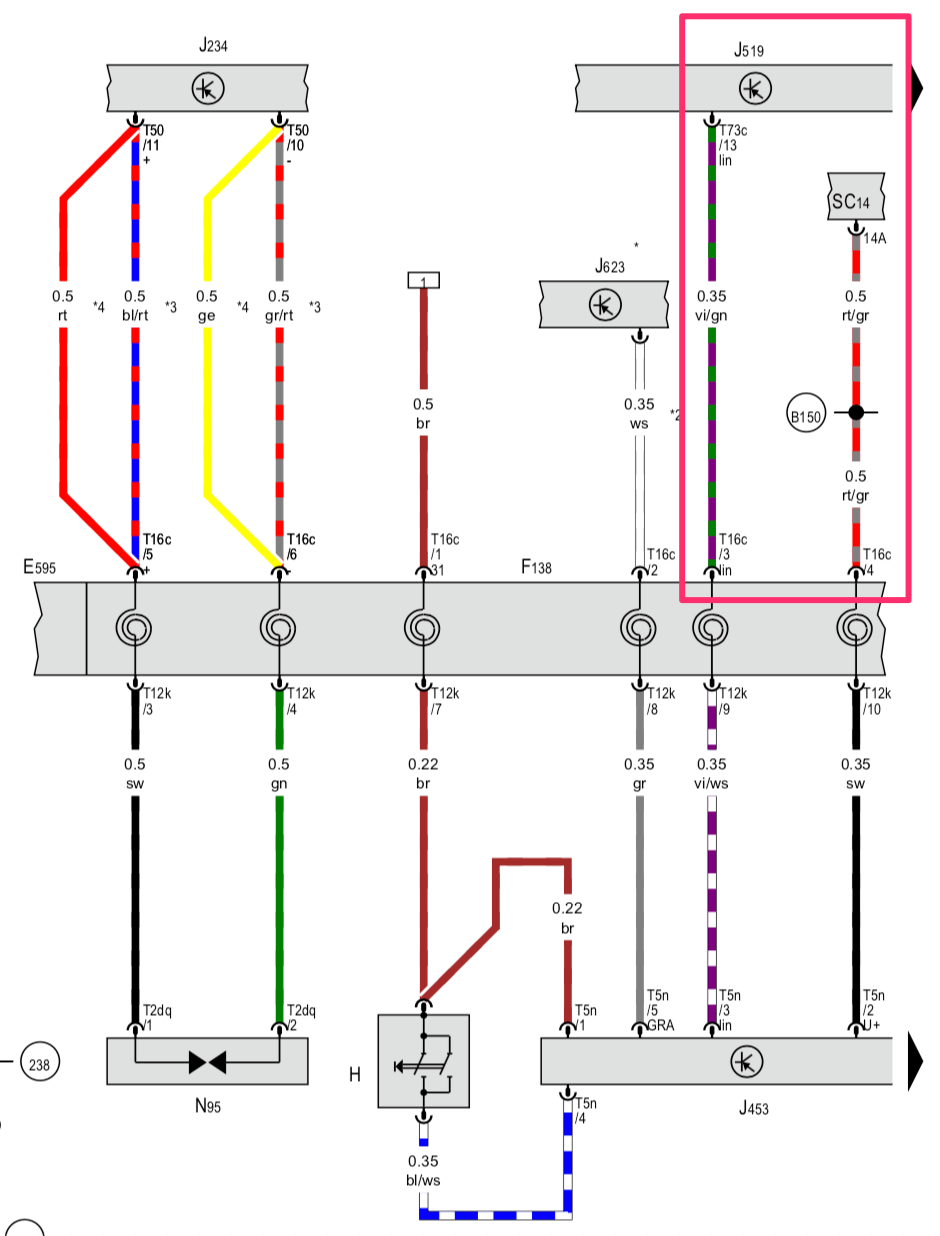

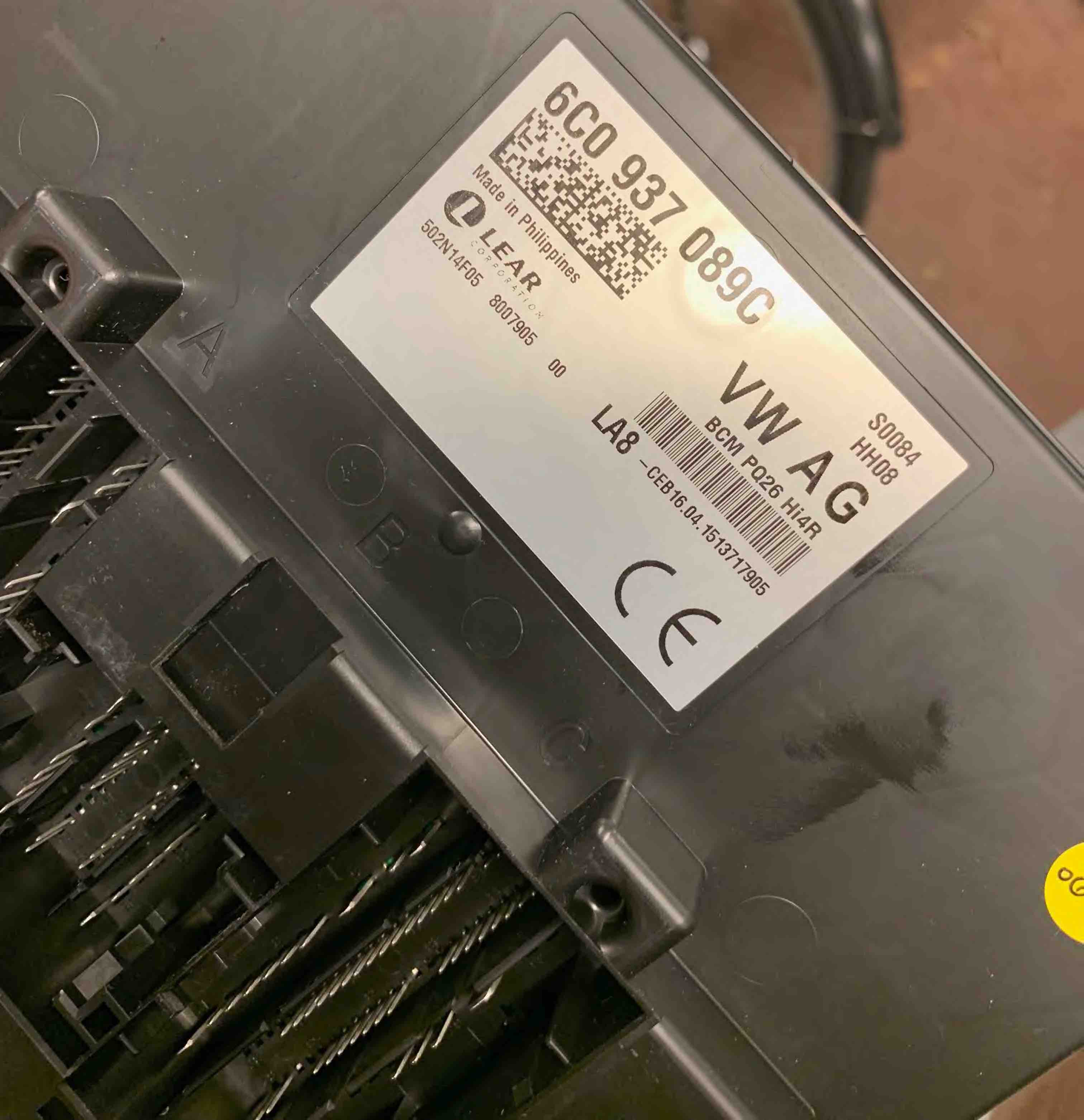

Now the question is, what wires I need to run to the stalks? I've attached a picture of my BCM

Fixed it by connecting the 16-pin connector's pin 3 to pin 13 on the BCM and pin 4 to 12V on the light switch.
Only thing to fix now is the horn, which doesn't seem to make any sounds.

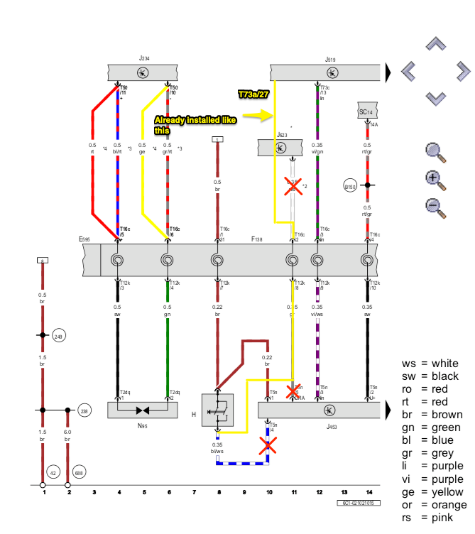

Didn't manage to get the horn working with above wiring. My car doesn't have cruise control - at least it's not wired and coded for it. My old stalks didn't support it, but my MFSW came with cruise control buttons. Without being sure, I think the cruise control needs to be in place and properly coded in order for the horn to work through J453. Cruise control steels the wire of the horn, why it's then operated differently. There would be no reason to operate it that way, if the wire isn't being consumed by something else. I ended up rerouting the cruise control wire, that was originally used to feed to horn, back to the horn switch. Now it works perfectly, but of course makes me unable to explore if my car has cruise control or if it can be retrofitted.
