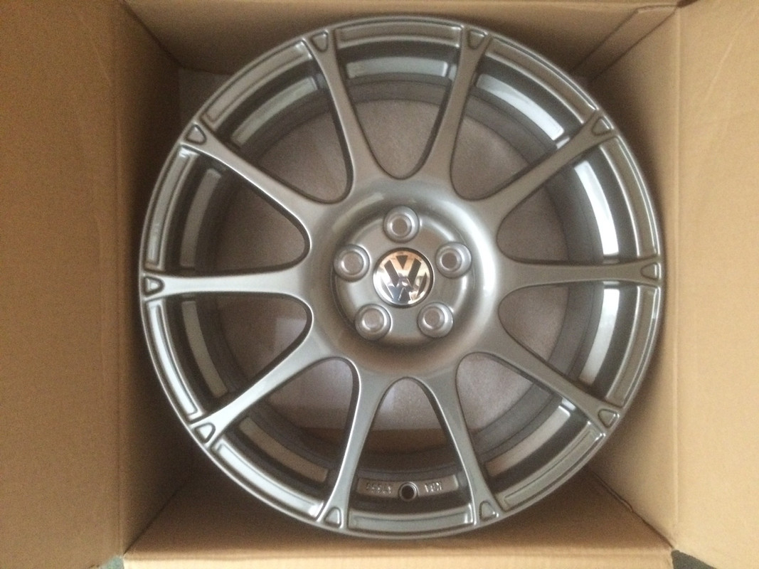

As for recommendations on alternative wheels that look nice; that’s a difficult one, as we all like different things, so only you can decide if you like a specific design of wheel. I have these on my Polo GTI (7j x 17” ET46)

The alloy picture you sent, the one you have on your polo gti, what are they called?
Posts: 3845
Re: VW POLO 1.2 TSI ALLOY SIZE/ GENERAL MAINTENANCE
sm57ruo wrote: Sun Dec 22, 2019 12:40 pm @SRGTD
They’re VW Motorsport and were available in Anthracite, Black or White. Size for the Polo is 7J x 17” ET46 (Centre Bore 57.1 and bolt pattern 5x100).
Part no’s (last three digits of the part number relates to the colour);
6R0071497 16Z (Anthracite)
6R0071497 AX1 (Black)
6R0071497 Y9C (White)
If buying new, I’m not sure if they’re still produced in all three colours; think they may now only be available in black, but a VW dealership parts department should be able to confirm which colours are available.

The Vw motorsport alloys are pretty hard to find in a set of 4! Look asweome though.
