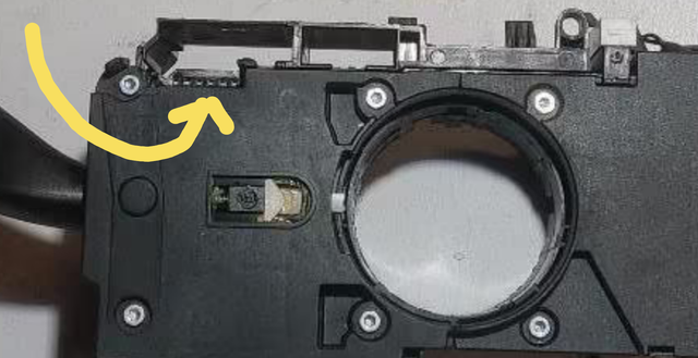

Hello Ciclo
do you happen to have a steering column switch with cruise control lying around? OE 6r0953521C
I need the number printed on the 6-pin male connector. or photo The small wiring harness goes to the lever with the cruise control switch.
This will save me a lot of time disconnecting the wires on the T41.

Posts: 8976
Re: Cruise Control Emulator
I don't have that specific image.
I never actually modified the combination switch levers.
What are you trying to do?
I think it's better to play with the wires on the T41.
https://www.uk-polos.net/viewtopic.php?p=564515#p564515
Installing or removing T41 wires is very easy if you know how.

The steering column switches from VAG, Skoda, Seat , starting with a certain OE number, are all built the same. This means the stalks for cruise control, multifunction display, with and without rear wiper are interchangeable. The cruise control stalk is simply plugged in, just like the stalk for the multifunction display.
The flat connector goes into the empty slot for the cruise control stalk. This makes reverting to the original configuration easier.
The T41/10 LIN cable only needs to be disconnected once and looped through.
Photo to follow

Post by Screw_Diver »
Steering column switches 7E0 953 xxx and 6R0 953 xxx
https://i.ibb.co/VcRxG48f/CC-Stalk-Connector.png"
