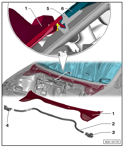

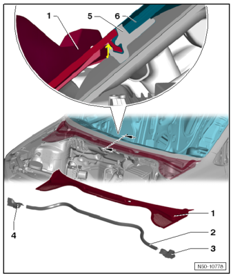

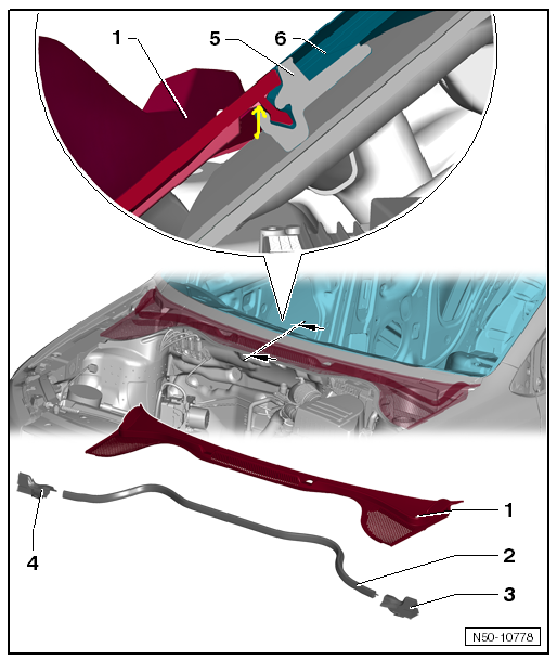

Do you have any tips on how to remove the water deflector or parafane as you call it? I am trying to remove it on my WRC so I can access the grommet of the main wiring harness, in order to route a small hose through the firewall for my boost gauge.
I have removed the wiper arm and then tried to pull the deflector away from the glass, starting from both driver and passenger side, but it won't come off. The corner of the bonnet is also in the way which makes it annoying...
I'm afraid of using too much force, causing the glass to crack. The workshop manual states that no tools should be used, but it seems I just can't get the deflecor of just by hand :?

start at the middle. bend it upward. then you'll be fine.

iichel wrote: Sat Apr 07, 2018 11:13 am start at the middle. bend it upward. then you'll be fine.
Do you mean right in the middle of the car, above the black bulkhead? I can only get my fingertips in between the black bulkhead and the plastic deflector. I'm think that if I just grab the edge of the plastic and bend it upwards, it will crack the lip holding it to the windshield (at the yellow arrow in the pic below).
I was trying for a good while today, also trying to go from the sides. I was putting my hand on the underside of the deflector as close to the windshield as possible and using my fingers to push the deflector upwards as hard as I could. It is not coming off :(
It definitely will be hard first time. But trust me. I’ve done several time. All you need is to get ur hands or soft tools as close as possible to clip area and lift it up. You will get the feeling you re going to break the part, but it is not that easy because the material is really bendable and elastic. A bit more force will force the clip out. U will not need any tool really.
