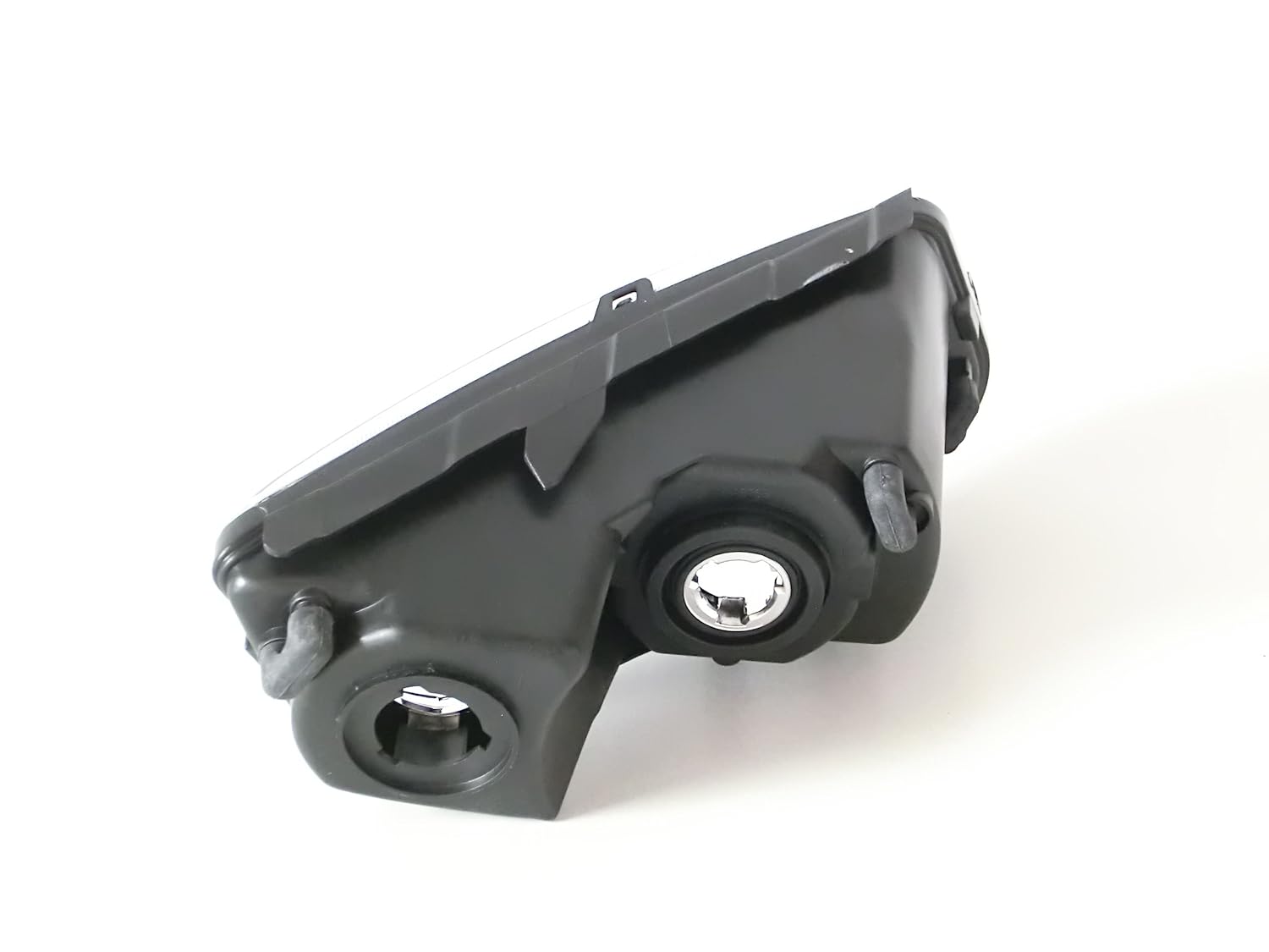

I'm seeing the possibilities of your BCM. Also the diagrams to connect your fog lamps and DRL (if possible)JacobGardinerMoon wrote:Hello Circlo,
Please show me a picture of the backside of the fog lights you bought. (to clarify what you need)
This one:
http://www.partoso24.de/images/onthefly ... 8143_1.jpg
or:
http://ecx.images-amazon.com/images/I/7 ... L1500_.jpg

JacobGardinerMoon
- Posts: 37
- Joined: Sun Sep 07, 2014 10:54 am
- Drives: Polo 6R
Re: ciclo's Polo. R-line 1.2 TSI 90hp 119gr.
Hello Ciclo,
Part code is 6R0941061F
Kind regards
Jacob
Kind regards
Jacob
JacobGardinerMoon

Just to confirm It's the 1st type you have specified,
Thanks in advance
Thanks in advance

So you have no daytime running lights.
Your fog lights can not work either as daytime running lights (this is not possible anyway in the vw polo) nor as static cornering light because your BCM is not ready for it.
Your installation of fog lights is easy, as in the previous diagram.
- Pin8, light switch connector.
- Fuse SB54 15 Amp.
- Fog lights.
- Fuse SB54 15 Amp.
- Fog lights.
