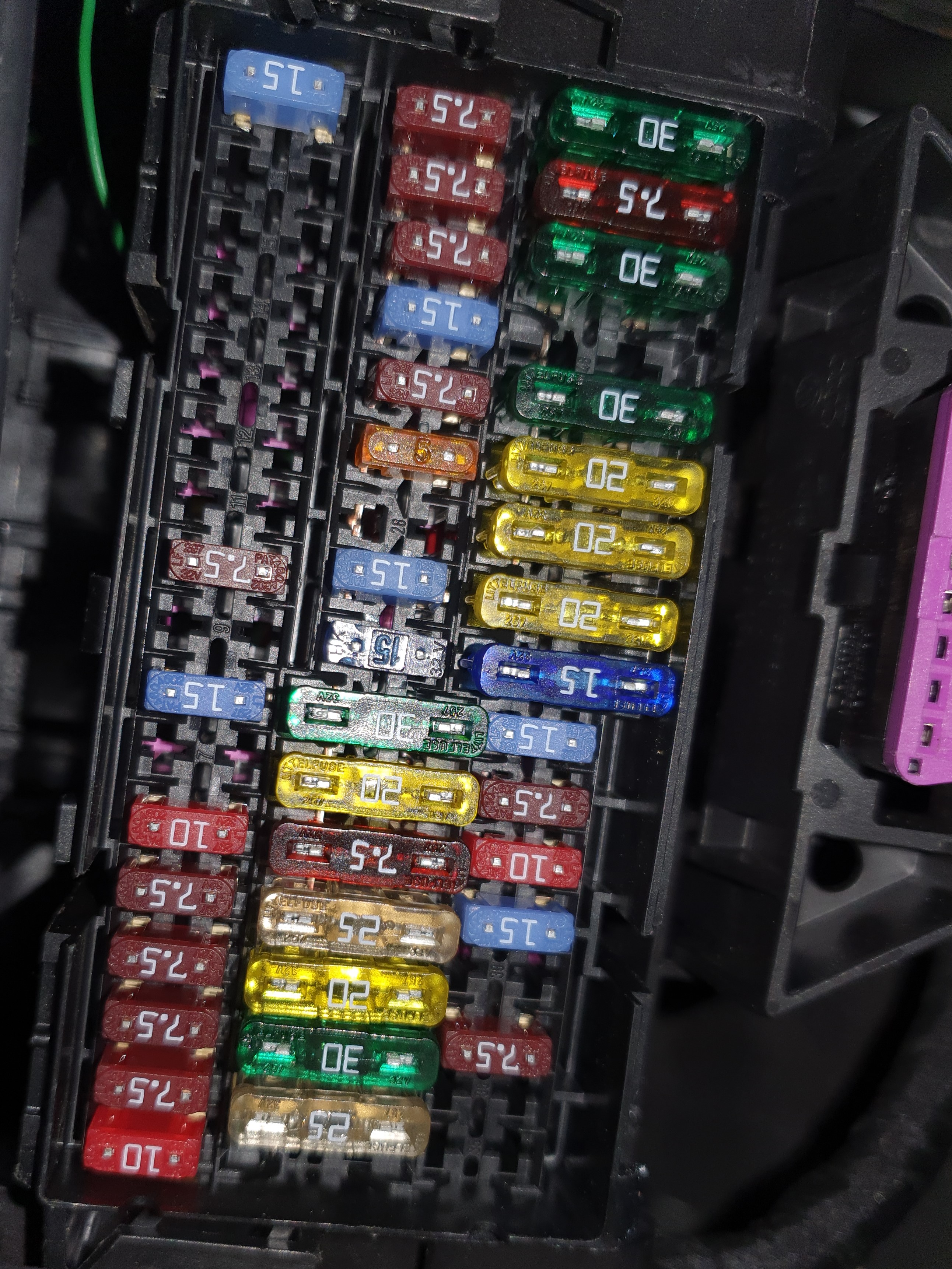

I've tried to fit the pin on /56 and /61 and... unfortunately nothing has been changed . The main switch continue to appear off, the cancel button appear off too and the bits continue out of standard and the same values on the video. I was thinking if it can't be something related to the software, because my software version 04C 906 026 CD and another up that I've scanned has 04C 906 026 J version (but doesn't have CCS too) and in CD version my vcds can't read the long coding helper and in J version can, the hardware its the same version on both. Another guy told me to test on pin 62, but I decide to talk to you first and wait. I guess that is possible that problem is related with the software, I don't have any friend that have a Up! equipped with CCS to do the compare the wiring position or software version.
PS: I'm sorry if my english is not good to understand, but I'm learning to get fluent one day.

According to the VCDS reading the fault is in the wiring, or ECU pin.
Please make an exact drawing of the wiring you have installed.
I suppose to insert the pin into the ECU connector you first removed the pink / purple / vilolet locking mechanism. It is a common mistake because it appears that the pin is inserted but it really is not inserted if you did not remove the locking mechanism. (read this thread) viewtopic.php?f=56&t=65431&start=285#p562849

I've used this diagram to install the CCS with diferences at terminal fuse, that was inserted on a terminal that was ready to use but without any fuse so, I put the pin and a 5A fuse on terminal 28 or 29, I don't remember well, and the pin on ECU before what you told me to do. I removed de locking mechanism before to insert the pin and put back and checked if it was locked. Before to install the wiring, I have tested the continuity and it was working. This is more difficult that I was thinking.

I am afraid that the SC28 and SC29 fuse box slots are 'terminals' with a +30 signal and the cruise control must be with a +15 signal.
+30 signal = with ignition switch OFF.
+15 signal = with ingition switch ON. (*)
For VW UP, the fuse box slots with a +15 signal are usually SC 1,2,3,4,5. ...at least until 2018, but your UP is 2020 (Model Year 'L' ... VIN: 9BWAH4127LT501299), so you must use a multimeter to locate a +15 signal (wire to connect/splice the CCS feed wire) in the fuse box because your fuse box may not be the same due to the manufacturing dates.
If you want, take a clear photo of your fuse box and show it here.
IMHO would recommend that you go to a VW dealer and request this information. All the operator/mechanic has to do is search the correct ECU pin for CCS on their computers.
It is a 0.5 sec task (easy) if the operator/mechanic knows what he is looking for.

I don't know how I can take this information about the signal. You can teach me how to do that using a multimeter?
That was the best photo that I could take at the moment, but if you another one, I can try to take at the day with more space

Your fusebox image edited with the crap from Windows 10 tools.
Two wires reach this fuse SC5, one is black (INPUT - SC5B -) and the other is black-gray (OUTPUT - SC5A -) and you must connect the CCS power wire to the output wire (SC5A).
A or B should be engraved on the plastic on the back of the fuse box.
This fuse is dedicated to powering the reverse light switch (for future reference).
I think it is a good place to connect the CCS power, the other first four fuses are occupied by various important devices or connectors.

Bad news. I put the cable in the output wire and... nothing has been changed. The values still the same and the main switch continue to not response as in the vídeo. A man that was helping me with this told me that I need to take a license to active the function via ODIS and another man told me that my software version won't be able to activate the function and because of this I will need to copy the software from a Up! that have cruise control enable from the factory to use the file to change my ecu. I'm sad about it, but I think that I will buy this universal cruise control https://loja.onmotus.com.br/produtos/throttle-up-vw-up/ciclo wrote: ↑Sat Mar 28, 2020 6:01 am Your fusebox image edited with the crap from Windows 10 tools.
