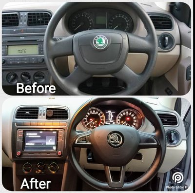

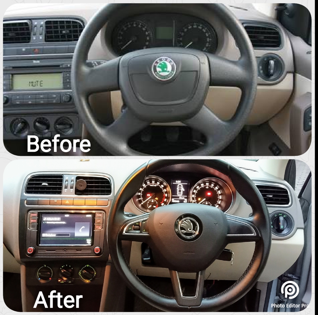

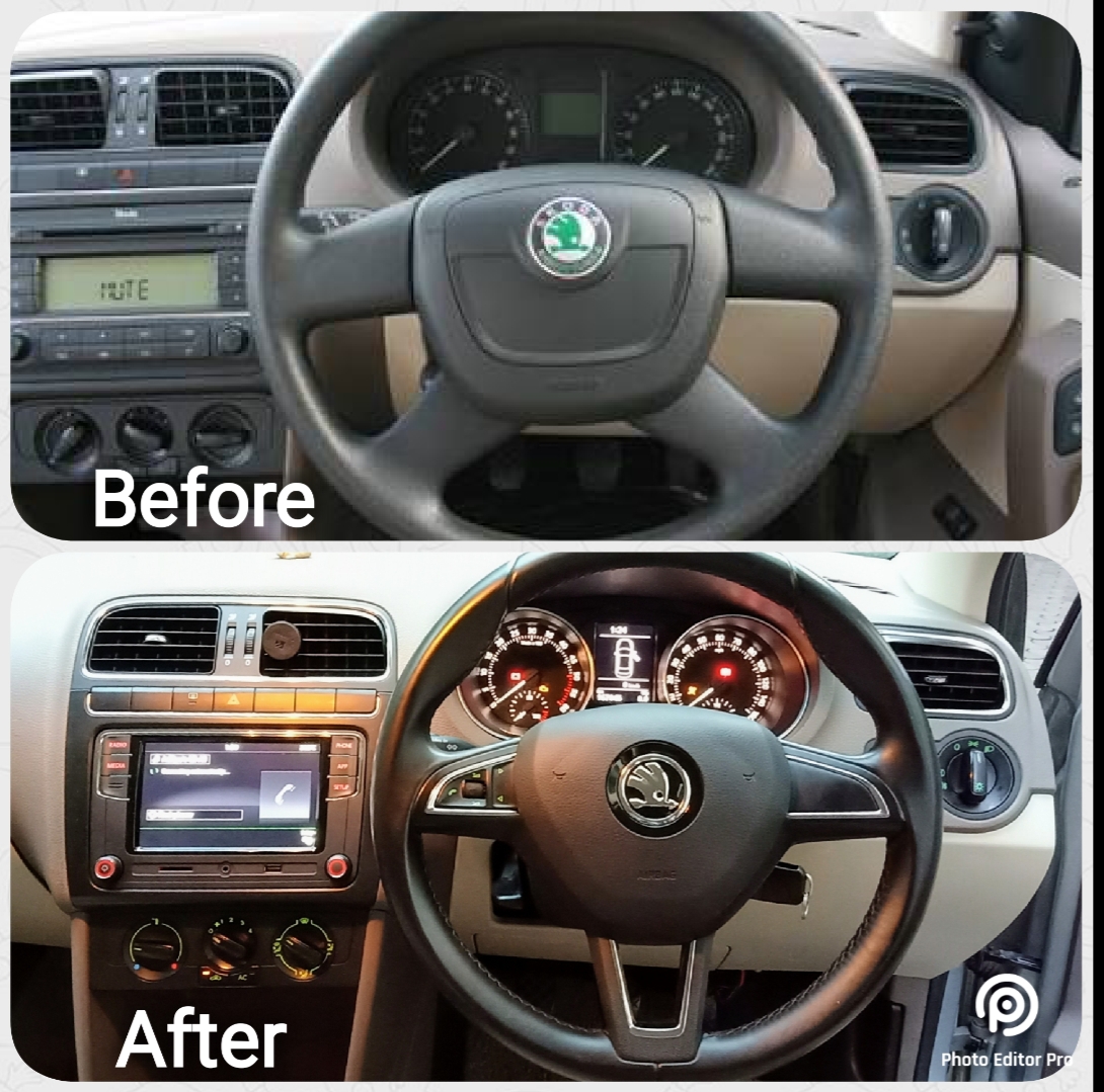

You have done so many mods about which i dream. Great work.
I have skoda rapid indian version. Which is just an rebadged polo sedan. It has electro mechanical steering, manual ac and only driver side airbag.
How can we set 20% step for power steeeing?
Also i am trying to install climatronic in my car. My mechanic friend have another same car with climateonic which he is scrapping. I had planned to swap entire wiring harness from that car to my car. But now its not possible. That wiring harness is missing some wiring coonecting to engine, someone stolen it. Can i retrofit climatronic without changing full wiring harness?. That scrap car has all the parts related to climatrnic also has wiring related to climatronic which i can use .
One purpose was changing wiring harness was to get passenger airbag installed. Few days back i had one full wiring harness in which i tried to figure out connection from aibag module to second airbag. I saw few airbag wires going into engine bay also, But didnt found how, why and from where these wires was going. So left the thought of making wiring for passenger airbag. I have already bought airbag module which supports passenger airbag.
