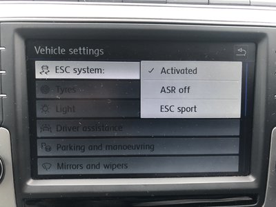

Hi miky i found more abs coding on the web and a car from italy and from another country uses the value 0C in byte 25. So that might not work.

Changing the abs code byte 25 from 0C to 8F

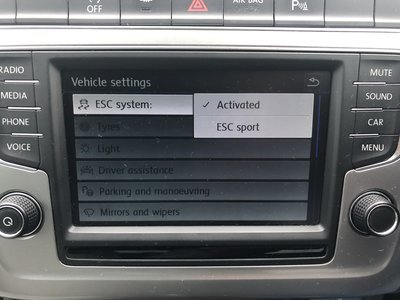

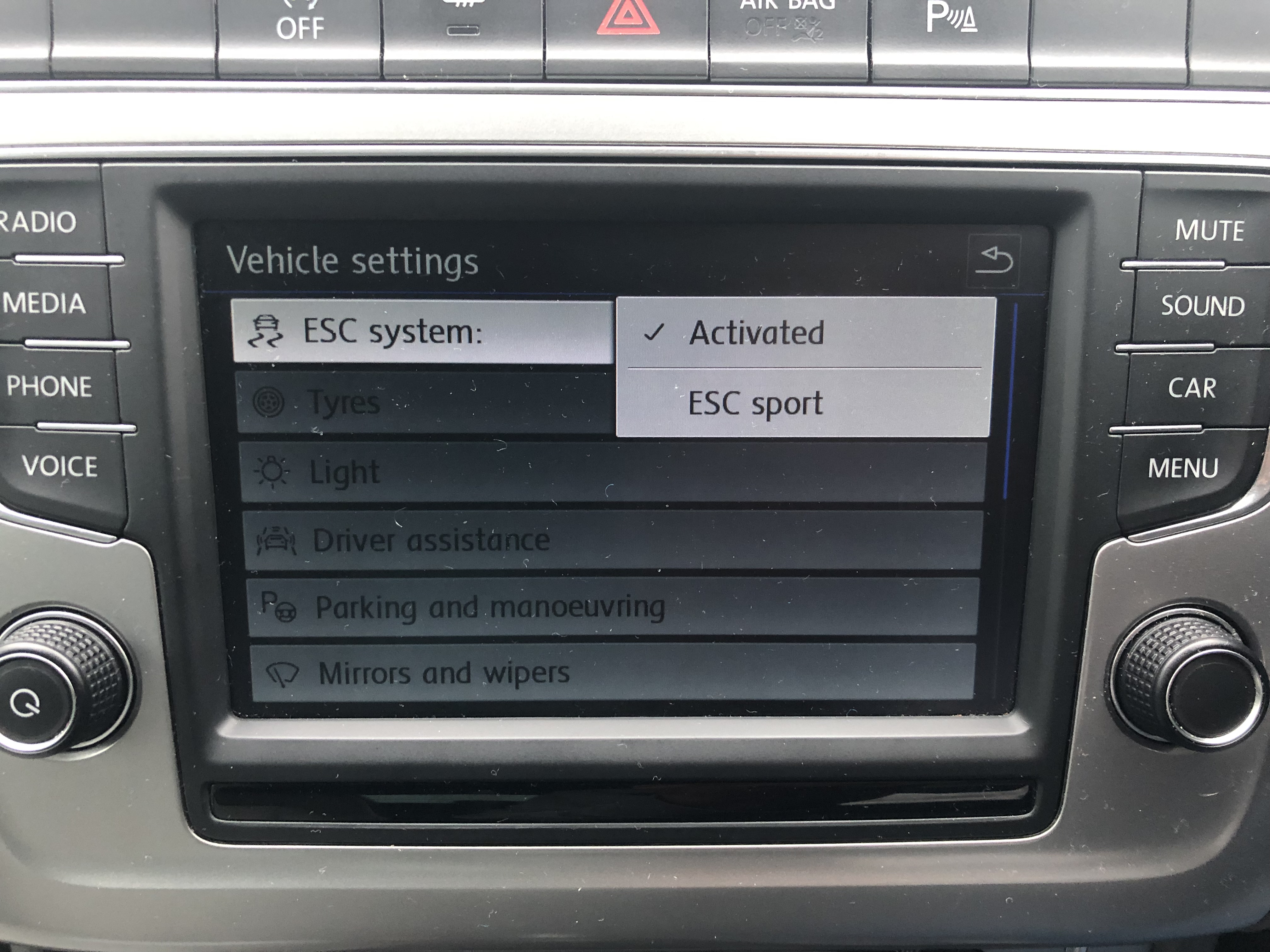

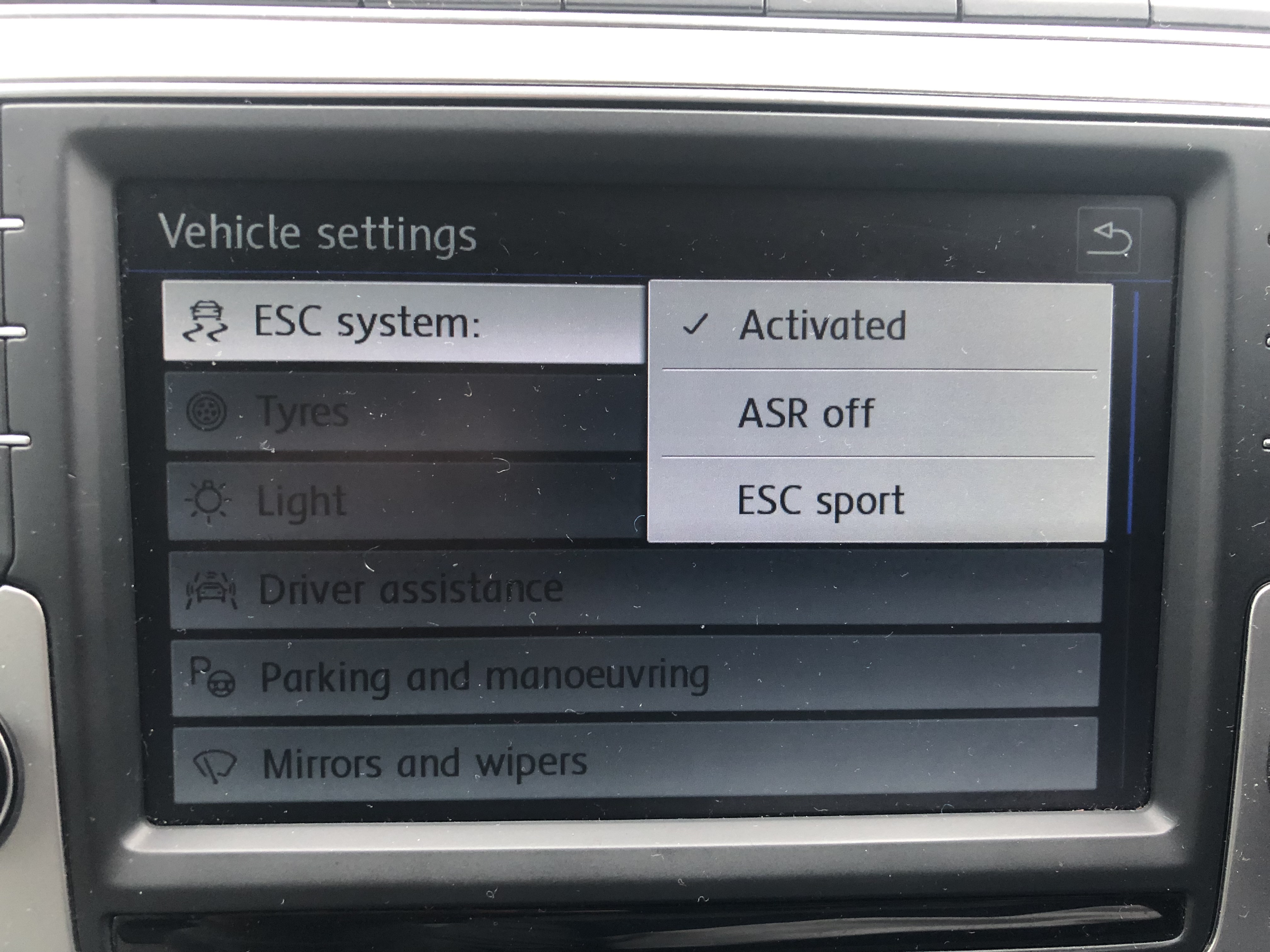

Hi mike. Just a thought. Regarding the Brake_0x26_msg_bus value. Was the value originally set to Databus Drivetrain or was it a different value?
Do you have indirect Tpms?
Looking at the value in my car it uses the same data bus:
tire_pressure_system_0x07: activated
tire_pressure_system_0x07_msg_bus: Databus drivetrain.
Also the value DB works on my car but won't let my code EB.

Post by massimo23 » Thu Feb 28, 2019 4:52 pm
So i changed byte 22 of Abs to CF and the Esc System menu changed to this:
And again with value E7:
