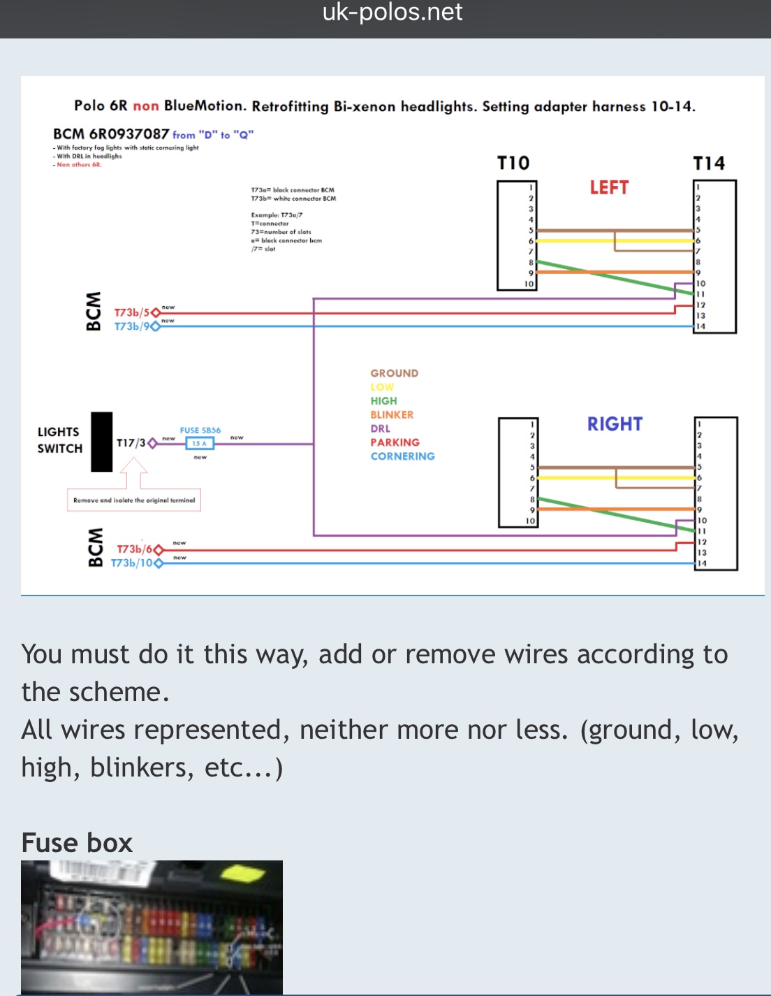

Hi, I’m a new entry and I’m writing from Italy. I am a Polo 6R R-line owner. I’m fitting a bixenon OEM set with kufatec adapters but I haven’t got installing guide to connect the five additional wires and six wires from pins 10-12-14 coming from headlights.
My BCM part number is: 087K.
Can sameone give me an installing guide? If not, is there someone giving an help?
Thanks in advance
Retrofit bi-xenon oem

you'll need to upgrade your BCM as well, since your current BCM doesn't support OEM bi-xenon with LED DRL.
ciclo can help you, if you'd like to upgrade your BCM to BCM max 7E0.

Re: Retrofit bi-xenon oem
thank you for your answear. now i can post my old scan:

Do I need to upgrade my bcm and make some extra wires ? Ciclo, do you do those wires ?
But I found this diagrams on this forum. Is it wrong?
Thank you for the answers

Yes"."NicolòRigamonti wrote: ↑Tue Feb 13, 2018 11:40 am Do I need to upgrade my bcm and make some extra wires ?
Yes.

Ok, and what is the complete code of BCM that I must buy ?
