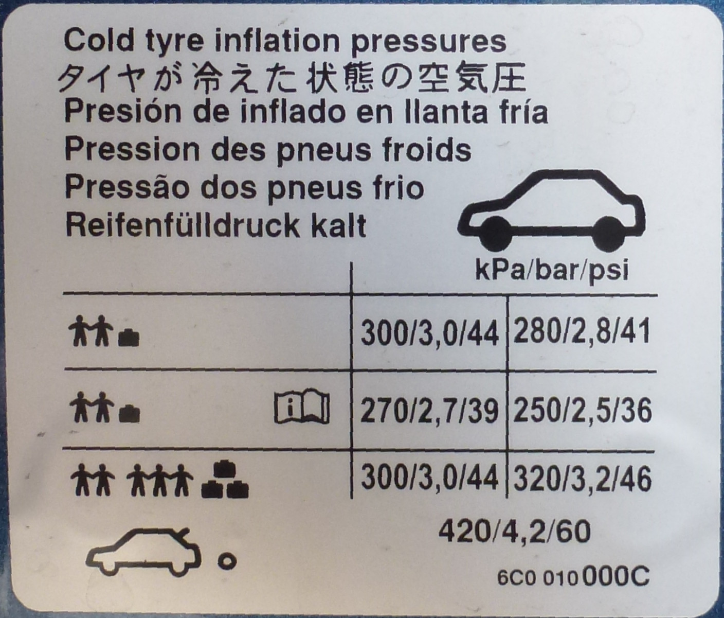

I have not added any sound-proofing yet, but the noise is becoming quite intrusive. It appears to emanate from the back. It is quite noticeable at about 20mph, although it can just about be detected at 10mph. As these are quite low speeds, I checked my tyre pressures thinking they might be too high. The car has only done about 1,000 miles since purchased from the VW dealer, when it had 5,871 miles on the clock. The tyres are Bridgestone Potenzas 215/40R17.
According to the label inside the petrol flap, they should have the following pressures: Regarding the "i" on the second line, the manual says "In some vehicles: comfort tyre pressure for partial load"
The measured tyre pressures were front: 36psi, rear: 27psi. I doubt if they will have lost much in 1,000 miles from what the VW dealer set them at. Is my car is one of these "some vehicles". In any case, the rears seem to have been under-inflated by any measure. I would have thought that would tend to reduce the tyre noise. What do people think?

I’ve had low profile Bridgestone tyres before, and have always found them to be quite noisy. Most Bridgestone tyres in 215/40 R17 size have a noise rating of 72db. compared to Dunlop Sport Maxx, which have a noise rating of 68db and Goodyear GSD3 Eagle F1 Which have a noise rating of 66db.
I wouldn’t put too much reliance in the dealer having set the tyre pressures at the manufacturers recommended setting before you picked up your car. I’ve had tyres set at incorrect pressures by the dealer on previous VW’s I owned when my car’s been in for service!

Going back to my original question, should I use the higher pressures or the lower "some vehicles" pressures? The manual would appear to suggest that, if the label includes this, then it is an option:
Comfort tyre pressure
In some vehicles, the tyre pressure sticker may show details of a "comfort" tyre pressure ⇒ Fig. 206 . This should make driving extra comfortable. Fuel consumption may increase when driving with comfort tyre pressure.
- Posts: 3508
Re: Polo Blue GT - sound proofing against tyre noise
No harm in trying it. Checked my tyre pressure label and it doesn’t include ‘confort’ tyre pressures like yours does. It does suggest on your label that comfort pressures are only appropriate for partial loads, so if you regularly carry a full car of passengers and luggage, then you’d need to adjust your tyre pressures accordingly.
As your tyre pressures are currently below the suggested ‘comfort’ pressure settings, increasing them to 39 psi front / 36 psi rear may reduce tyre noise a little, although other factors such as worn tyres (not applicable in your case) and tread pattern can also contribute to tyre noise.
Don’t forget to reset your TPMS once you’ve adjusted your tyre pressures.

I pumped up the tyres to the 'non-comfort' level of Front:300/3.0/44 and Rear:280/2.8/41. Unsurprisingly, the car is a bit lively over bumps and is not so comfortable now! However, the tyre noise has not changed - neither for the better nor for the worse, and not in pitch either. I could first of all try swapping fronts and rears, expecting the driven tyres to be a little more worn and less prone to noise. But I am beginning to suspect wheel bearings, even though there is only 7,000 miles on the clock.
