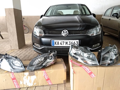

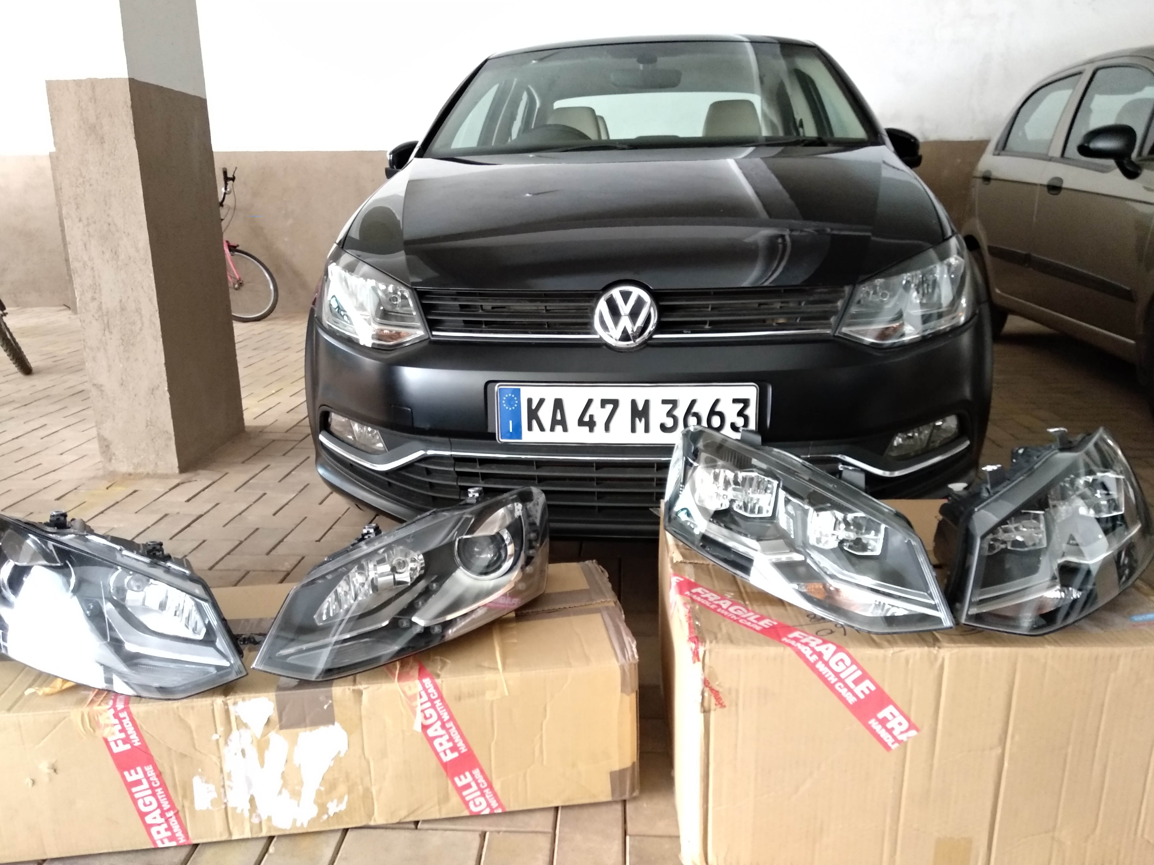

Re: Retrofitting LED headlights & BCM Max Adaptation+Auto Headlight with CH/LH on 2013 6R

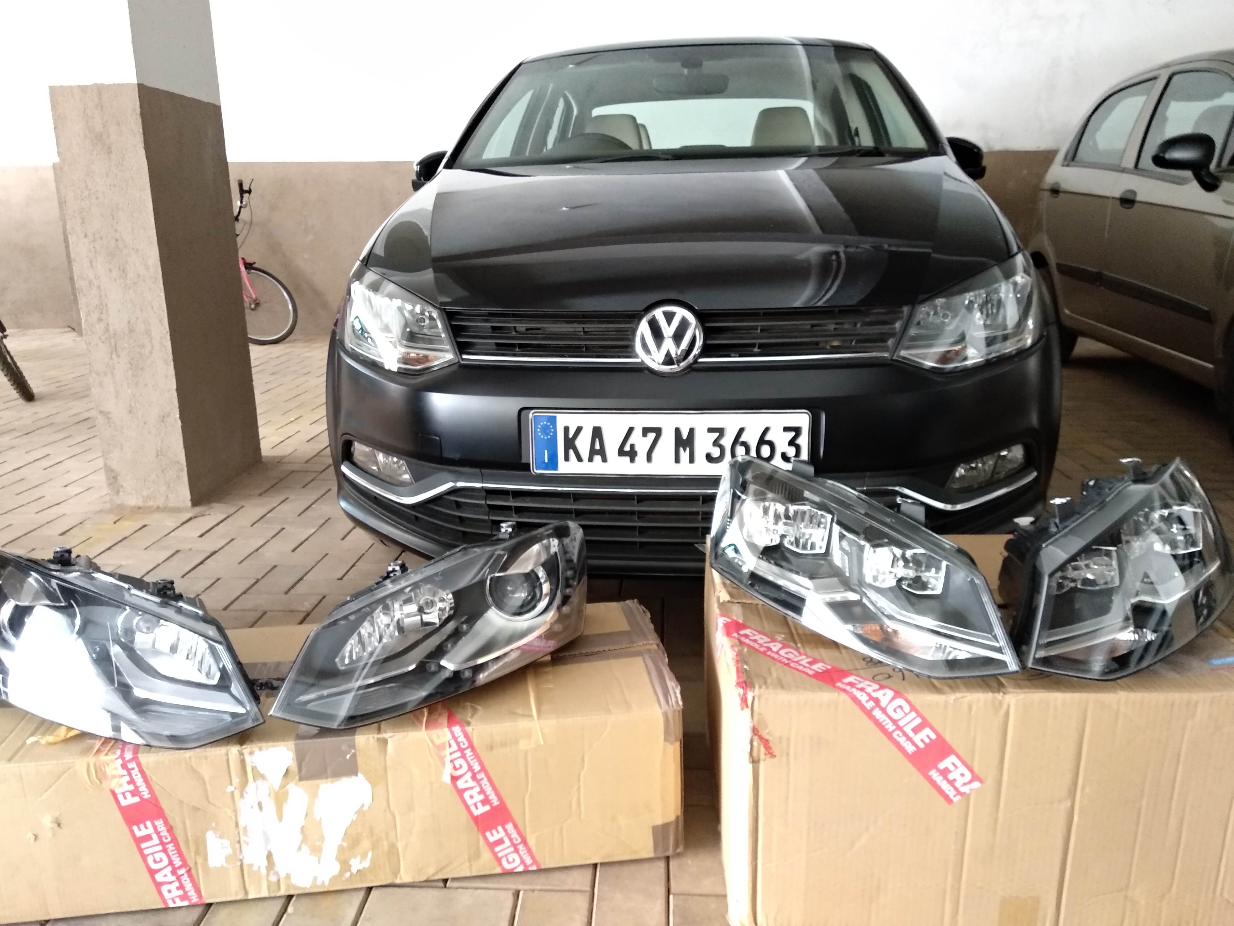

Selection process

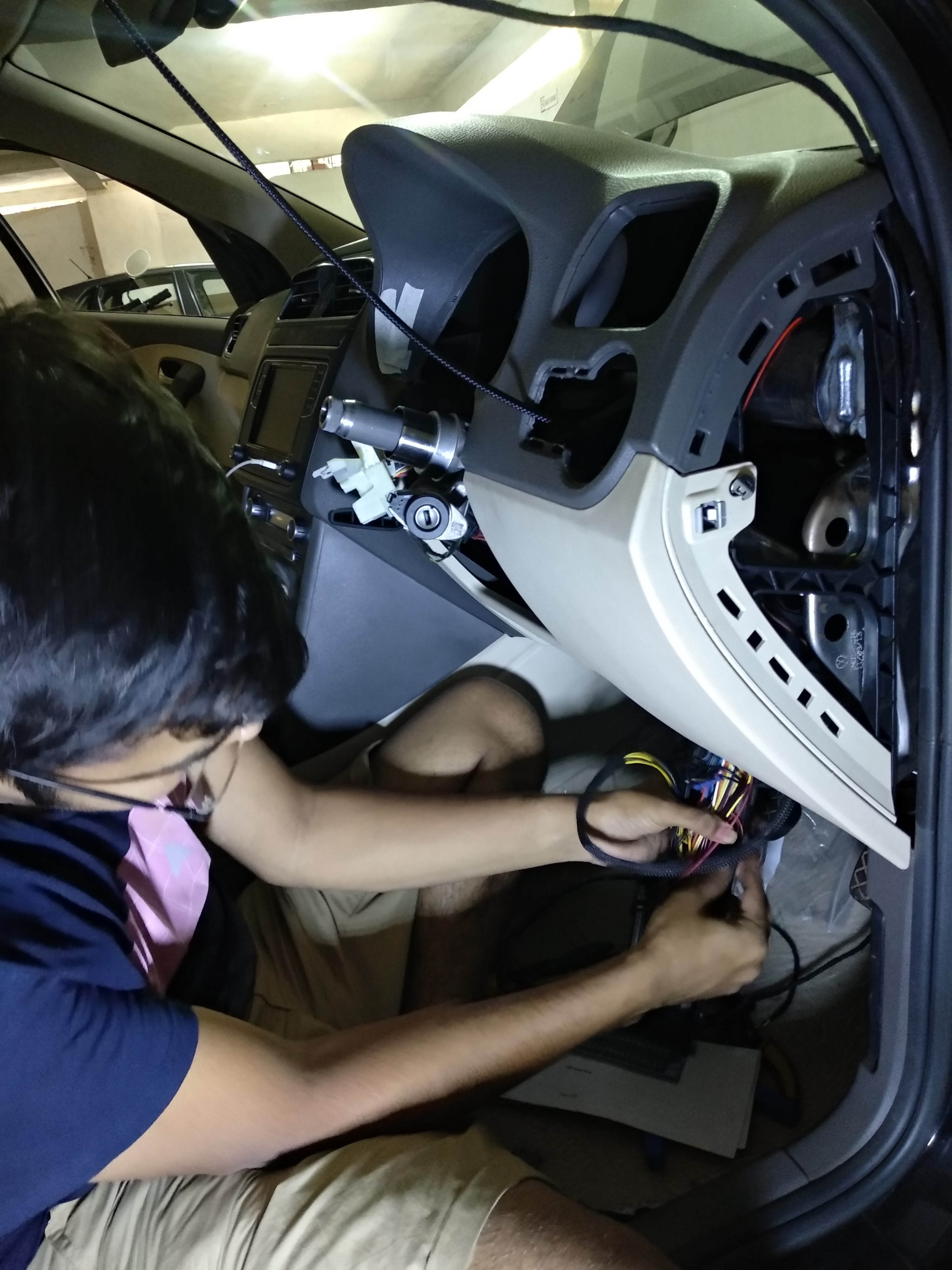

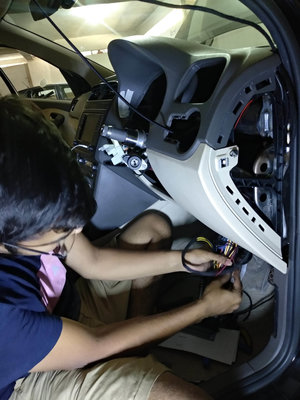

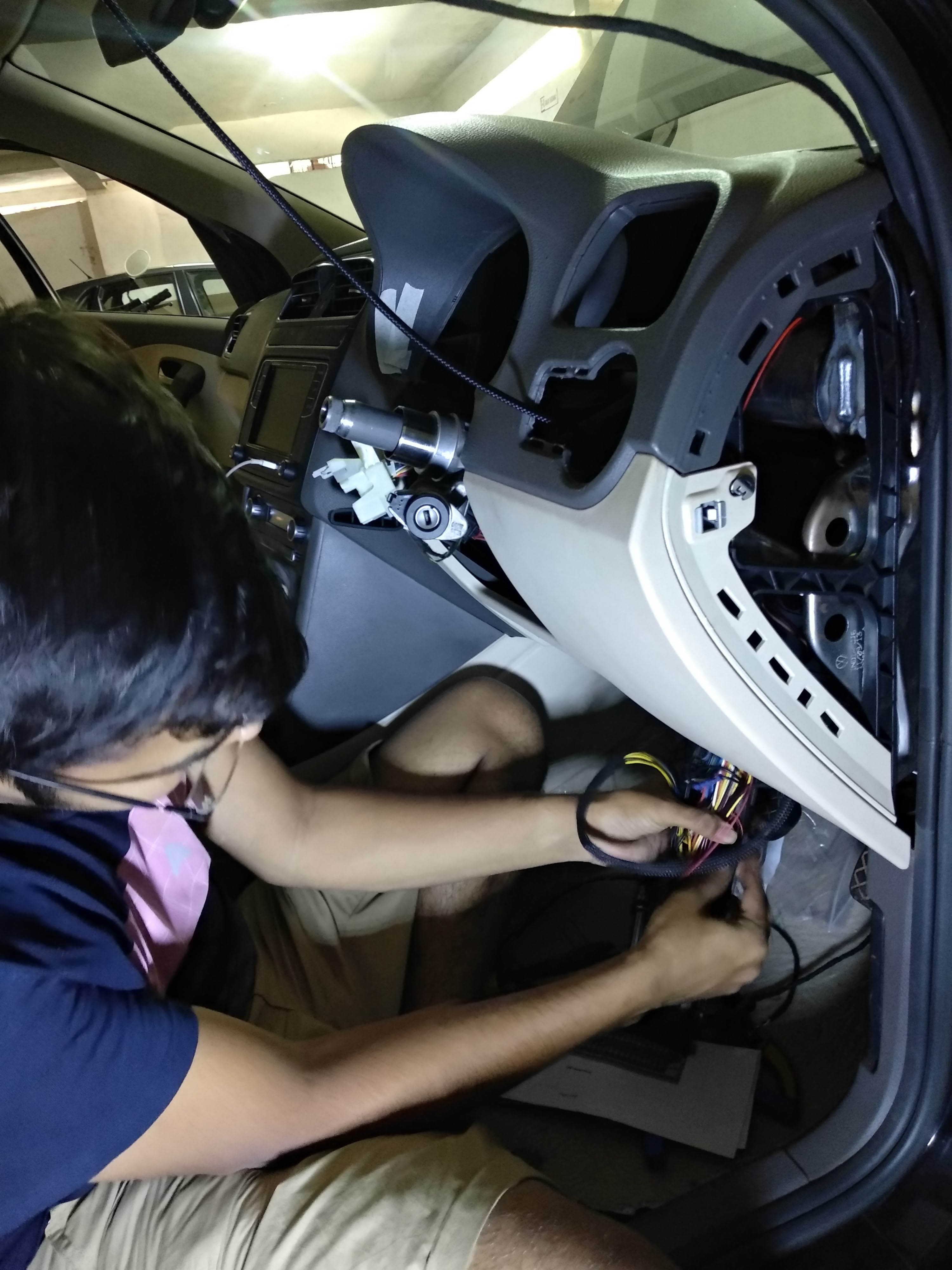

only picture of installation Nikhil in image
After installation 4am

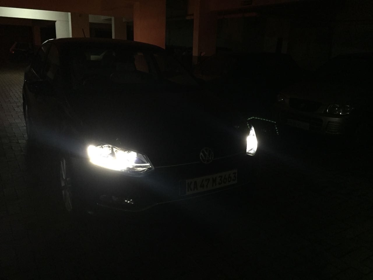

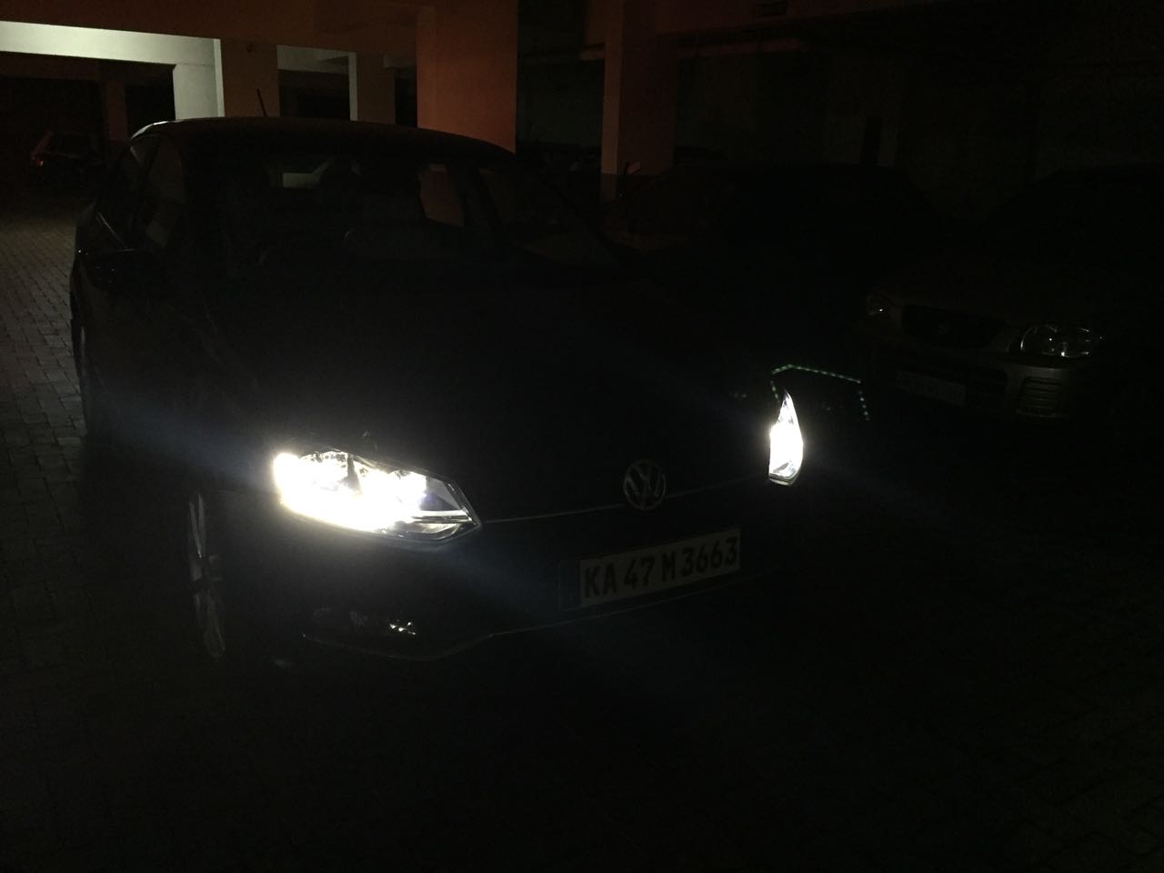

After this coding observation as below
Pass light(using left stalk) = working fine only High beam
Switch position to parking = Parking is ON
Fog lights = working (when fog is on parking off)
SCL = Only Left cornering is working. Right side not working

My previous Coding
3A904BBF48E10200013807916CCB96905A88676F608D30C1200000030000
with this coding observation as below
Pass light(using left stalk) = High beam n low beam both gets on
Switch position to parking = Parking is OFF
SCL = Both working fine
