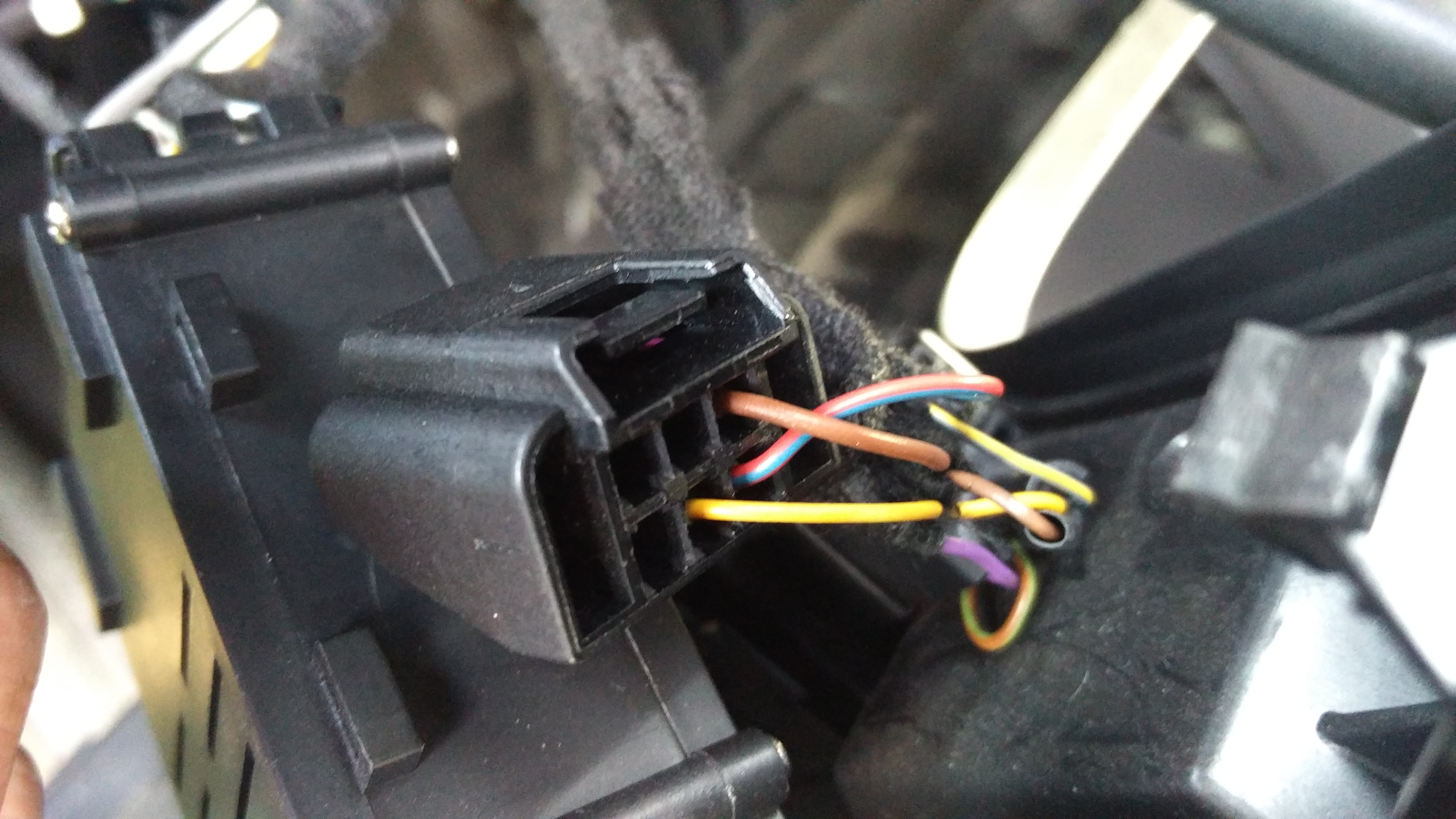

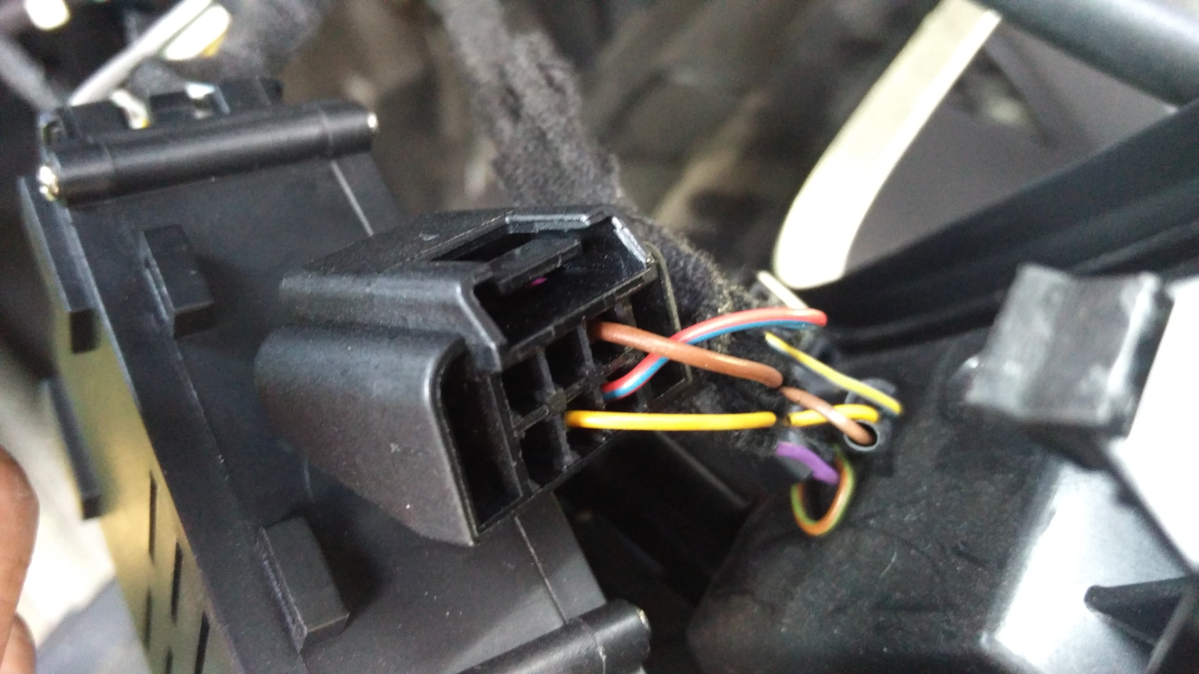

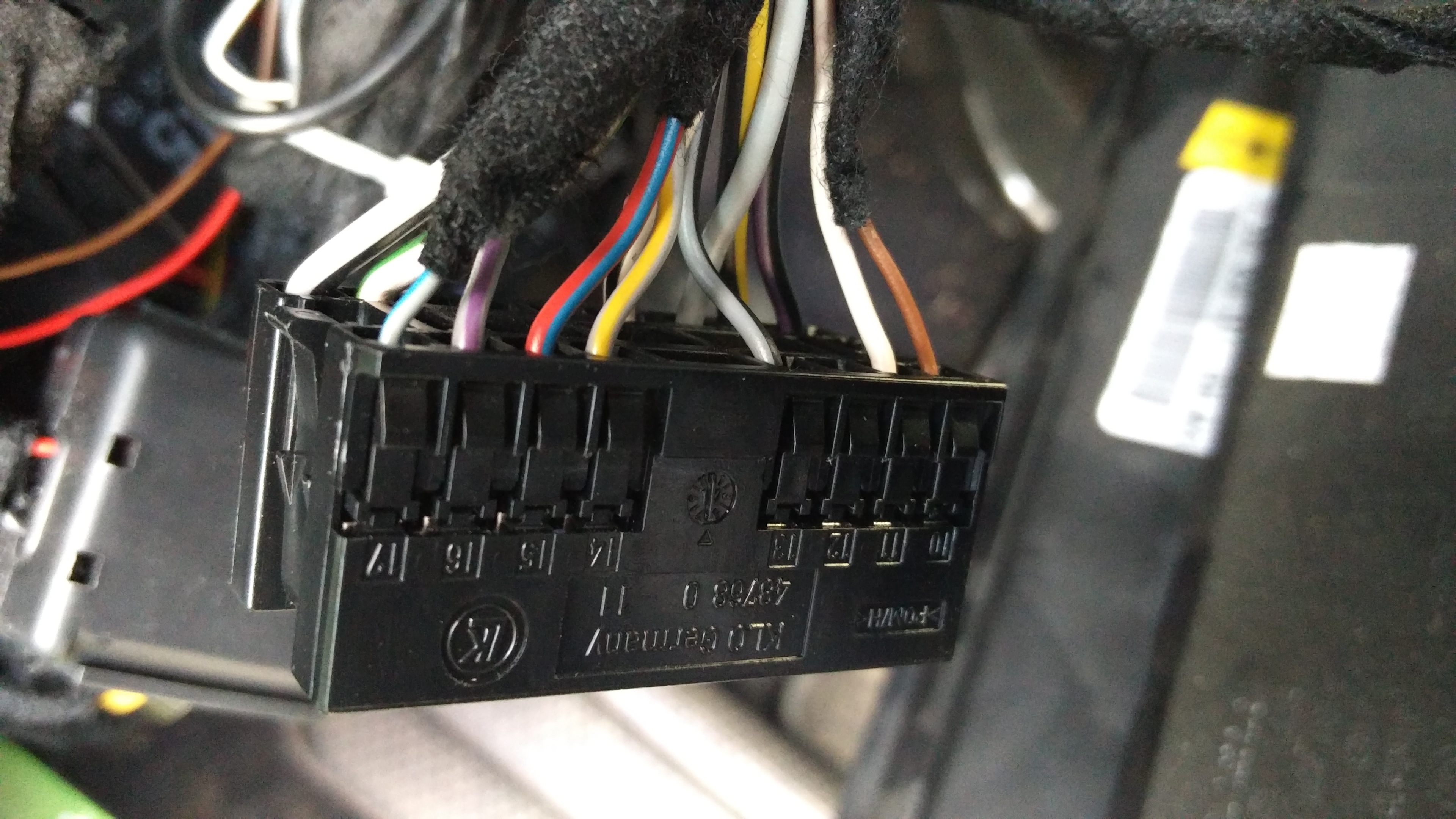

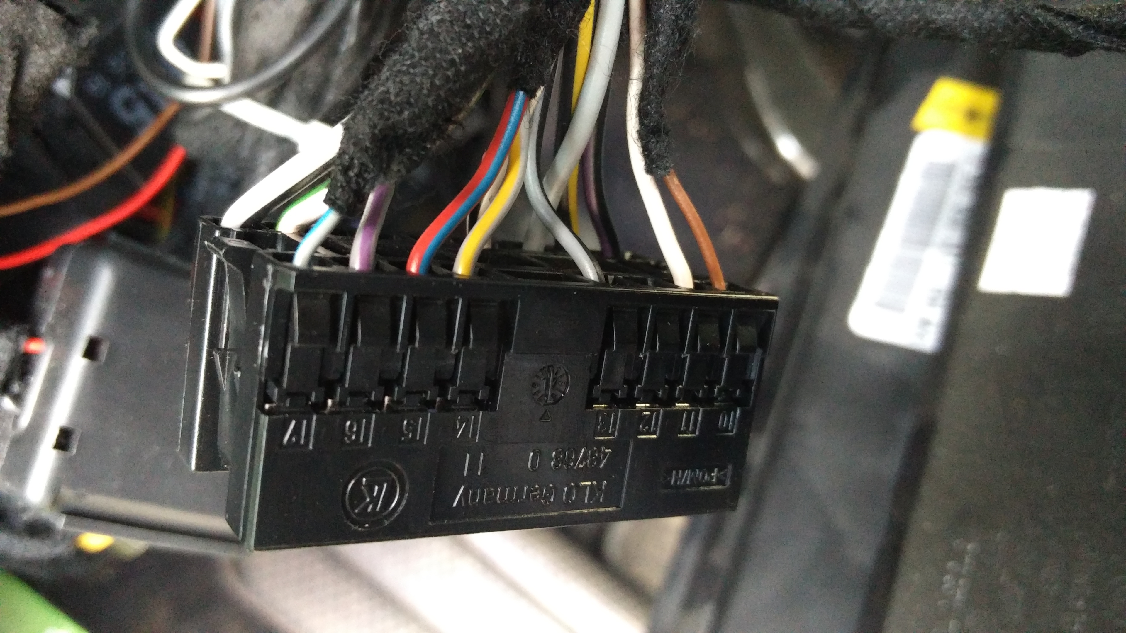

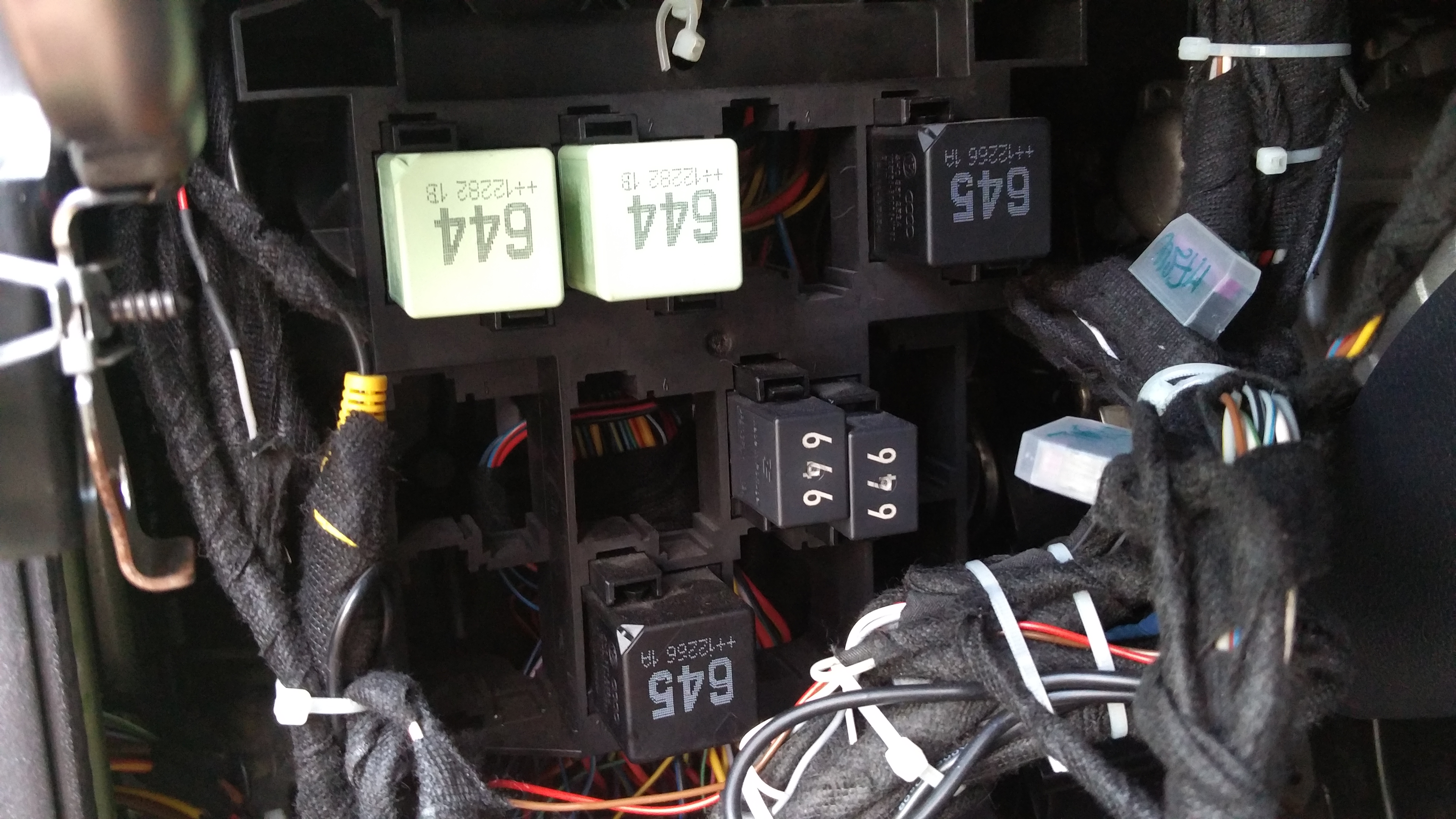

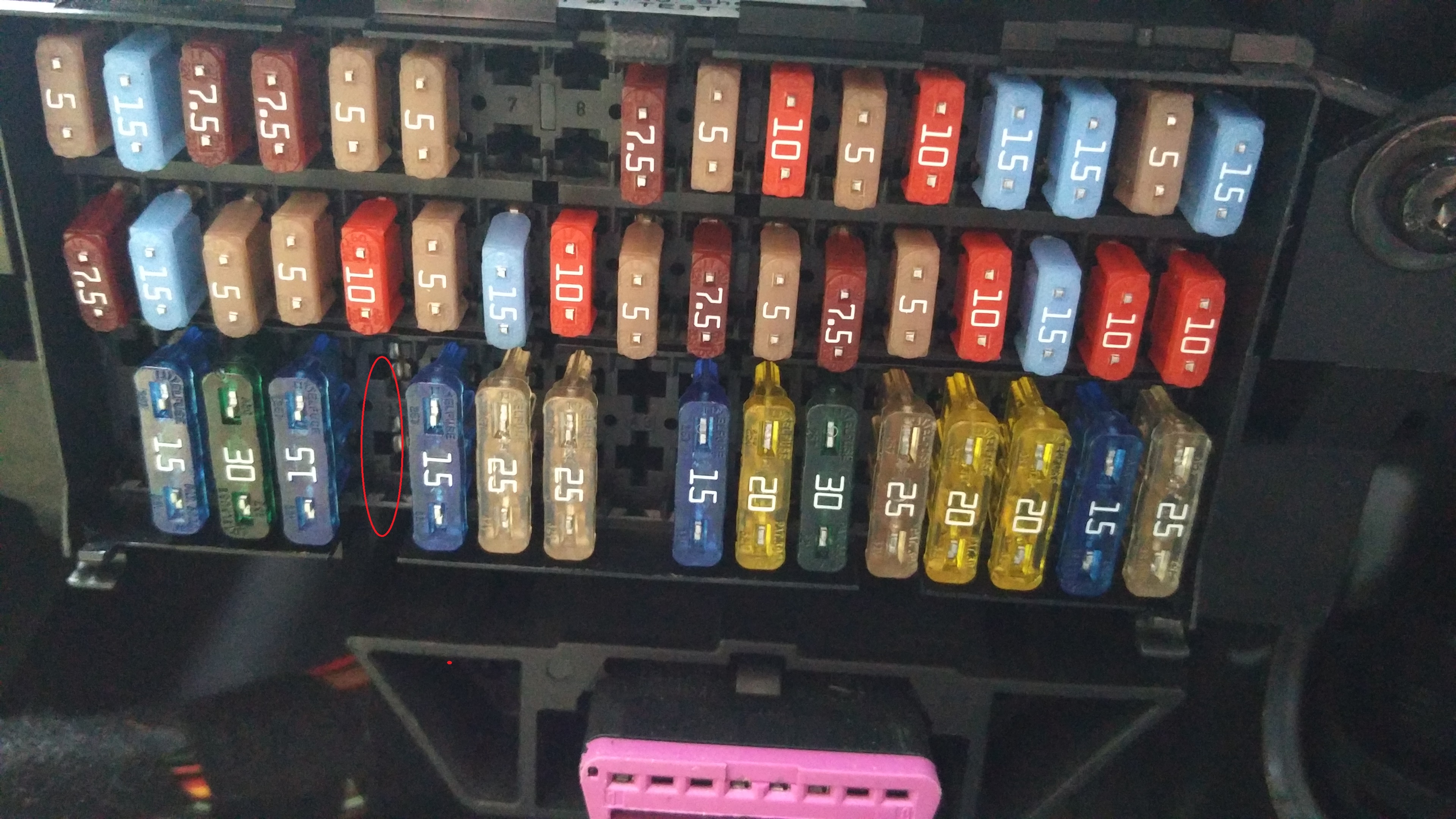

Please, take one o two photos (general view) of your Citigo in which we see the headlights and the light sensor.
Also a general image from the fuse box/relay carrier/BCM support so that I can imagine the lengths of the wires to be installed, the Citigo is unknown to me.
Btw, many thanks for the other images. 8)

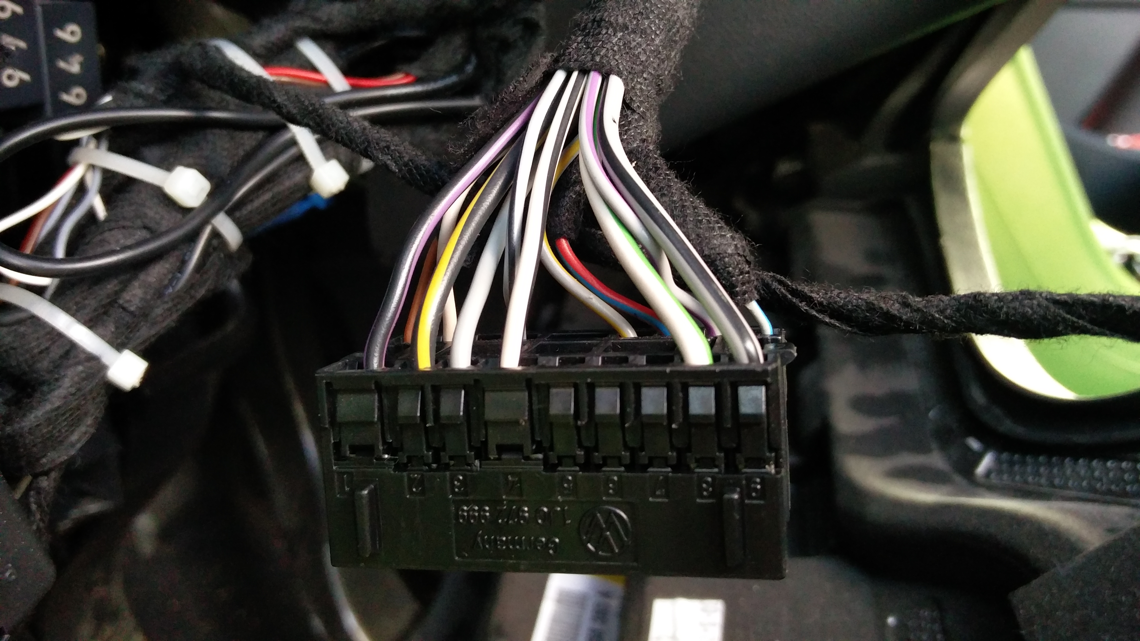

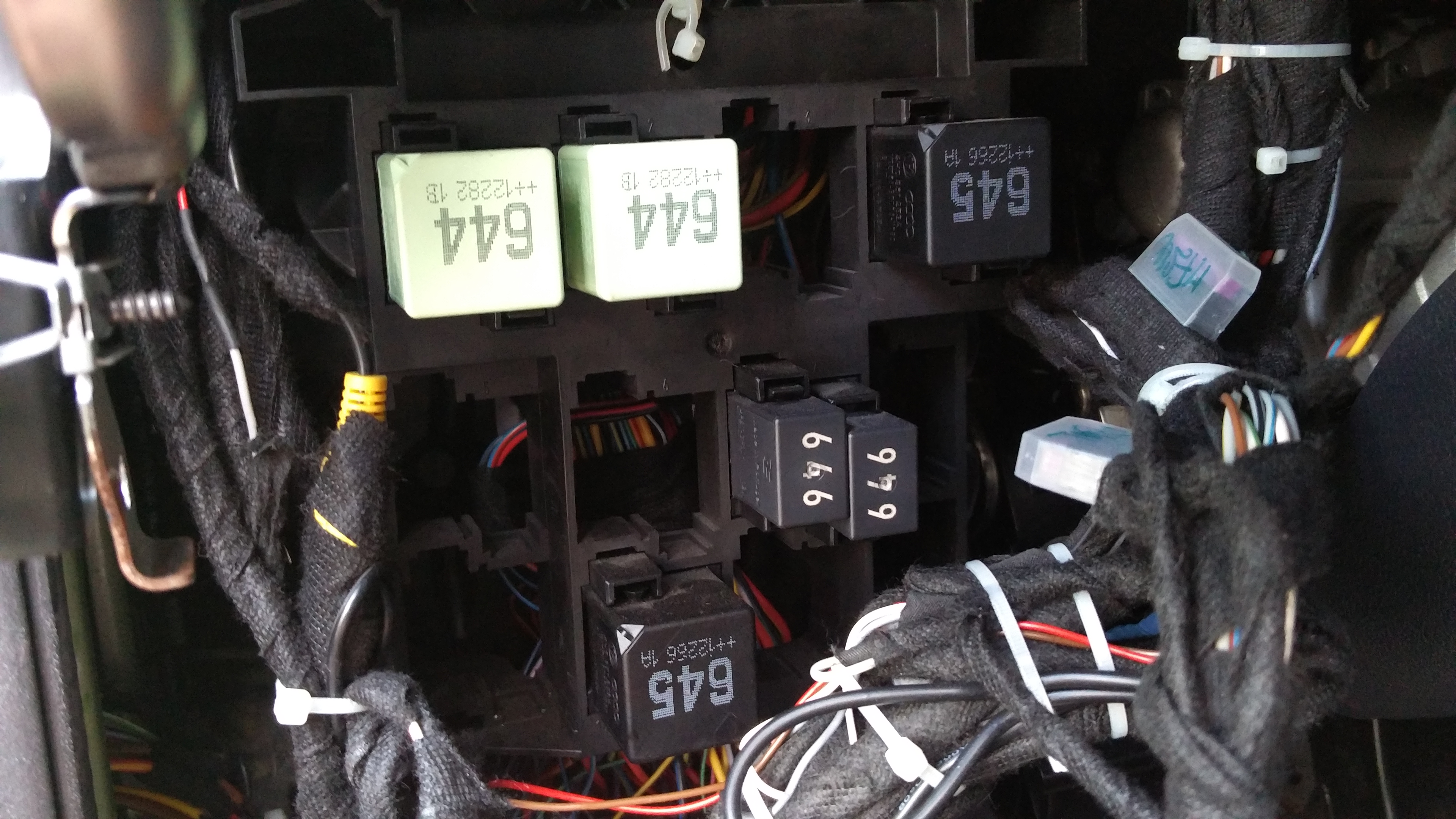

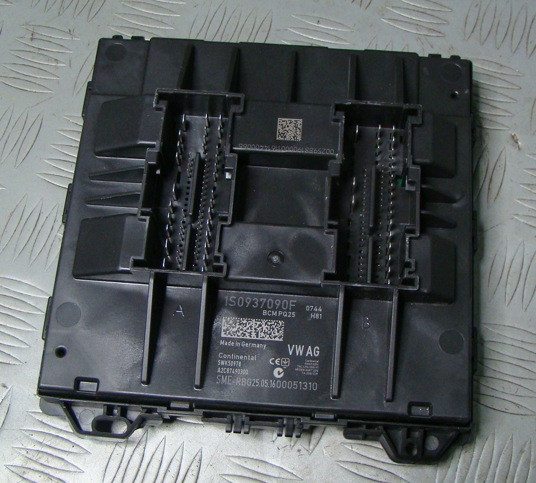

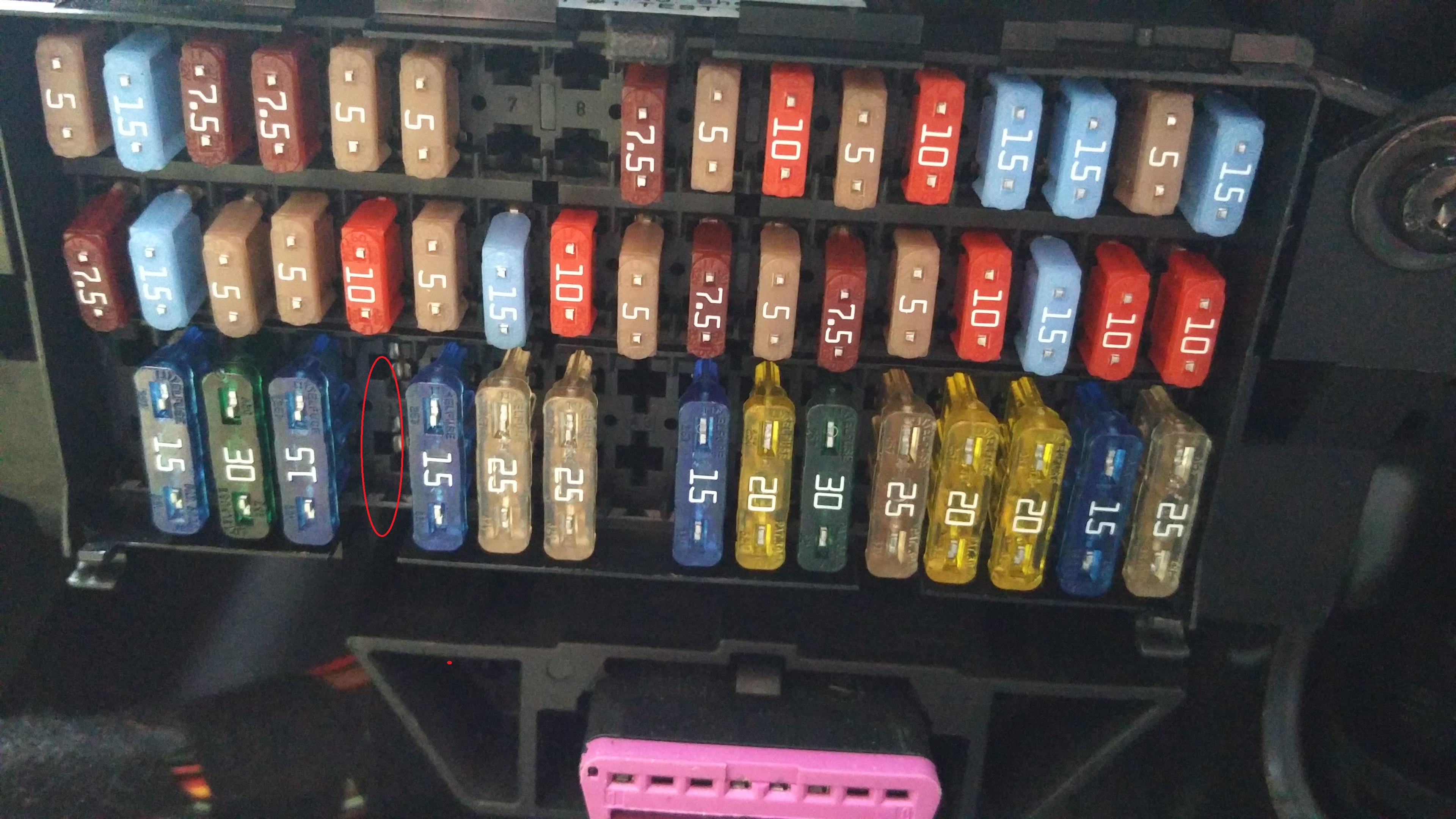

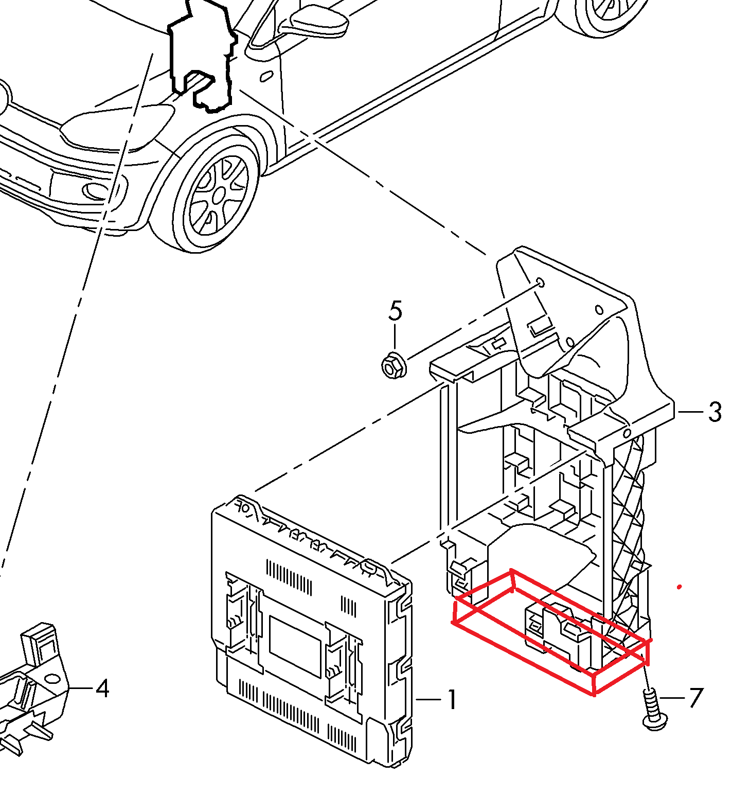

now I use china headlight switch from china light sensor kit. In the evening I find original OEM part number. But I think that connection is same on all of these ...
Now there are original preFL headlights ( 1xH1 bulb ), later I will retrofit original FL headlights with LED daylight ( 2x H7 bulbs ). Both has same harness, only new one has merged whole harness to one 10 pin connector on the back of the headlight. Old one has splitted cables to the bulbs ... Harness is same, even colours - few Citigo users changed headlights these days ...
RLS sensor I have retrofited ( including wind shield ), harness like OEM way - I have RLS from aliexpress 5K7 955 559 B, but will be changed for original Citigo 5K7 955 559 C. I have it, only not installed yet.
RLS is working, rain sensor part only ...

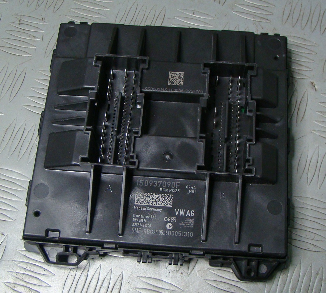

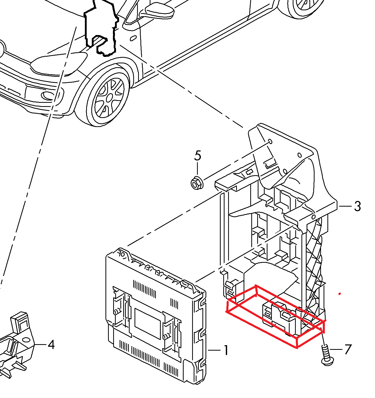

BCM is on the back of relay carrier ( very bad access - so impossible to make general photo ) and fusebox is mounted on the bottom of relay holder, fuses facing floor. So from anywhere ( BCM-Fusebox-Relays ) its short way, about 20-30cm ...
See drawing I find for idea, I add fusebox location - red pencil ...
Thx a lot for your time!

ciclo wrote: Fri Jun 08, 2018 1:11 pm I need you do the next thing before I manufacture your wiring looms:
- Verify that a green/white wire is present in T73a/62 BCM black connector.
- Make a 'NEW' VCDS autoscan. (Mandatory :))

There is no instruction for DIY new FL headlights ... only 2-3 people on Czech forum mention this and one that do it for one user wrote me that is only simple harness to connector swap. BUt on the other side, they sad that there is no dimming feature with turn signals... this is logical, its controlled via BCM ...
Pls be patient, I need one week to install new two wiress and check BCM ...

Images. No comment.
Image Image
Image Image
From 1S0937086B
To 1S0937090F
Image Image
What confirms some bugs in my Elsawin. :lol:
Posts: 8975
Re: BCM Max PQ25, adaptation. Automatic lights. Skoda Citigo/VW Up!
Hi Daniel.
Do you have any device connected in the SC39 slot? (I see there are two terminals in this slot)
It is very important to know.
