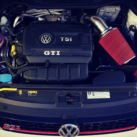

I've just fitted a K&N filter too my 6c gti pretty much just for a better sound drives spot on sounds good but after being ran for about 20 minutes the engine light came on it clears off but just come back on anyone know why haven't touched any wires as the MAF is on the turbo part ? Any ideas how too clear for good

Pretty much like the one with the k&n on but I used the original black pipe from the turbo too the air box just put the filter head on that's it

This could be being caused due to the filter now taking in warmer air than before as your original OEM had a cold air feed from the grill

What did you do will the little pipe that was attached to the oem Airbox?
On my induction kit it included a replacement pipe the joined to the pipe after the filter.

I just left it hanging in the bay it keeps putting a light on the dash it's doing my head in but love the sound it makes now what does that little pipe do thought it was just a breather house

It still has a cold air feed from the girl have left the grill feed on still so the air gets too the pod filter so that shouldn't make a difference

Not sure what the pipe actually does but I'm guessing that is your problem.
Guess you need some way of teeing it into the intake pipe.

Even with the original grill opening intact that will just feed ambient air into the hot underbonnet area. The confused air will not know it is supposed to go to the filter so will just mix with the hot air.
On a hot day you will generally loose up to 5% of normal power output and use a bit more fuel, no denying it will sound fruity though.
The little pipe feeds information to the ECU which enables it to adjust parameters for greatest efficiency, the ECU is not happy without that input so lights up the warning light. You may be able via VCDS to make the ECU think it doesn’t need that input but I’m only guessing.
If you can contrive some sort of duct or pipe feeding ambient air from the grill intake positioned to discharge very near to the filter you may be able to minimise the reduction in overall performance.

Thanks for all the info on this I went out and got a pipe with a rubber grommets in and put the rubber hose in and the light went off straight away the sound coming from the turbo is great ahha look the dogs b*******s and sounds really good sounds like it's running a massive dump valve every time I let off the throttle
