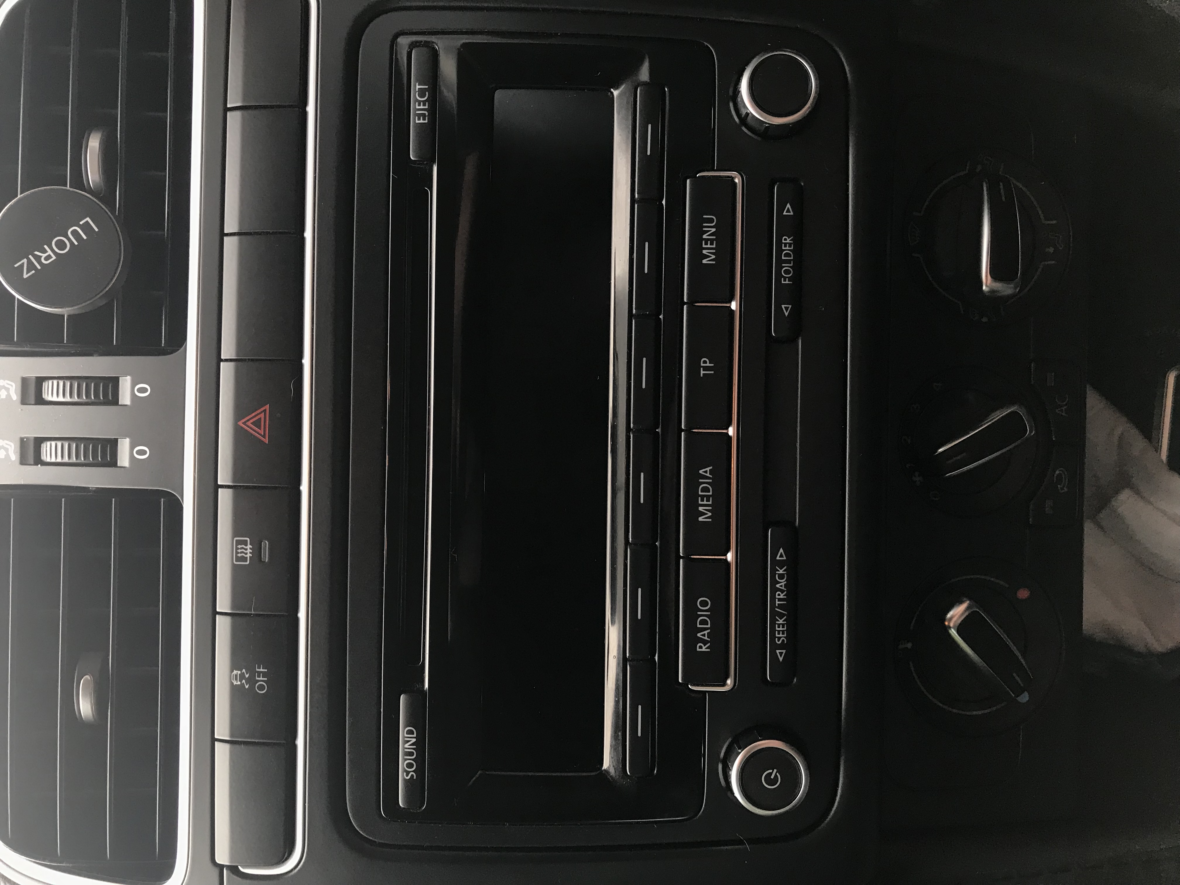

Thank you for the fast reply, would I need any extra adapter or cables in order to fit the RCD330. This is the current media system I have (See attached) :

Hi,Kaylum wrote:Thank you for the fast reply, would I need any extra adapter or cables in order to fit the RCD330. This is the current media system I have (See attached) :
Exact same set up my car had, the only adapter is antenna related, it takes the antenna single connector and transfers it to dual fakra
MAYA Twin Fakra male to Fakra female right angled antenna adapter to aftermarket radio for VW https://www.amazon.co.uk/dp/B01FR5VF4M/ ... CBbR4VY1N3
