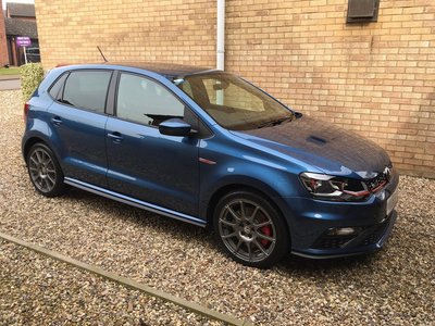

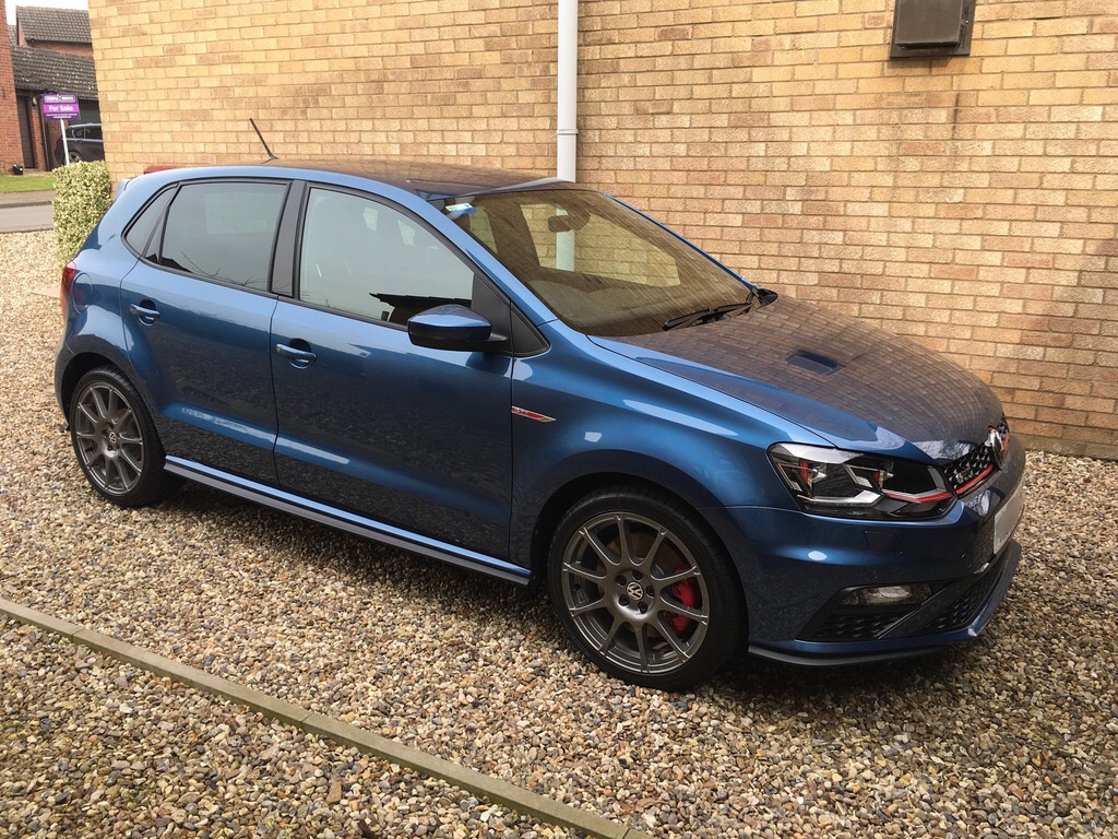

Here’s my car with the anthracite Motorsports, so you can see what they look like on a 6c Polo (click on picture to increase to full screen size);
I think Rivazzas, Boavistas and Motorsport alloys for the Polo are all a 7J wheel with an offset of ET46, so the stance of your car with either 17” option would be the same as you have with your existing 16” Rivazza alloys. As cheba has said a couple of posts earlier in this thread, the 17 alloys will need a lower profile tyre to the tyres fitted to your current wheels, so that the overall rolling radius of the 17” wheels + tyre is the same as your current wheels + tyres. I have 17” Motorsport alloys in anthracite on my Polo GTI and the tyre size is 215 / 40 R17. I’ve not found any disadvantages compared to the factory fit ‘Serron’ alloys that were on the car when I bought it. The big advantage for me is the Motorsport alloys aren’t diamond cut (the original Serrons are), so the powder coated/painted finish is hardy and durable for use in the UK, and there’s no risk of white worm corrosion. With a larger wheel/lower tyre profile than you currently have, you may notice a slightly firmer ride compared to your current ride.
