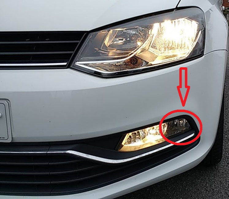

Hi all,
First post here on the forum and sorry to sound stupid
Had my Polo since May last year and its my first VW after moving away from French cars that I have been driving for years.

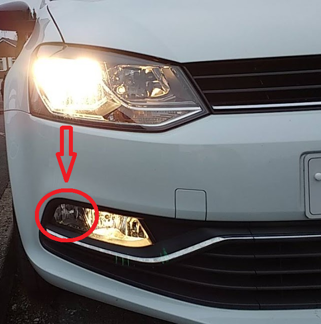

I have a question regarding the 2 lower lights on the front bumper of the car that I cant seem to get working and I know this sounds stupid but what are they actually for as when I check my other lights everything seems fine i.e Front fogs, side lights, full beam, normal beam etc all work fine)
The ones in question are highlighted red in the images attached and I don't think I have ever seen them working and looking at them close up both bulbs look fine and unused ???
So what are they actually for is my stupid question???
Chris

I’m pretty certain the outer portion of the lower lights in the bumper are just dummy lights and do nothing.

Hi there. On my polo 6c beats the outer lights are daytime lights Drl while the inner lights are fog/cornering lights. Do you have drl lights enabled or working?

That’s a very good point massimo23, they could well be the daytime running lights.
@chrisb1357; does your Polo have DRL’s in the headlamp unit? If not, then the lower outer lamps will very likely be your DRL’s. On UK cars built after around 2012, I don’t think there’s an option to turn them off. Easy to check to see if they’re working by turning the ignition on and then turn the rotary headlamp switch to the off position. Your DRL’s should then be the only lights that are illuminated.

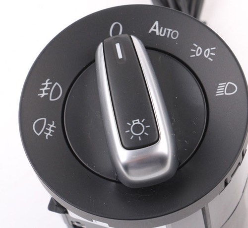

If your light knob is this model:
With the ignition on you have the following:
During the day only the Drl lights are working.
During the night the Drl lights are disabled while your low beams/sidelights are working.
There is a setting that allows you to disable the drl lights when parking brakes are engaged.
then set it to auto.With the ignition on you have the following:

Our light switch knob is not like that. It does not have the Auto on it.
