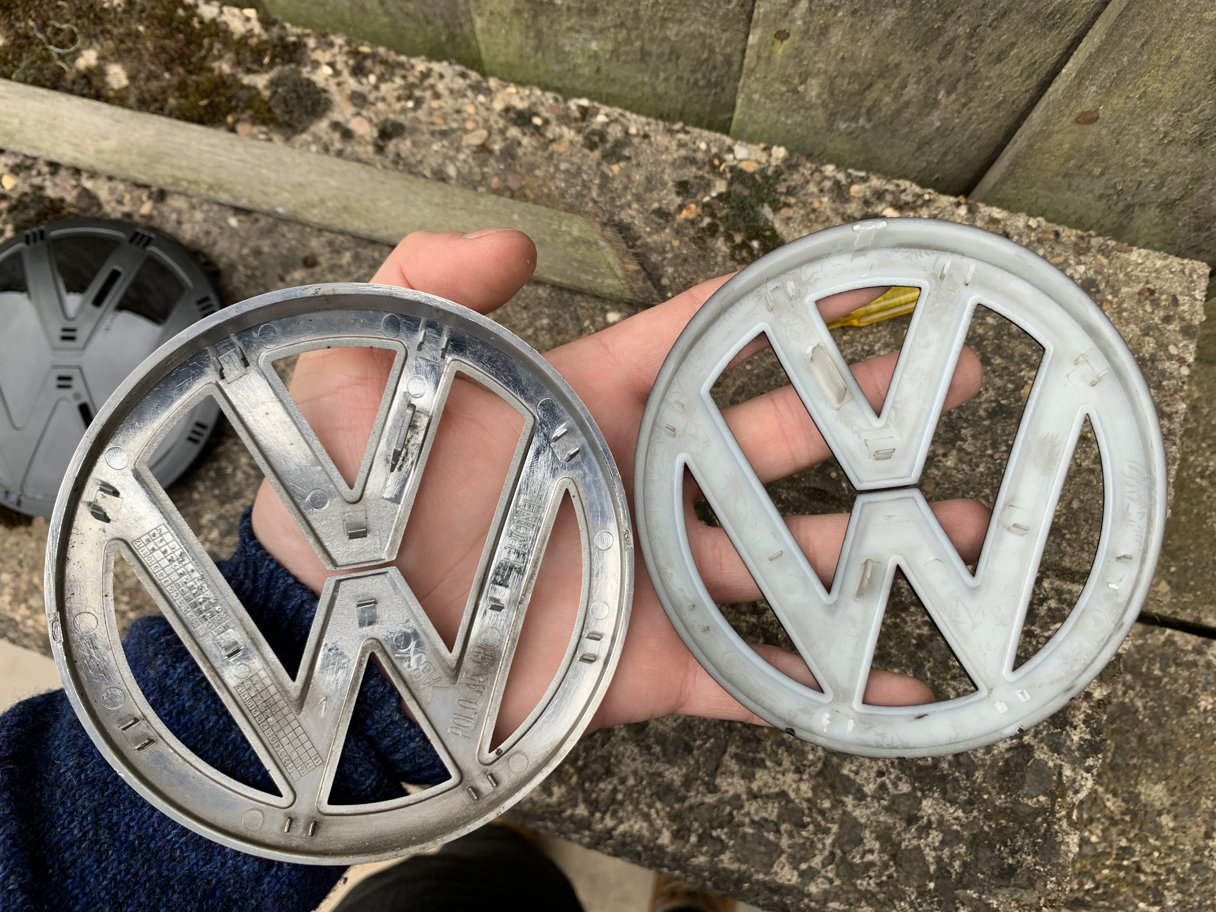

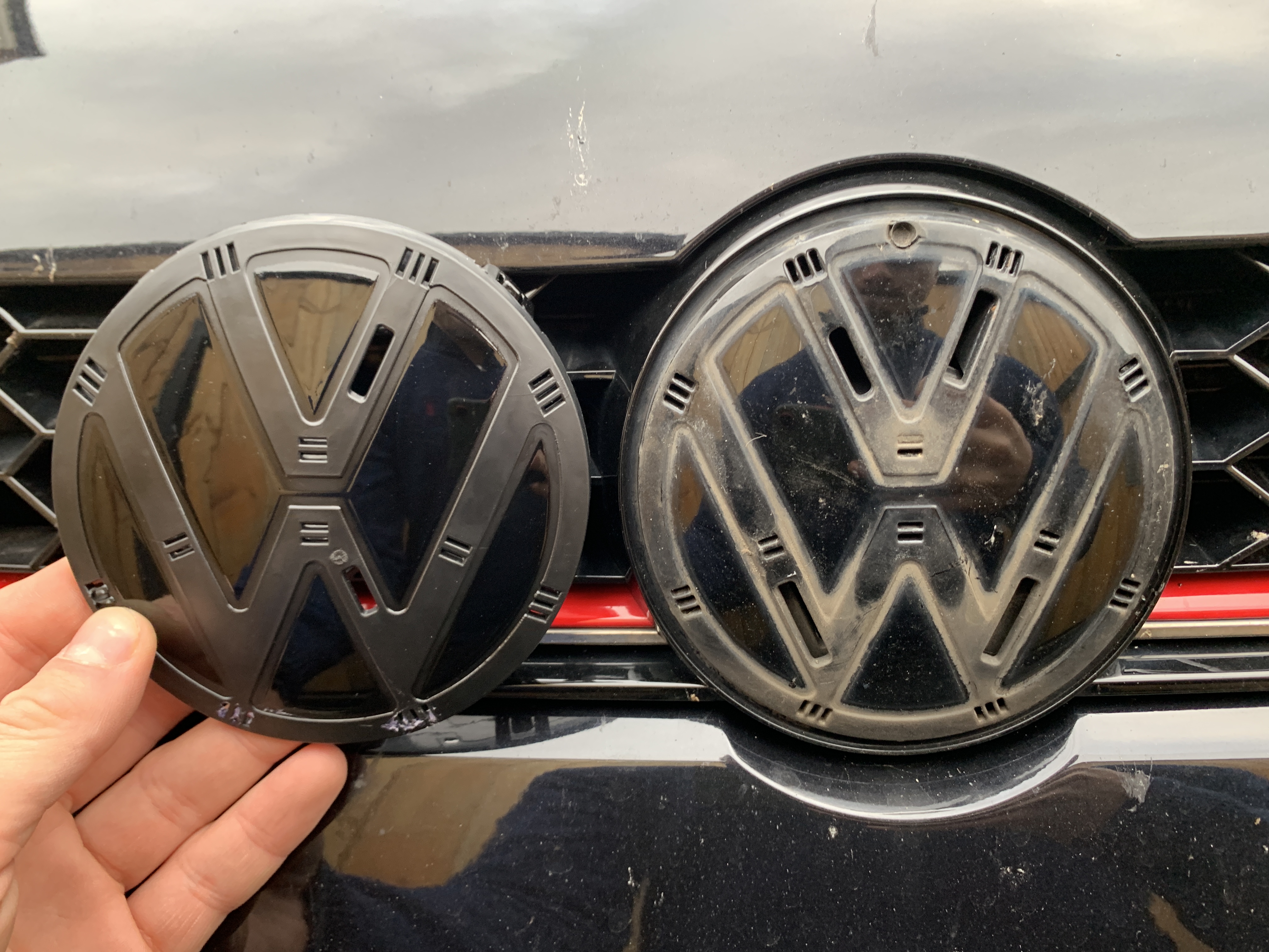

Re: 6C Badge Removal
I've just had a go at the front badge. The front portion popped off really easily with a flat head screwdriver. But there's a problem. The slots in the backing plate and the tabs in the badge itself are different on the new badge I've bought - so I'm going to have to take the front grill off to get the backing plate off because you can't get at the backing plate from the outside.
- IMG_3684.JPG (4.2 MiB) Viewed 5025 times
- IMG_3683.JPG (3.05 MiB) Viewed 5025 times
