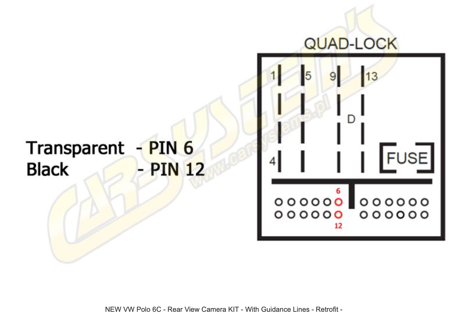

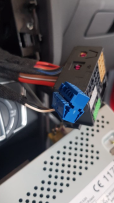

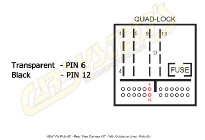

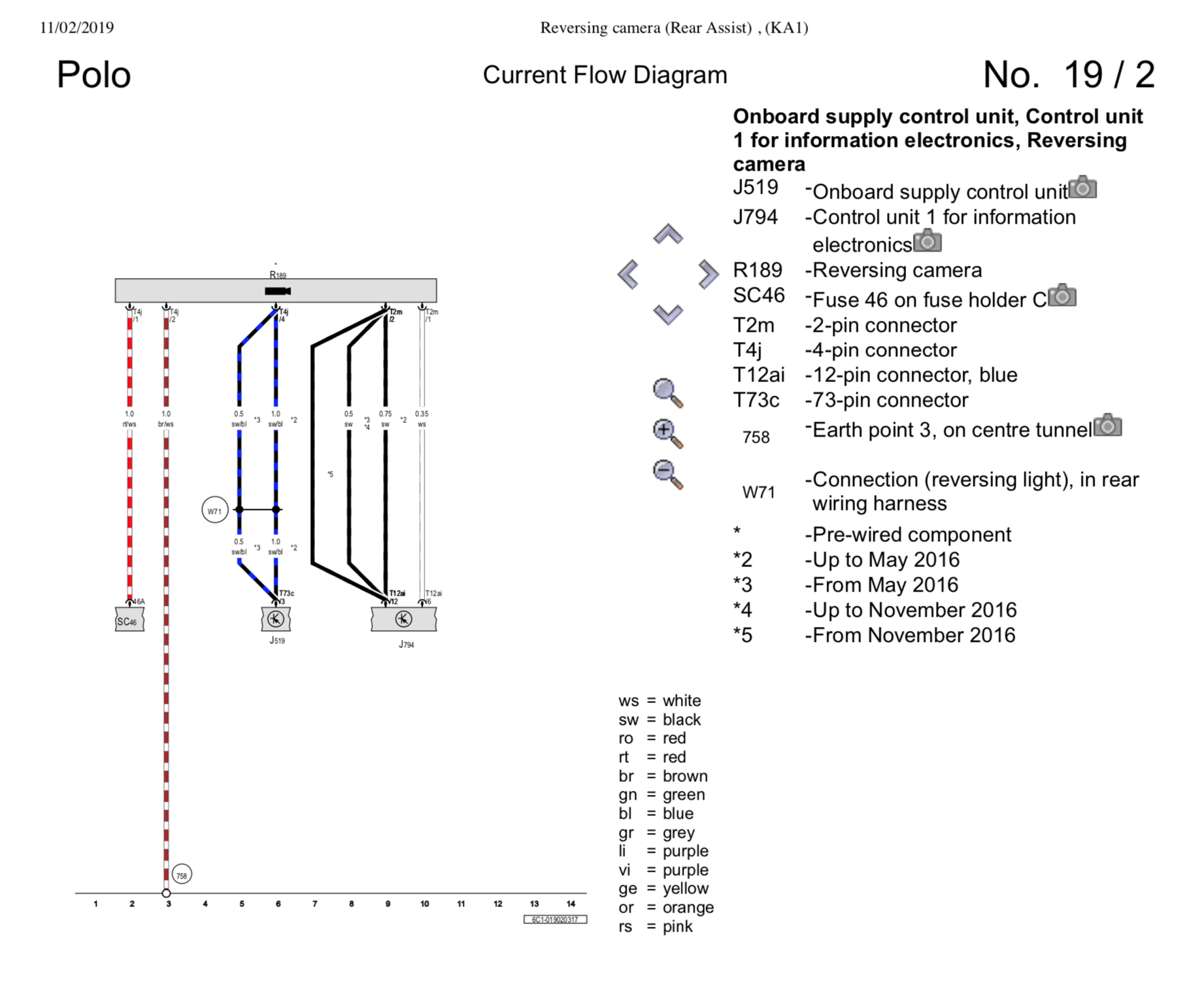

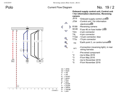

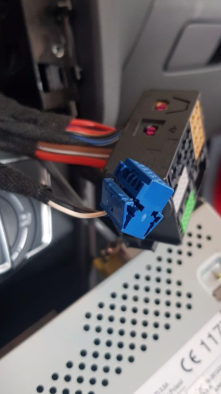

OK, I finally got to revisit this Rear View Camera installation this morning. removed the glovebox, slid out the "brains" located pins 6 & 12 on the green connector, etc. All good.
Made temporary connections for ground & power.
Then I revisited the VCDS coding.
Unfortunately I still have the same behaviour.
1) If I select RVC in the Infotainment module (Bit19 I think) the display re configures with a smaller image of the car and space for the camera image: but no camera image. But it just works for one "putting into reverse" cycle, and then displays "park assist not available" and no parking related screen displayed. (i.e no front/ rear sensors/ camera space). If I deselect camera in long code the parking screen reappears.
2) If I select RVC installed in "Park-Steer Assist" Module it has no apparent affect, either singly or in combination with 1) above.
So I have no proof that the camera works, but it probably does.
I strongly suspect the issue is coding related. I have done the coding , powered off, locked the car, had a cup of tea, etc, but behaviour is always the same
I can't find any other reference to camera in the VCDS.
What thoughts?
