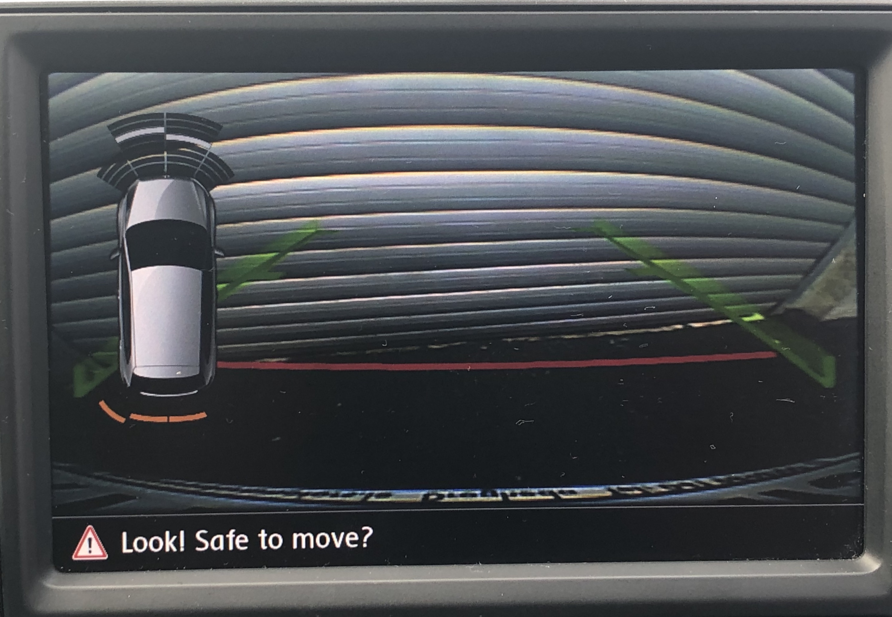

Hello
In a separate thread I detail the problem I have with getting an upgrade RVC camera to operate in Polo 6c with
Deos anyone here with VCDS have a Polo 6C with Front & Rear Parking sensors/ Navigation, but more particilarly with Rear Vew Camers (LOW)
This is the camera with fixed guide lines
viewtopic.php?f=56&t=73018&p=554183#p554183
This is the current Long Code for Infotainment unit
02720001BE00000051111101008808001F0100C601200100CF
This is the long code for Park/ Steer module
0031051001

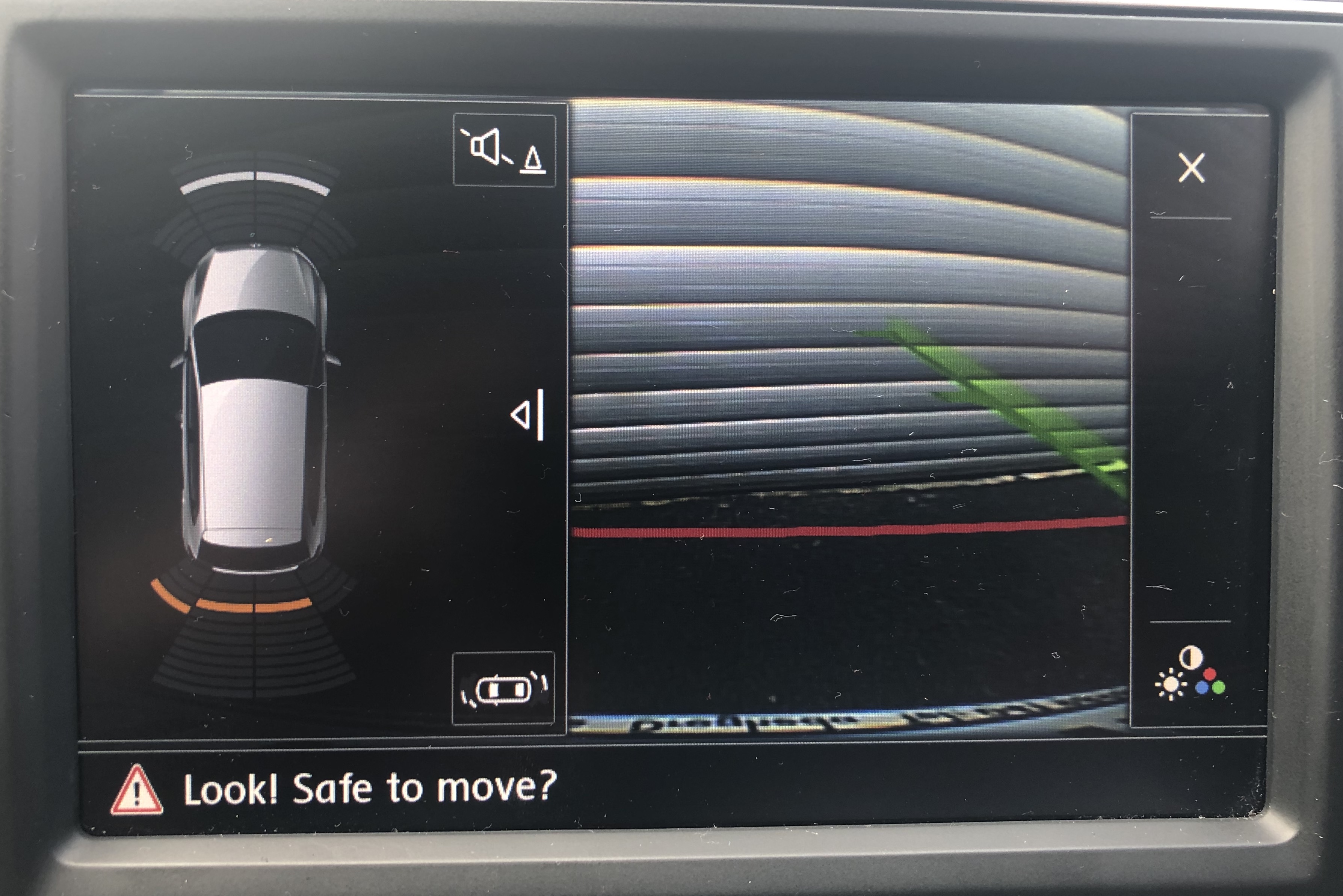

Hi there my coding for the 8K OPS and RVC for polo 2017 is ( Don't have navigation):
Address 10: Park/Steer Assist (J446) Labels:| 5Q0-919-294.clb
Part No SW: 5Q0 919 294 K HW: 5Q0 919 294 A
Component: PARKHILFE 8K H03 0054
Revision: -------- Serial number: 39331616502046
Coding: 0031151001
Shop #: WSC 00788 648 00255
ASAM Dataset: EV_EPHVA18AU3700000 002026
ROD: EV_EPHVA18AU3700000_VW26.rod
VCID: 43D2BACECB12EF2FC3F-8016
Long Coding - Byte 02 Bit 4 enabled for RVC Low

In 5F - Information Electronic Unit -
Address 5F: Information Electr. (J794) Labels:| 5G0-035-MIB-STD2.clb
Part No SW: 3Q0 035 824 B HW: 3Q0 035 824 B
Component: MU-S--ER H30 0367
Serial number: VWZAZ2S0301324
Coding: 02620000AA00000051110003000808001F0210D60120010003
Shop #: WSC 12345 123 61029
ROD: EV_MUStd4CTSAT_VW26.rod
VCID: 2C00F172468C0057125-8078
Operating And Display Unit 1:
Subsystem 1 - Part No SW: 6C0 919 603 B HW: 6C0 919 603 B
Component: ABTm_Std2 H53 1031
Serial number: VWZ8Z9SKW00Y3K
Long Coding - Byte 19 Bit 4 enabled for Rear View Camera Low
in Adaptions:
In Vehicle_configuration:
RVC_video_input: FBAS
rvc_low_black_screen_velocity_threshold: Not activated
rvc_low_failsafe: Not activated
rvc_low_black_screen_trunk_open: Not activated
Pilot_Parking: Not activated
OPS_display_in_dash_board_display_unit: Off
Car_Function_Adaptations_Gen2:
menu_display_pdc: activated
menu_display_pdc_clamp_15_off: Not activated
menu_display_pdc_over_threshold_high: activated
menu_display_pdc_standstill: Not activated
menu_display_pdc_after_disclaimer: Not activated
Car_Function_List_CAN_Gen2:
PDC_audio_lowering: available
PDC_audio_lowering_msg_bus: Suspension data bus
Car_Function_List_BAP_Gen2:
parking_assist_0x0A: activated
parking_assist_0x0A_msg_bus: Terminal 15

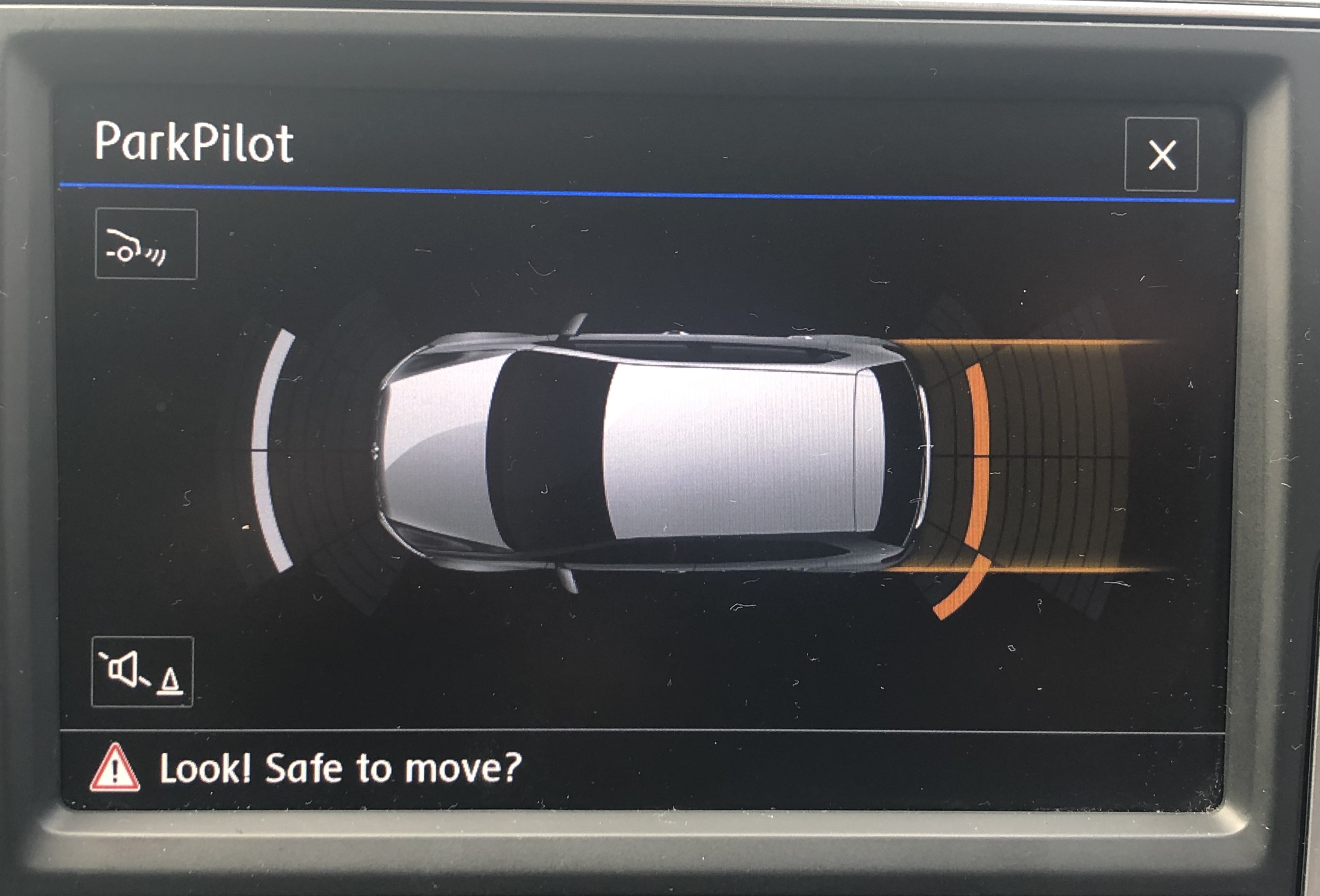

massimo23
Posts: 121
Joined: Sun Nov 18, 2018 1:57 pm
Drives: Polo Beats 2017
Location: Ireland
Re: Does any have a 6C Scan with Park sensors & Rear Camera (low)
Post by massimo23 » Sun May 12, 2019 2:36 pm
Here is some photos of Ops with RVC when reverse gear is engaged:
