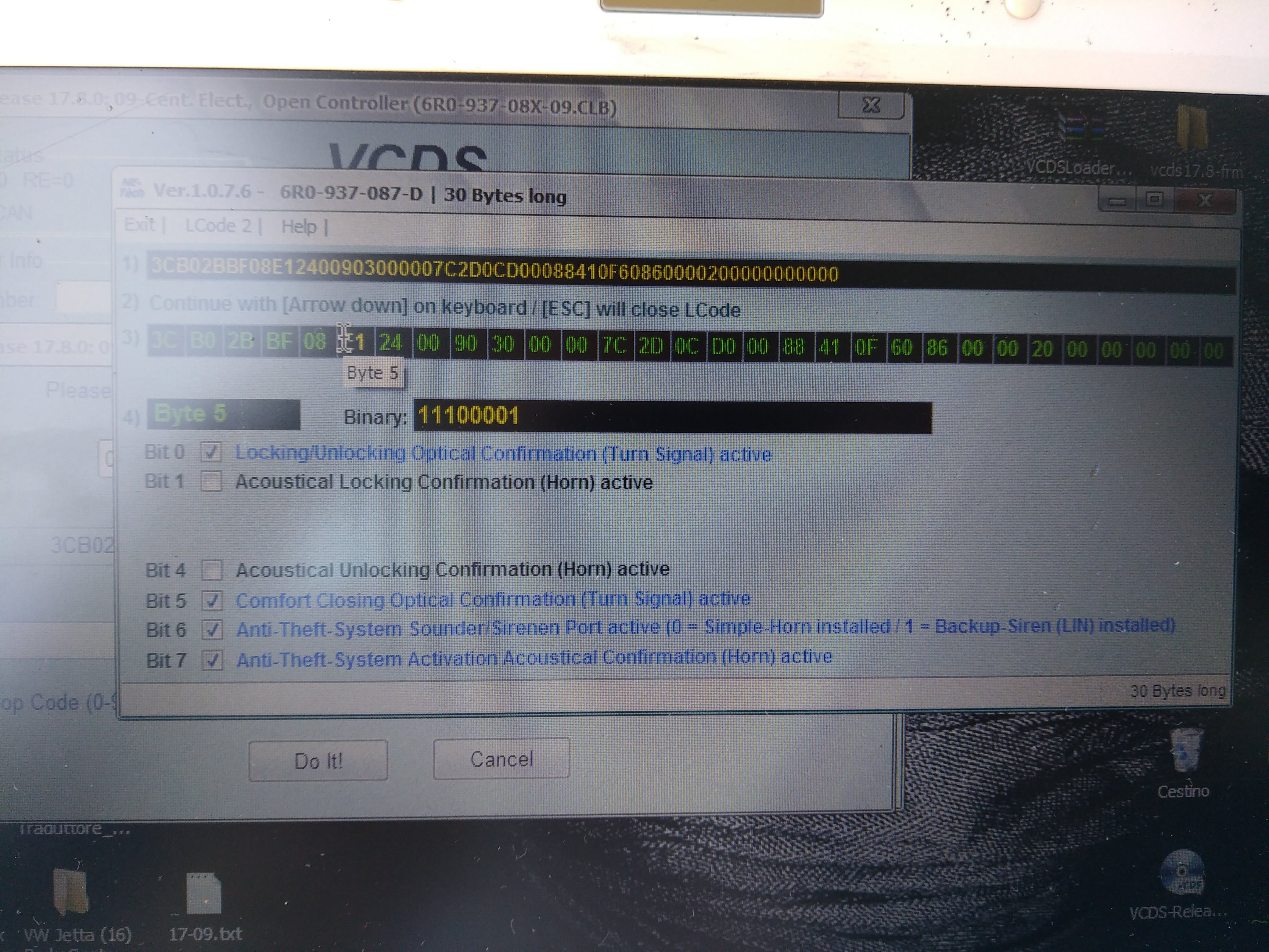

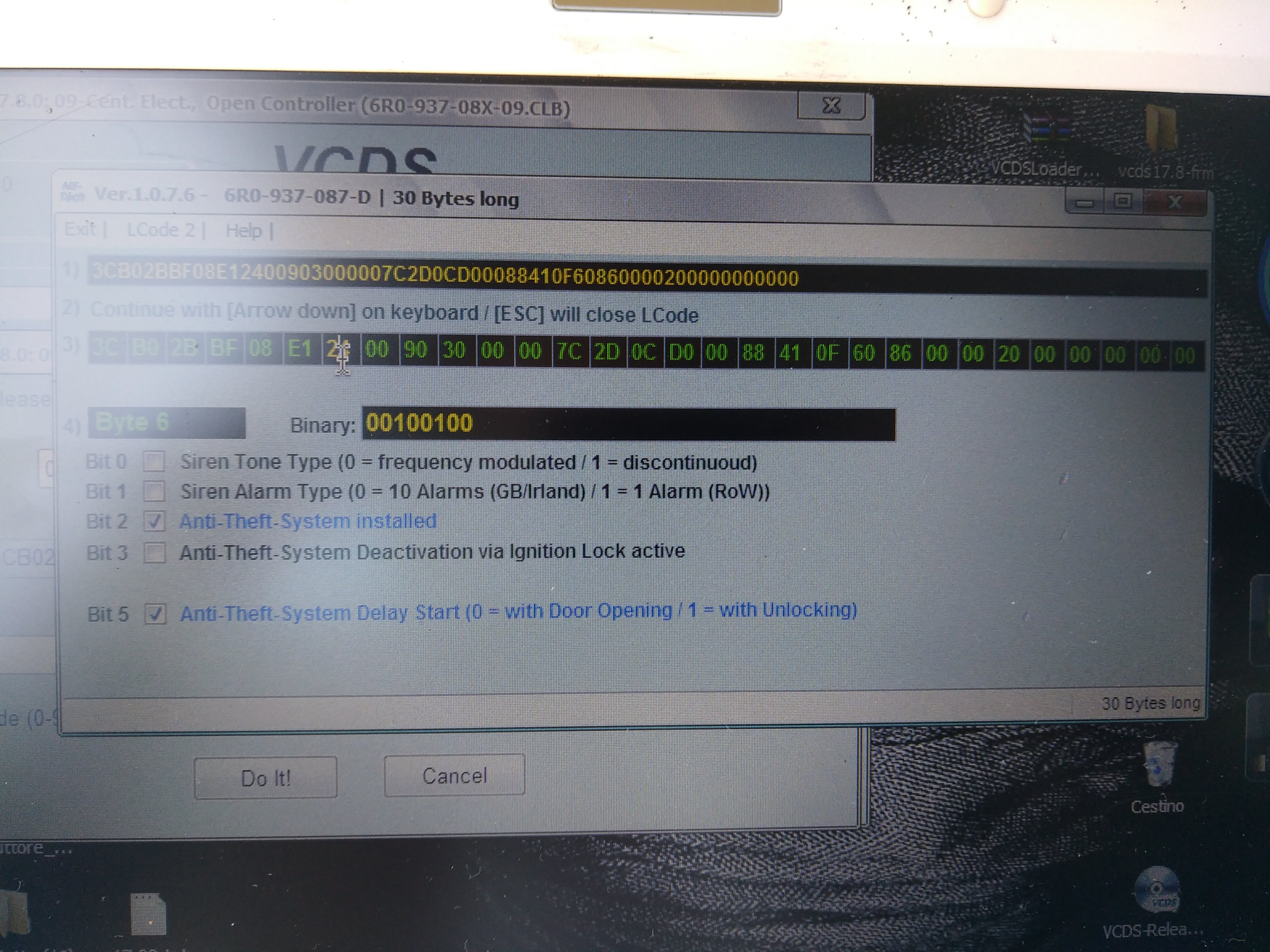

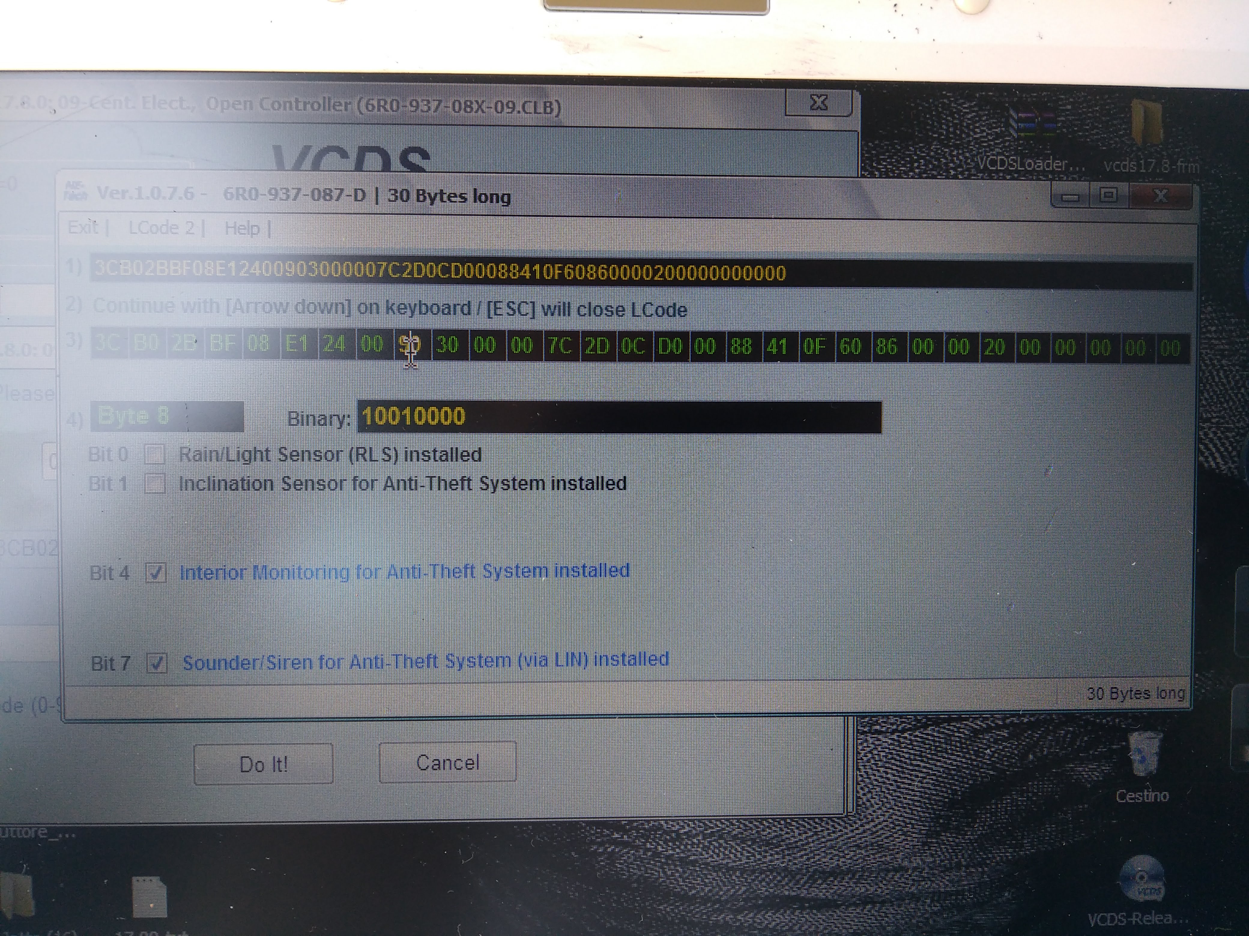

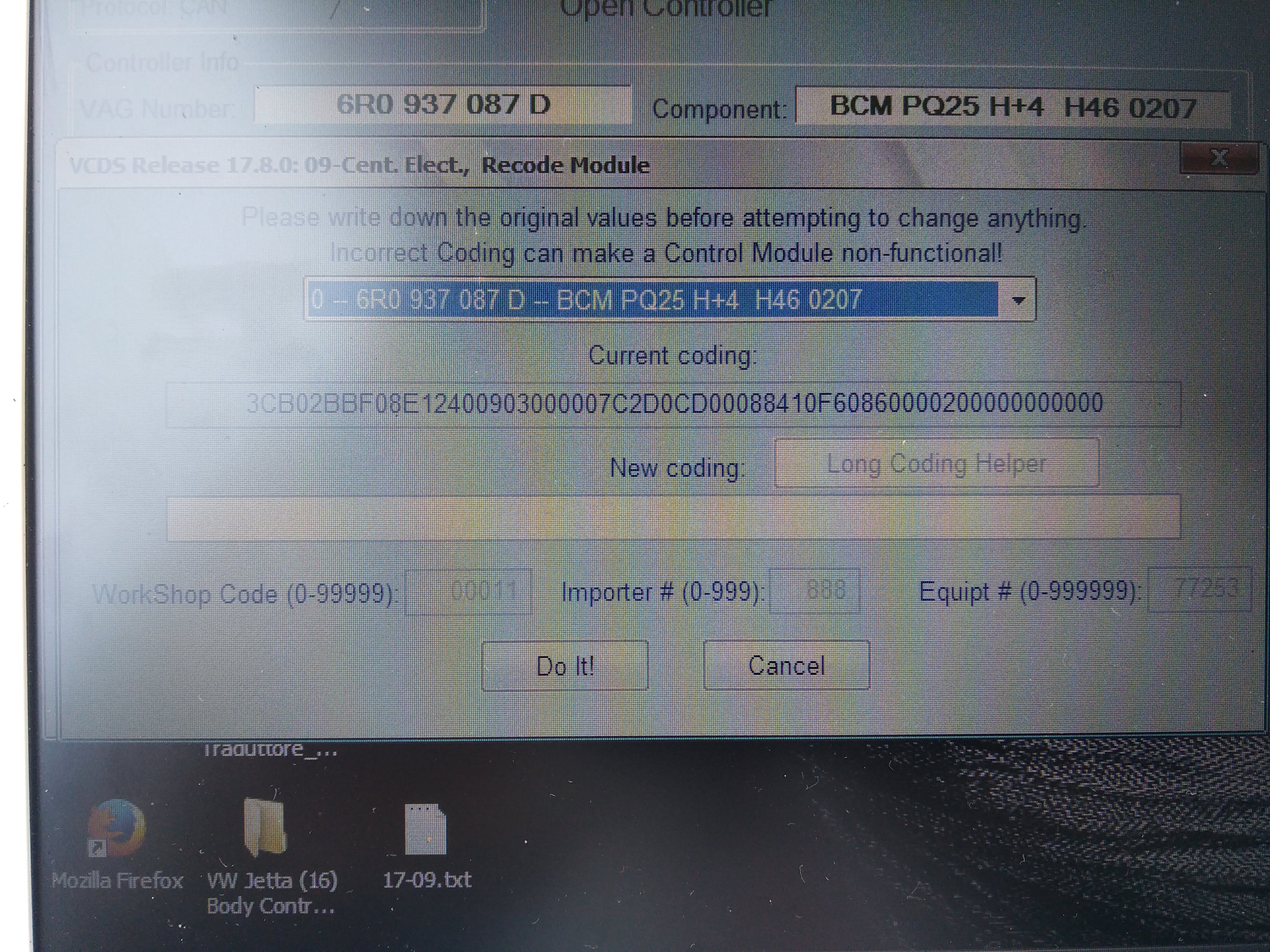

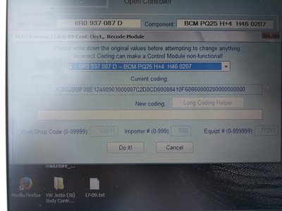

hello guys, I installed the original volumetric alarm on my 2010 6r polo (sensors + siren + button), the alarm works, I wanted to know the various settings below:
siren alarm type:what changes between the rest of the world / england-ireland?
http://wiki.ross-tech.com/wiki/index.php/01044
do I have to select an alarm in the gateway? (now I'm seeing this possibility I hadn't thought of it) or should I do something else? the best coding to make the siren sound as high as it would be? thank you
siren tone type : Does the sound vary if continuous or discontinuous?Anti-theft system info

Ireland/row has something to do with the duration of the alarm.
Can you show a full scan please?
- Posts: 5859
Re: Anti-theft system info
Yes, I was going to reply with that comment, I think that Ireland/UK is that the sounder only runs for something like a 1 minute or 2, then stops running, checks status and if still armed sounds again for 1 or 2 minutes and so on.

Chassis Type: 6R-VW25 (6N0) ->[color=#FF0000]6n0?[/color]
Scan: 01 03 04 08 09 15 17 19 25 44
VIN: WVWZZZ6RZAYXXXXXX Mileage: 74150km-46074miles

Part No SW: 6R0 937 087 D HW: 6R0 937 087 D
Component: BCM PQ25 H+4 H46 0207
Revision: BF046001 Serial number:
Coding: 3CB02BBF08E12400903000007C2D0CD00088410F60860000200000000000
Shop #: WSC 00011 888 77253

Subsystem 3 - Part No: 1K8 951 171 A
Component: DWA-Sensor 00 001 0103
Coding: 000000 [color=#FF0000]coding all 0?[/color]
Subsystem 4 - Part No: 1K0 951 605 C
Component: LIN BACKUP HO H05 1501
Subsystem 5 - Part No: 1K8 951 171 A

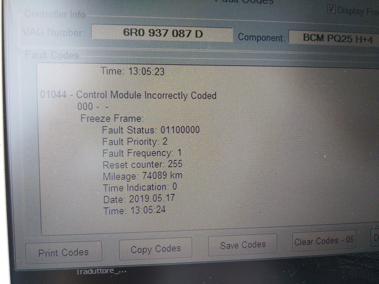

01044 - Control Module Incorrectly Coded [color=#FF0000]there is[/color]
000 - -

it seems that the error is because the siren and the two sensors have all the coding at 0 .... but how are they coded and what should their coding be
