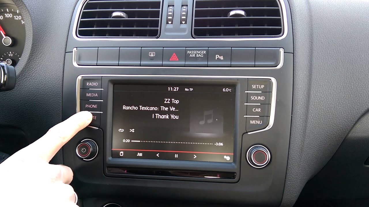

I think Sept 2014 is about the changeover time from the 6r to 6c, so the OP’s car could be one of the last 6r’s or an early 6c.
There are a few interior and exterior visual differences between the 6r and 6c - some of these are hard to spot as they’re quite subtle - the design of the reflectors in the headlamp units and the internal design of the tail light clusters are slightly different, and the lower front grille design is also different between the 6r and 6c. To check out the differences, I’d suggest the OP does a google search on a 2010 Polo which will be a 6r and a 2016 Polo which will be a 6c and compare the two.
The infotainment unit is one of the more noticeable interior differences between the 6r and 6c. This picture shows the infotainment unit design in the Polo 6c; The 6c also has either nine buttons for various functions (heated rear screen, hazard warning flashers, stop start override etc) above the infotainment unit or six buttons and two horizontal card slots above the infotainment unit. The 6r has seven buttons above the infotainment unit screen.
Hopefully, the above, together with the information in RUM4MO’s post will help the OP identify whether their car’s a 6r or 6c.
