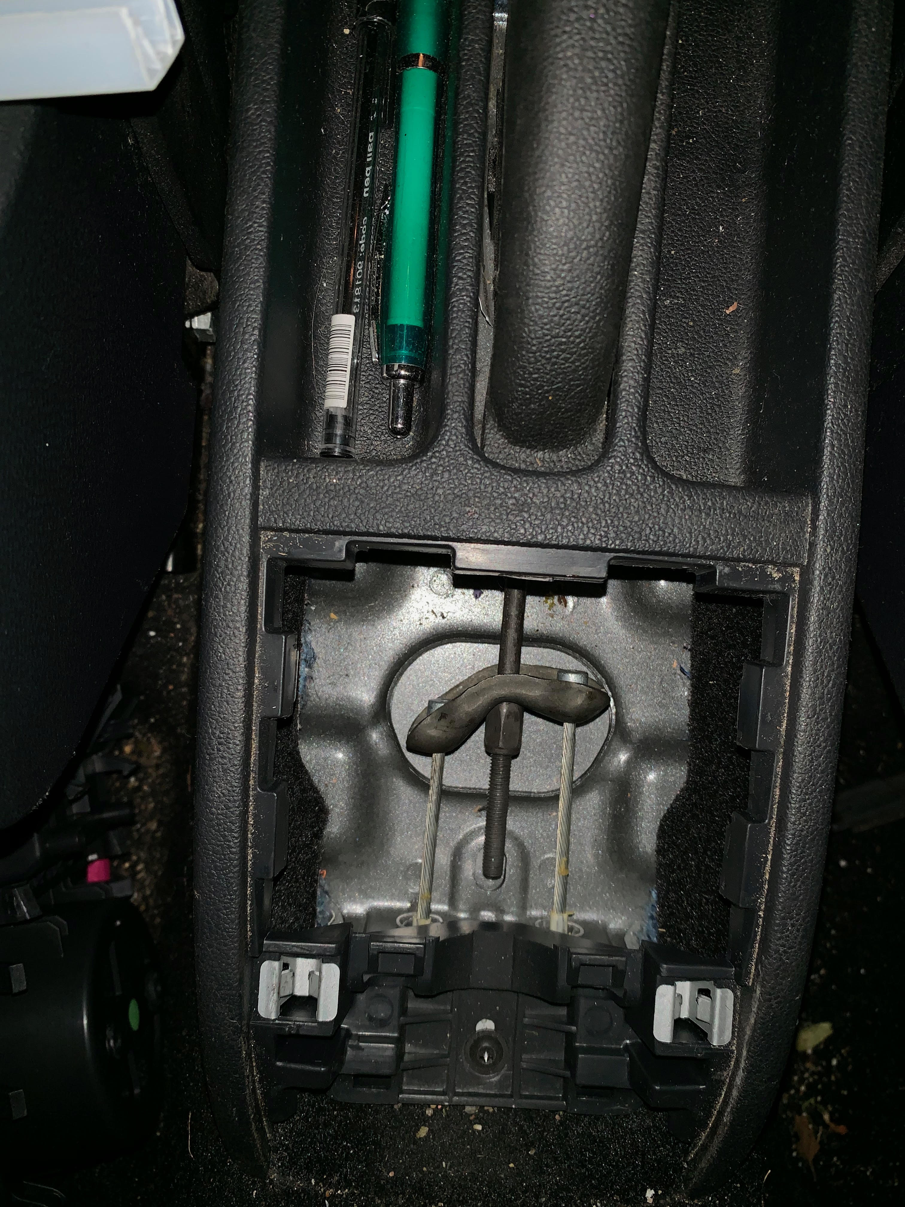

The yoke is at an angle, With the right side clearly pulling up more than the left. Despite slacking the nut off, setting the auto-wear adjustor back to the thinnest part of the wedge and then pressing the brake pedal, the yoke stays at the angle in the pic. I don't know if this is a normal angle, if the cable is stretched, or if it is the cause of the right side binding first (seems to me, the last is more likely]. I tried holding the left side wedge up with a screwdriver while letting the right side auto adjust first, but that didn't work. It did correct itself once, but could not get it to that again...

Yes when the equaliser yoke ends up like that things are not right!
