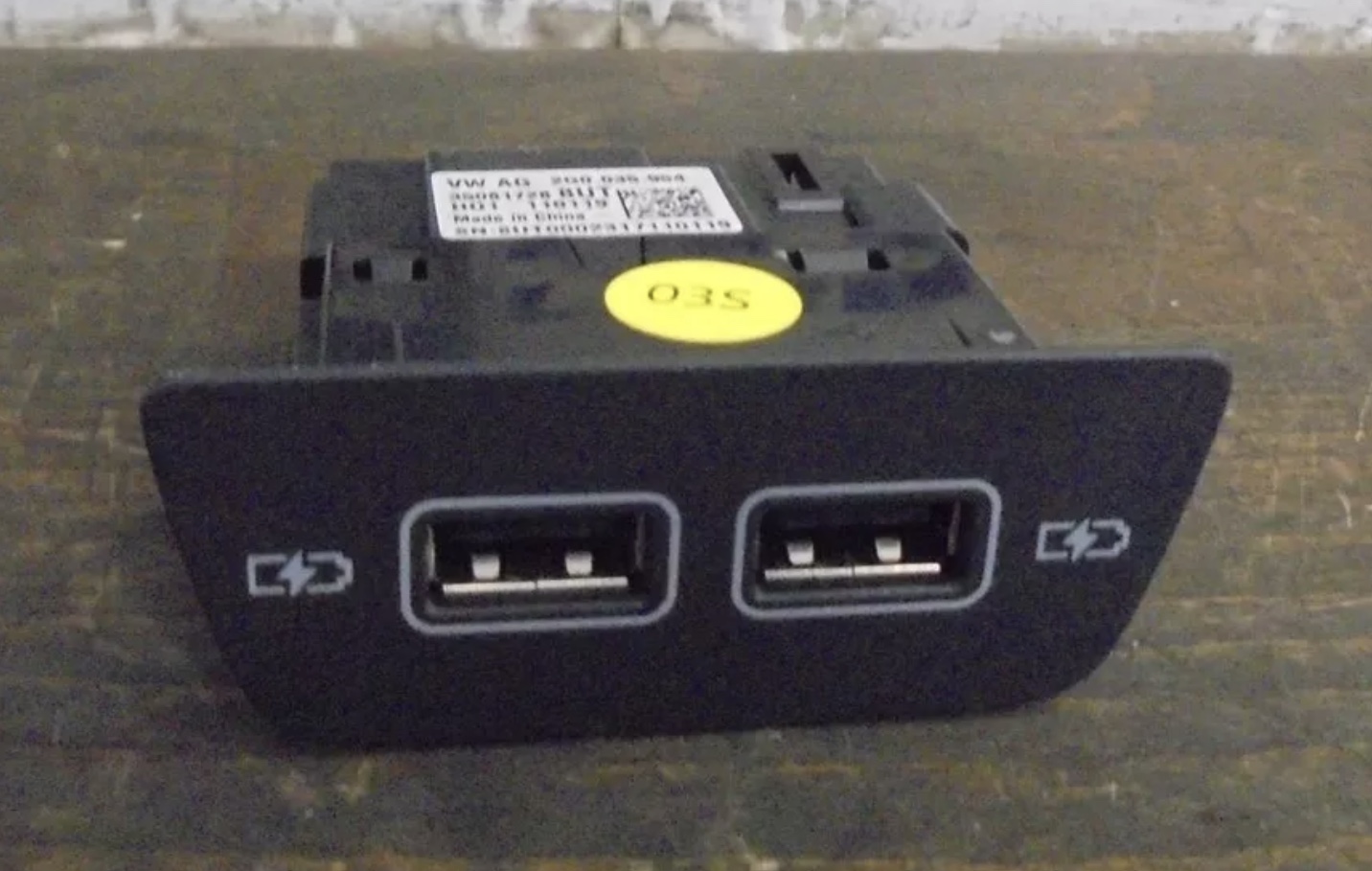

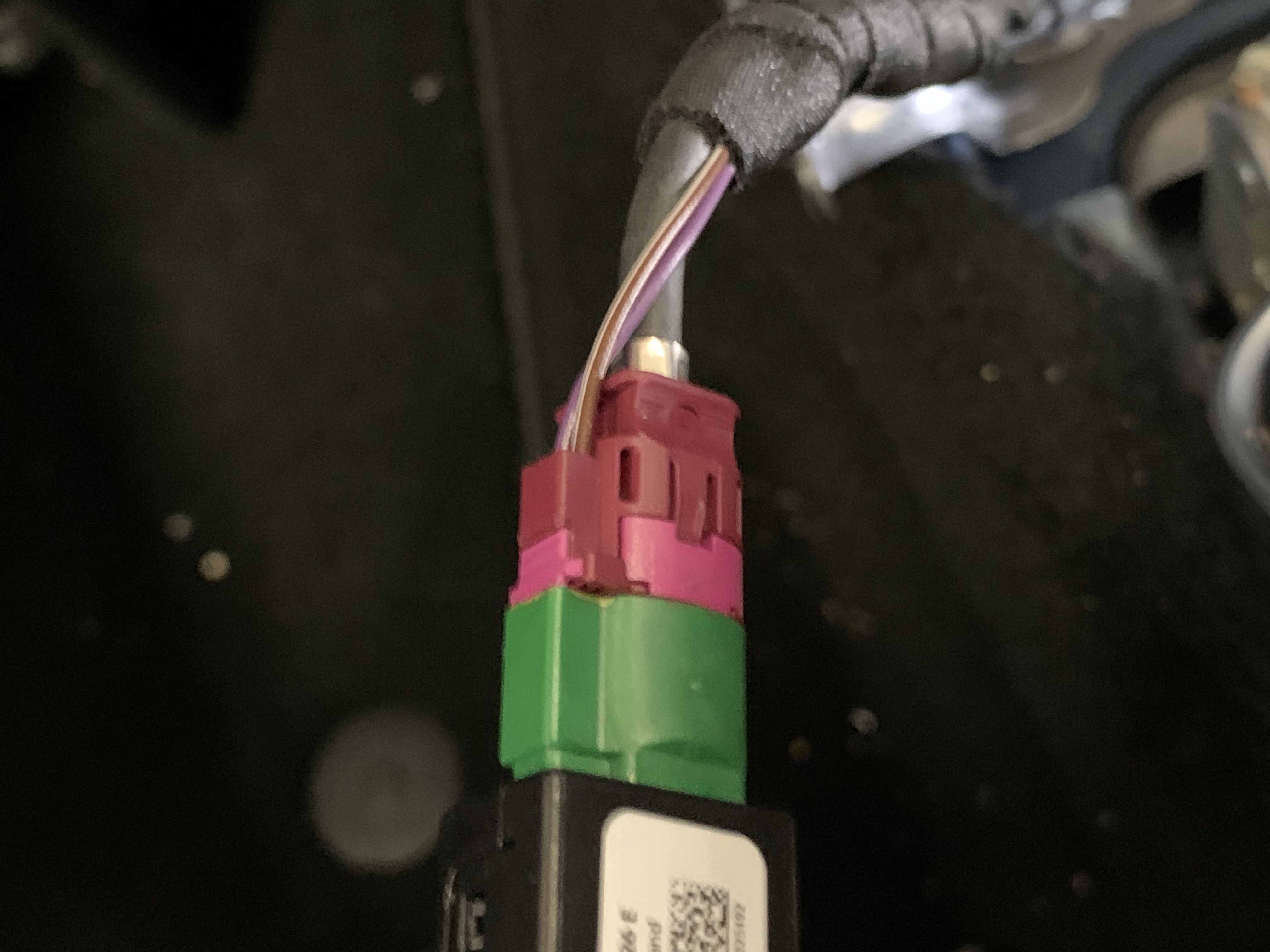

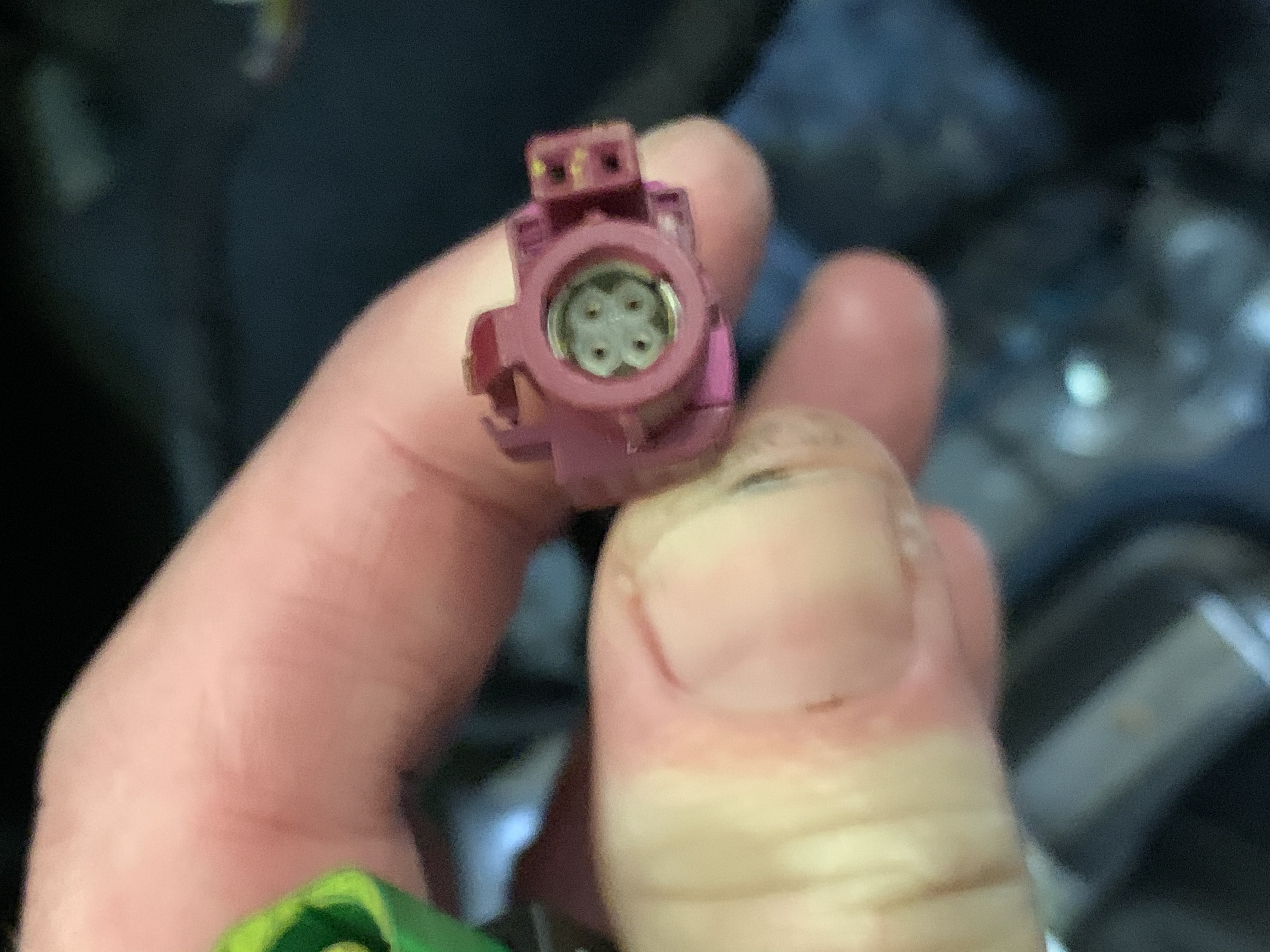

So I received a new green socket new 2017 version 5Q0035726E in the post yesterday, not facial fitting to try and get my Apple CarPlay working.
Now my car has mib2 but being 2014 only a red socket fitted when new, not compatible with CarPlay.
So the cable connection is polarised for a red socket by 1 edge preventing fitting to the green socket, bar that identical in wire orientation.
So I trimmed this off to allow trail of the system.....
Red con 1
Red con 1
Red con 2
Red con 2
Red con 3
Red con 3
Red con 4
Red con 4
Red con 5
Red con 5
Completed connection
I fired up the car and success! Apple CarPlay fully operational

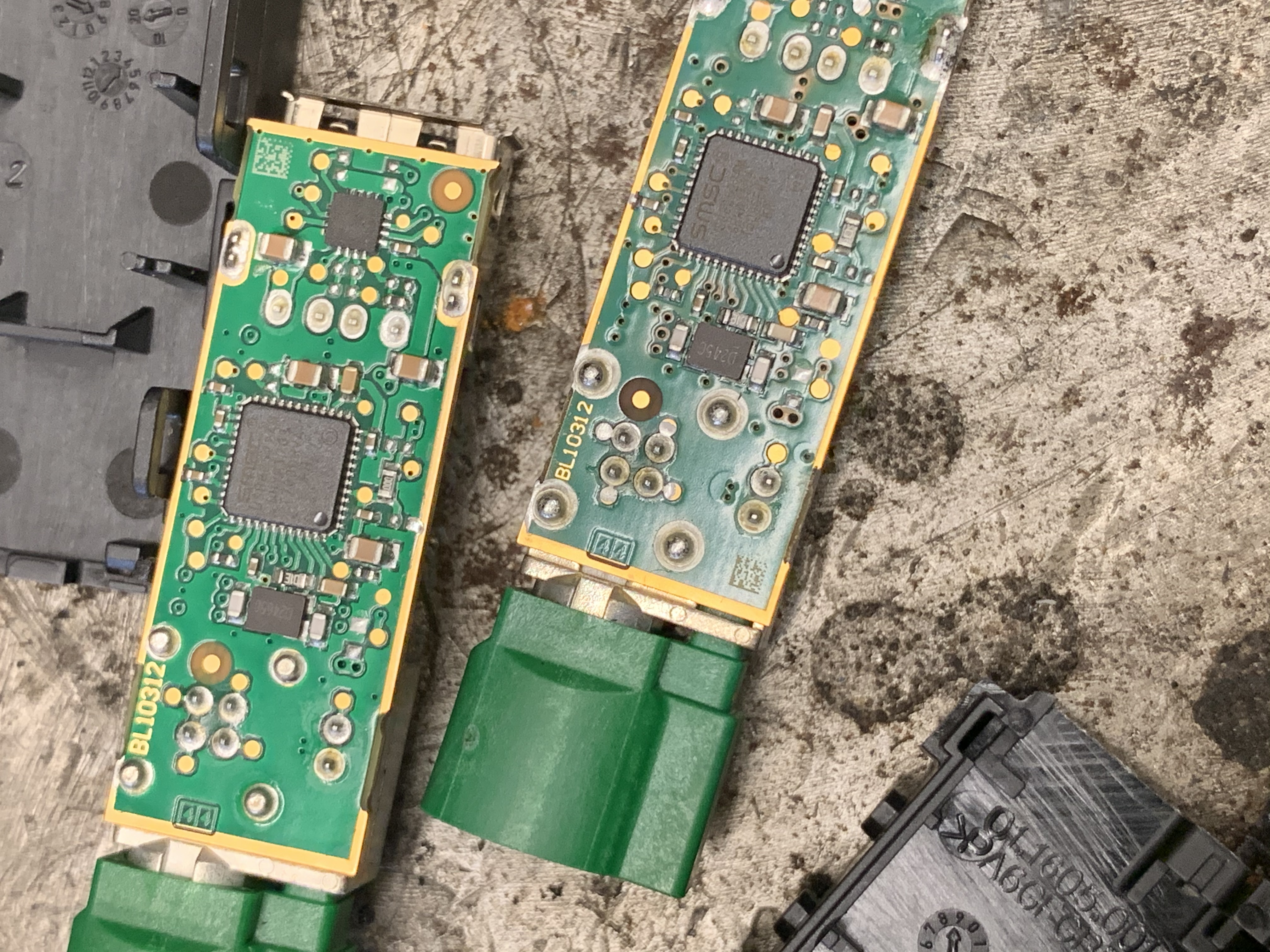

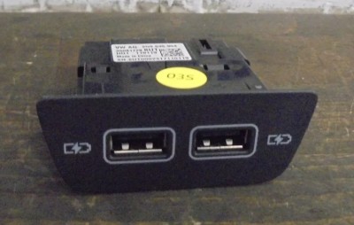

So the other usb socket arrived today which has the surface mount format.
Decided to compare the 2 units and ends up they have identical inner boards so here is the info in the pics folks for info.

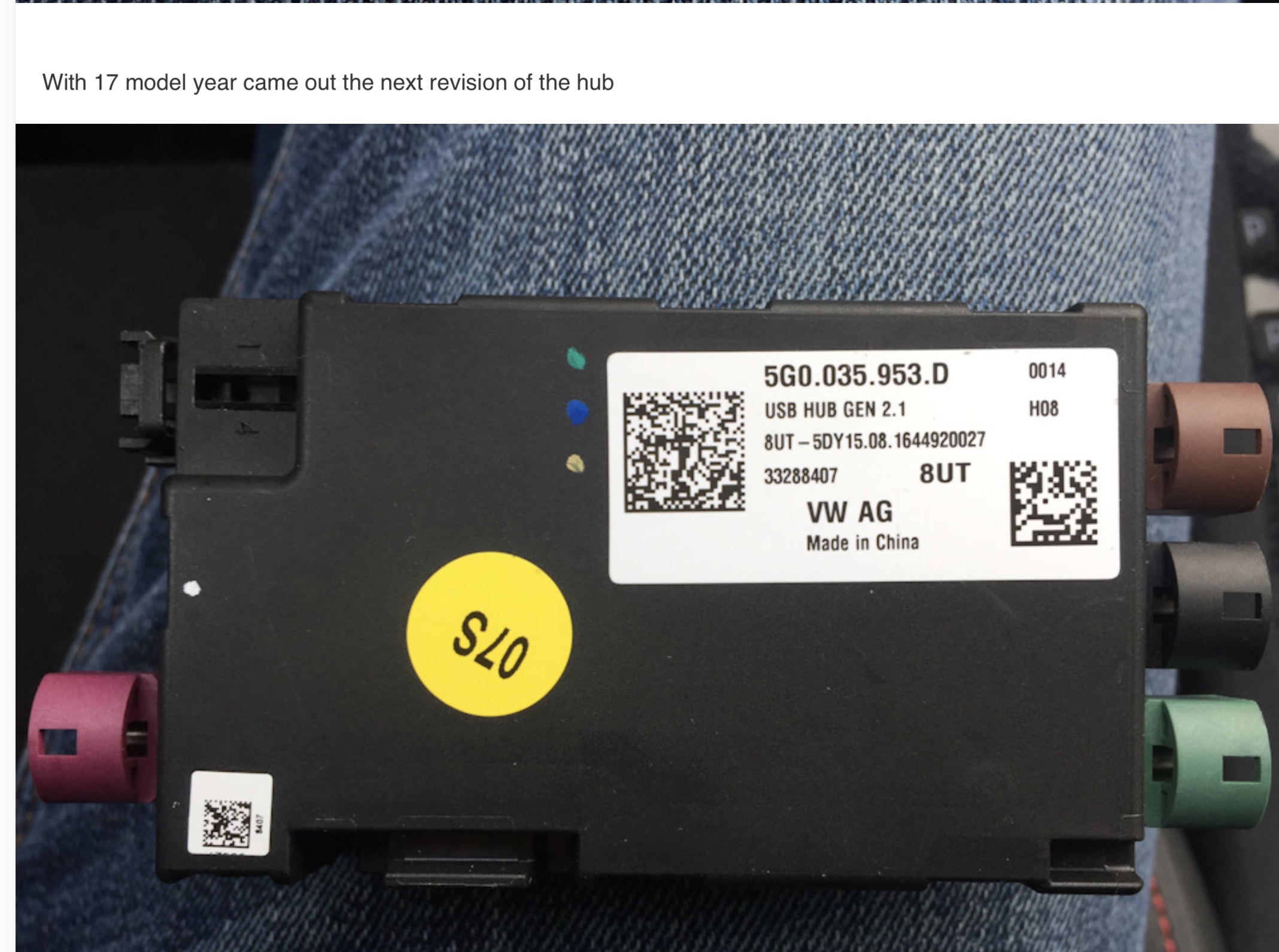

Anyone got a 2017 wiring guidance for the usb hub power 4 pin connector?
17 3 port hub usb

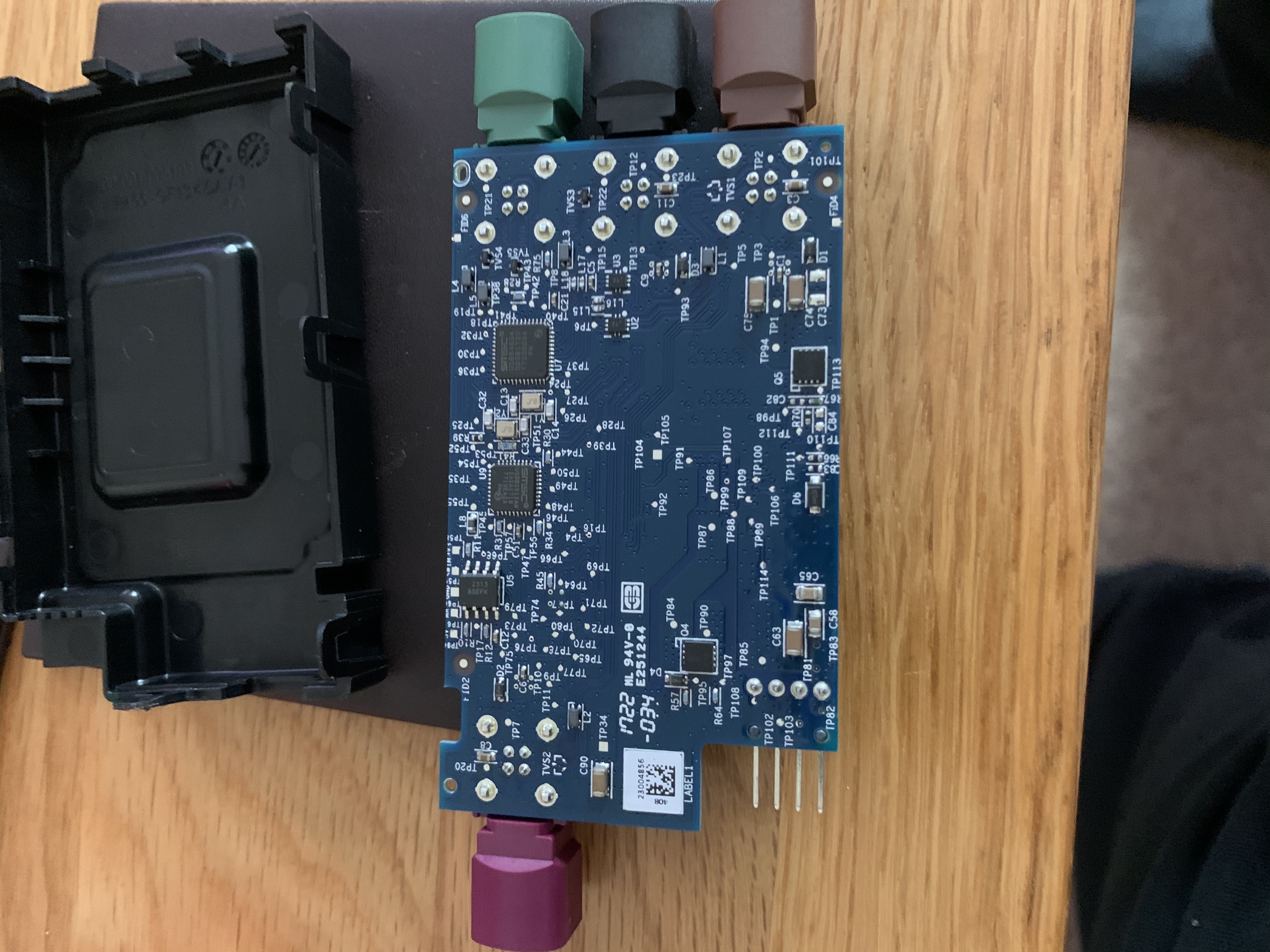

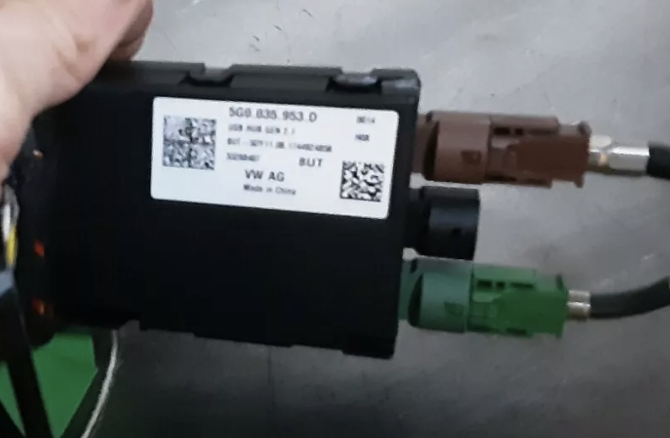

So the hub arrived and this is what it looks like close up
Just need to see if anyone can help work out the 4 pin connections
As this is the only info I have found.....

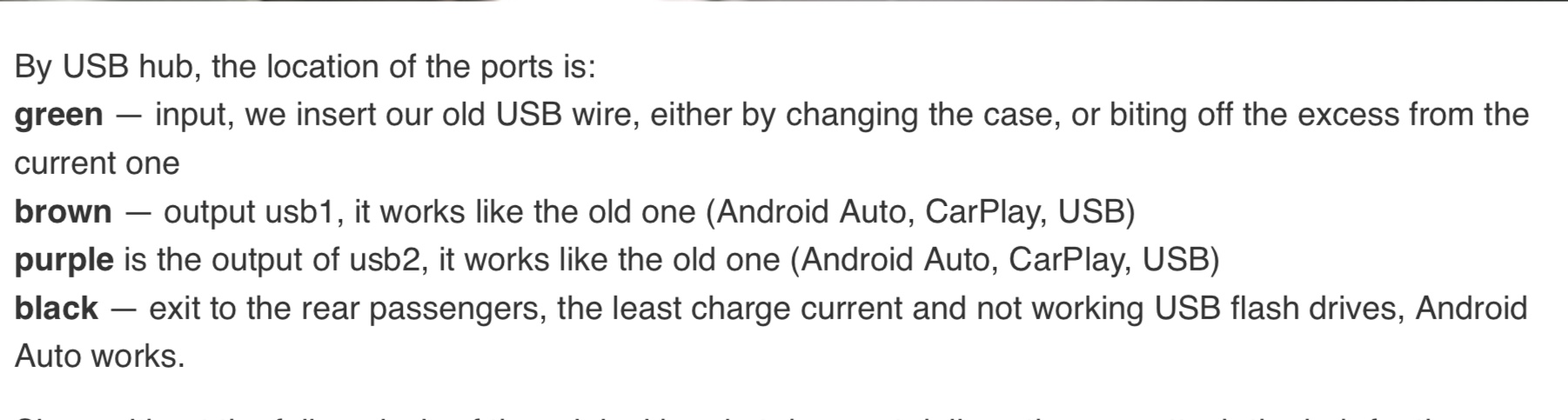

So after several hours of travelling the internet I found this which makes more sense,
Pin 1 - 12 volts
Pin 2 - earth ( taken from usb earth feed)
Pin 3 - n/a
Pin 4 - media unit =5 volt ( taken from original usb power feed)
The unit connections of the actual Fakra ones are
I need to get my hands on 3 A type Fakra 4 pin cables to allow me to plug the 3 socket in.

Reason we have to change the usb sockets also now identified, however if a cable mod is done the same sockets also will work
Cable mod is to rotate 180 deg and make it refit the plug
