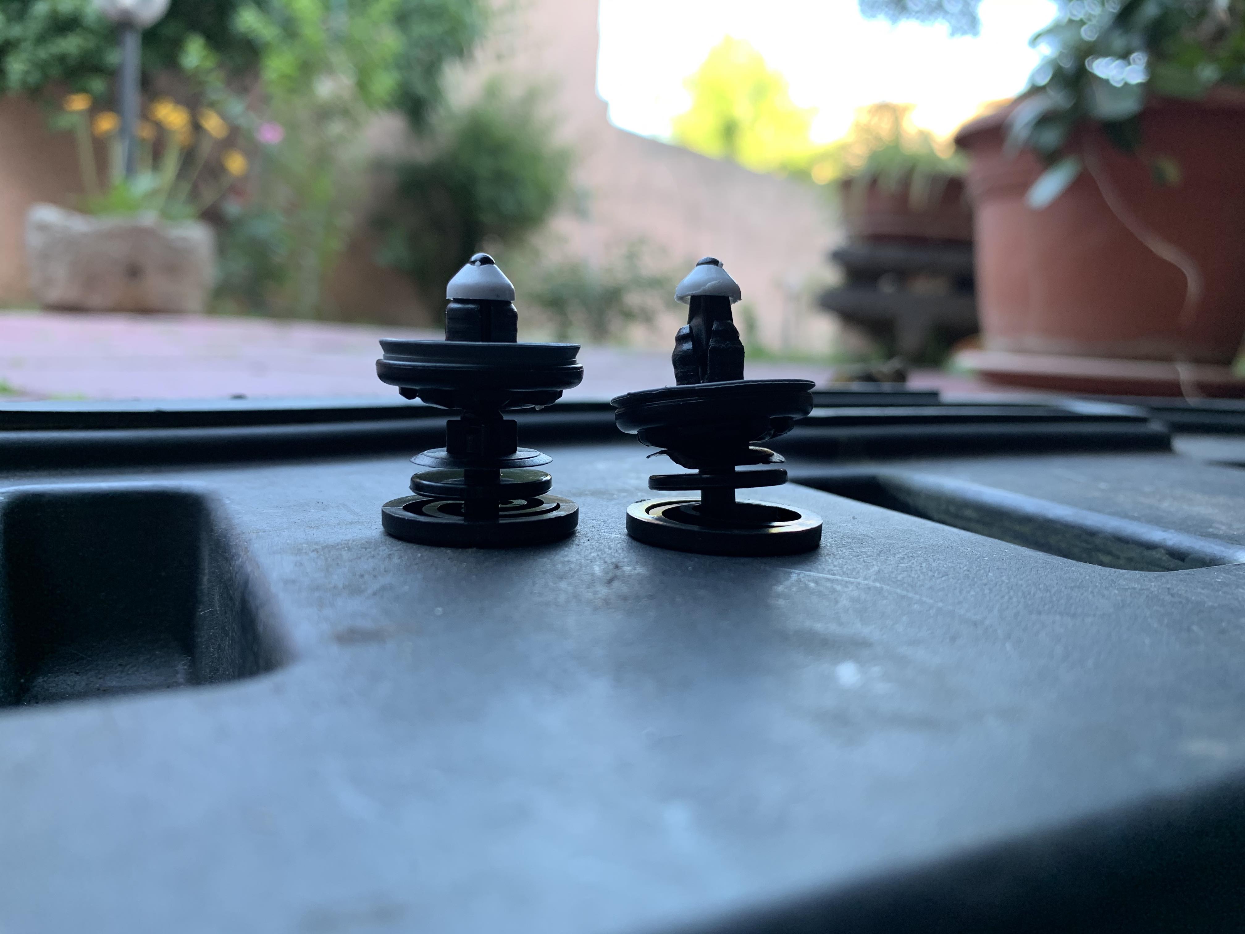

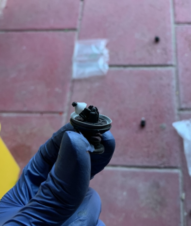

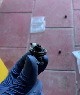

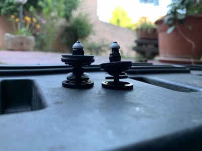

Just a few quick updates
1) After 3-400km and a new bleeding with vcds the brake pedal got back to the original feedback and now is the same as the original ones
2) I've coded the steering into dynamic mode (seems to be a bit harder and maybe precise but I'm not sure about that)
3) All the door panels now have new clips (original and not the cheapest version which were installed previously) and this is the difference
But at this point I have a question... with 312mm front brakes is possible to fit a 16" et43, 6.5j spare tyre? Or it wouldn't fit and touch on the caliper?
