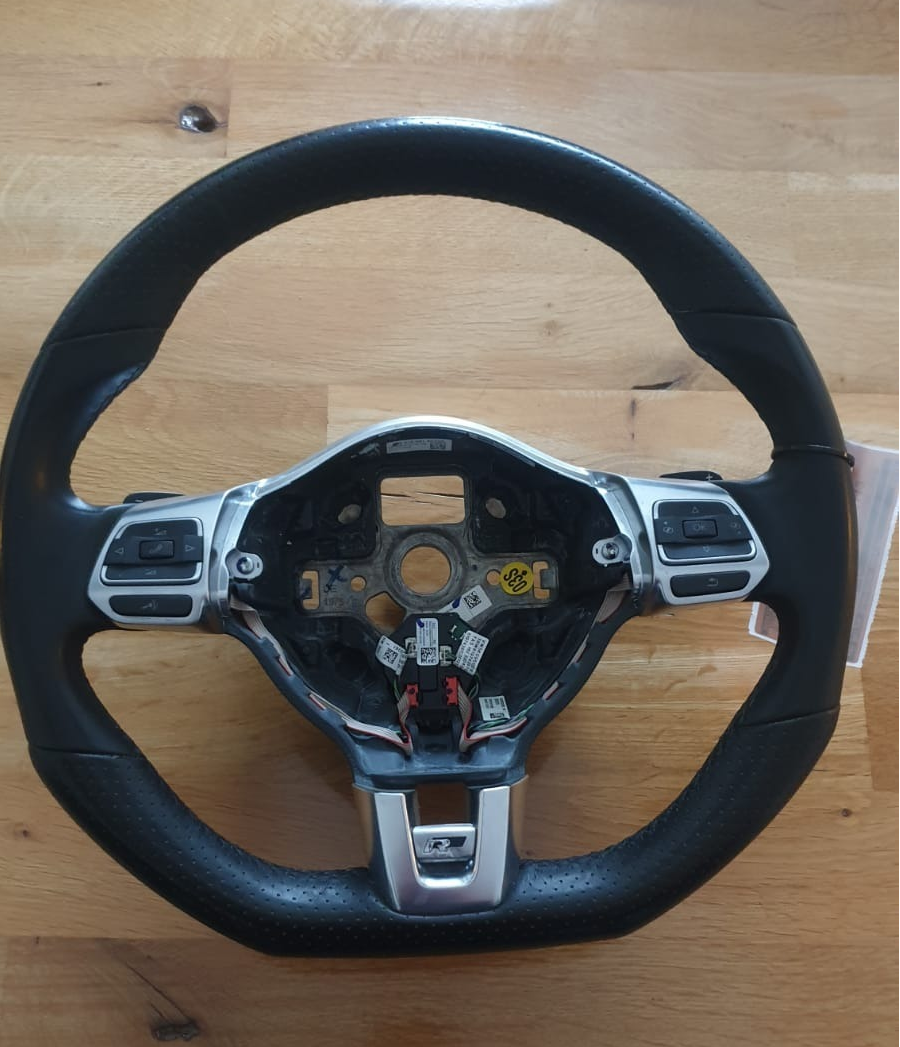

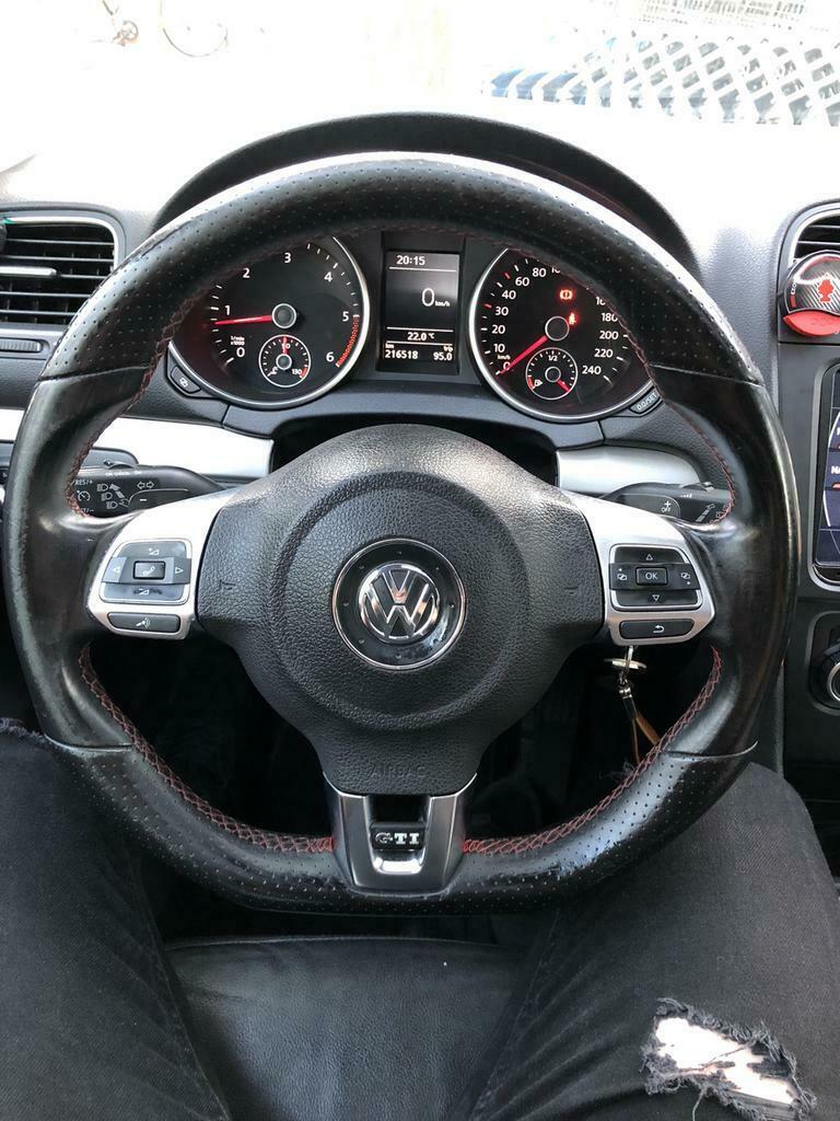

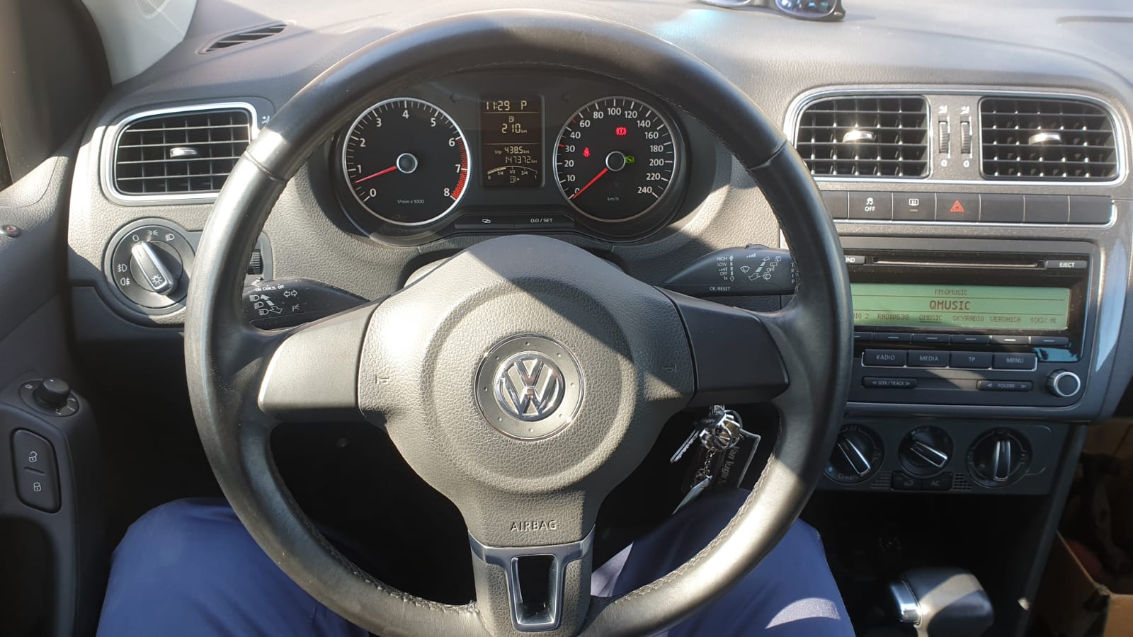

Goodday everyone,
I would like to change my steering wheel to one with steering wheel controls and paddles.
Now I have one in view of a Golf 6 GTI.
However, I am not sure if it will work without upgrading the BCM.
I know I have to put the 2 wires to make the buttons work
And I have some more questions.
When I have built in the steering wheel.
what do I have to do to get the paddles working?
Can someone tell me if the Polo 6r airbag fits in a Golf 6 gti steering wheel?
I would like to hear from you
My polo is a 6r 1.2TSI DSG from 2010
I also added 2 photos. 1 from my steering wheel and one from the seller

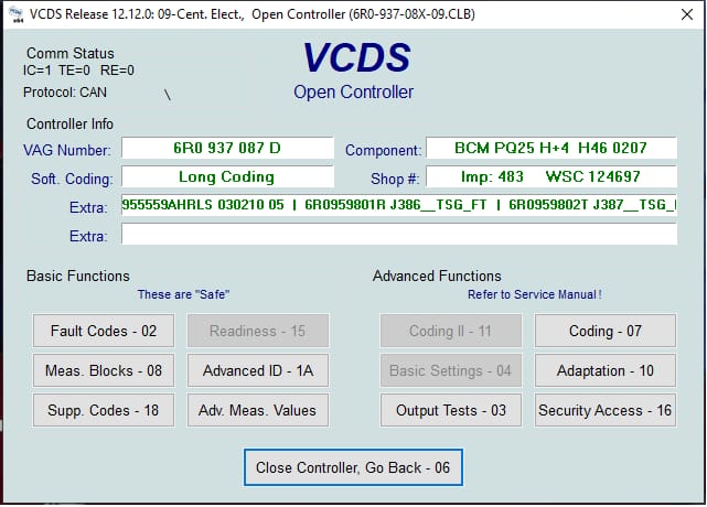

Here by an picture of the BCM
I hope its enough/usefull
Just in case
Vag number: 6R0 937 087 D
Component: BCM PQ25 H+4 H46 0207
Edit,
If i use the"long coding helper" im able to enable MFSW.
I dont know if the right one for an Golf 6 GTI steering wheel

It's all the same, Polo 6R wheel, Golf 6 wheel. Doesn't really matter, it should work. And get yourself a recent VCDS please, 12.12 is 8 years old.

The wheel of the golf 6 gti is unfortunately sold. Was in contact with the seller. was busy making a date to pick it up.
Now I have found a kind of similar steering wheel from a 2011 Passat on Onderdelenlijn.nl.
I suspect it will be the same as the Golf.
So I contacted the company and am now waiting for response.

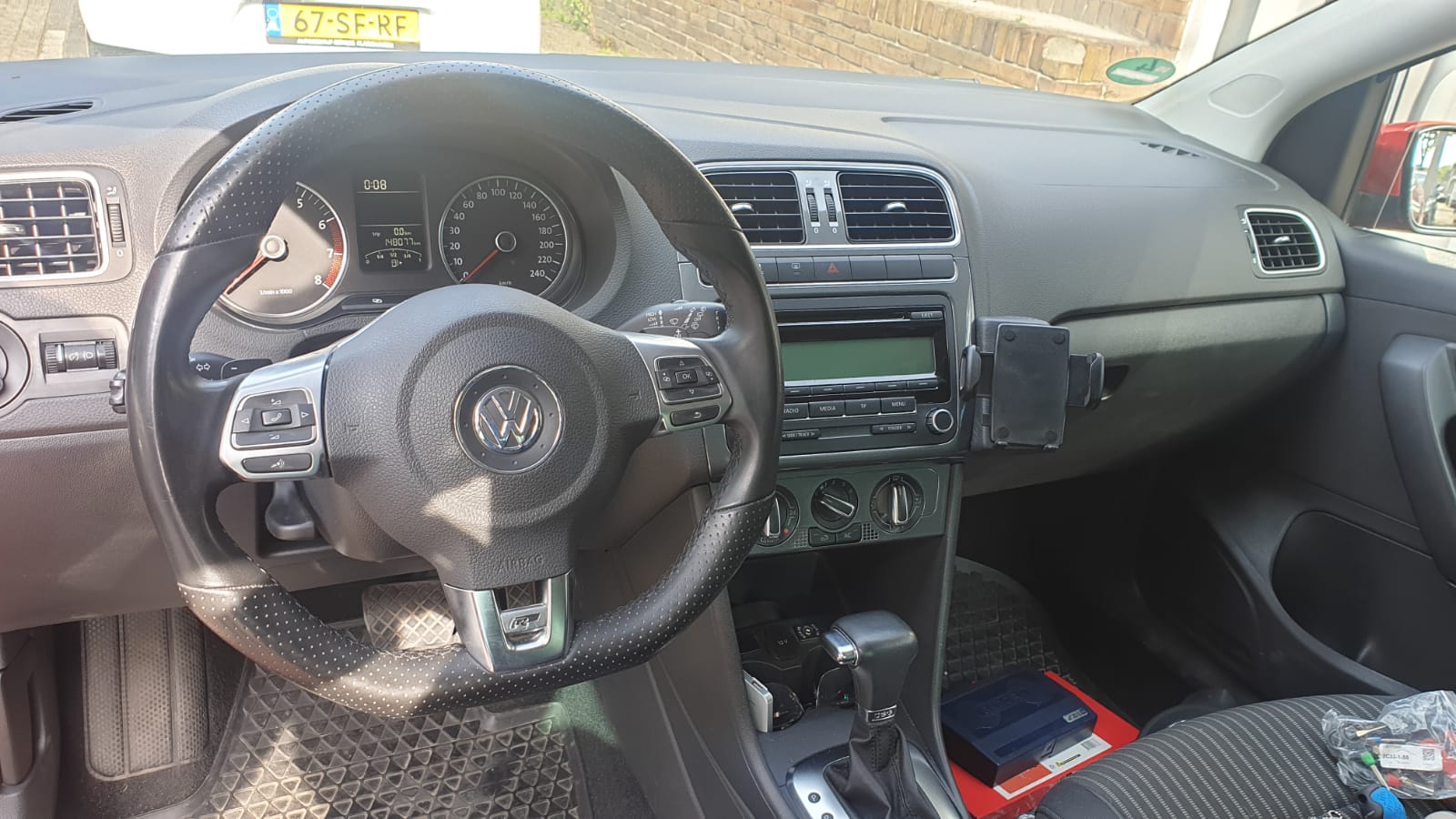

But! picked up a steering wheel today.
One of a 2011 VW Passat (r-line).
just need to get the cable to the airbag.
hope that the airbag of the polo fits.
can anyone tell me if there is a tutorial to activate the DSG flippers?
- Posts: 6368
Re: MFSW steer swap
Should be activated with the activation of the MFSW. No extra action needed.

It took a while, but the steering wheel is in it! and works perfectly!
Super thanks !
