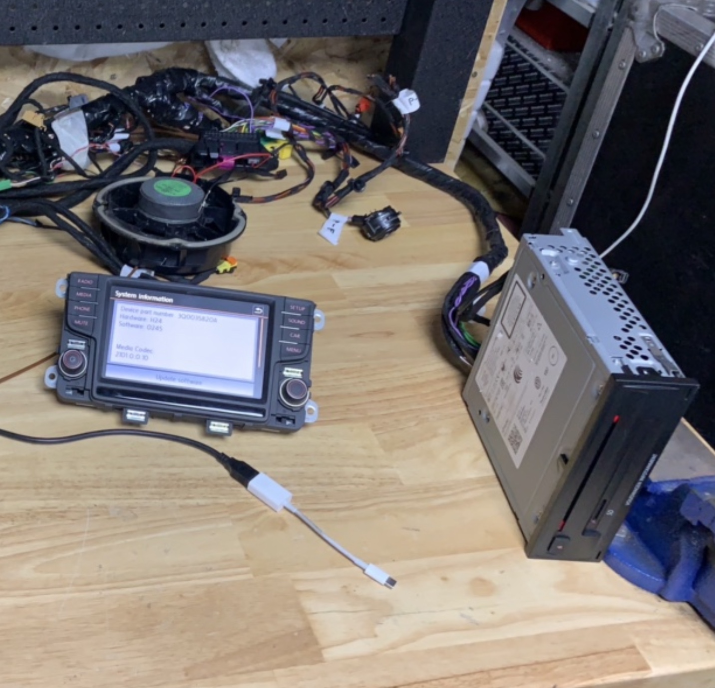

Hi, I'm wanting to remove the radio/touch screen to add a amp connection on the rear + add a power wire to a camera from the usb port connections.
First is there any trick to getting the trim around the radio off?
Once that is off, it's just undo the 4 bolts and slide out?
What colour wires is it for the front left/right speakers?
Also what wire for the radio is it I want, i think on to the Ariel so I can link that to the amp on wire?
Next the glove box, think its just unbolt, but anything to take special care with?
Front and read, passanger side foot well trims they just slide an pull up?
Now the camera power.
We're would be the best place to link to the usb header cable for power to run to a camera, it would then need to go to the rear view mirror area.

The head unit is in the glovebox.
The screen in the dash is just a screen.
If it's for a dash cam I'd just find a supply in fuse box for it as i believe the usb goes to a small plug in connection that's not easy to access.
There might be an aerial output but there is a good chance it will only put when on radio.

Yeah the cd player is where everything thing is wired to. It can be a right pig to get out but will come out.
What i was getting at with the usb is that the only access to the 5v would be at the port by the cigarette lighter. So for the camera id just get a 12v to 5v converter and pick a supply up from the fusebox.
I did look into finding a switched supply out of the head unit but didn't find anything useful as i wanted to fit a small amp behind the head unit to boost the speakers a bit.

The touch screen is wired with a similar connector as the usb so there is no wires to access as such.
The usb is driven from the head unit so only gets power while the unit is on.
If you need a constant 5v then you would need to get that from the fusebox anyway.

I have seen like a oem radio add a amp plug & play Harness, anyone know one that will work with the polo. Just want to plug to the radio then plug in to that with two audio cables??
- Platinum Member
- Posts: 1144
- Joined: Fri Sep 28, 2007 9:04 am
- Drives: 2015 GTI
- Location: Cwmbran, South wales
Re: Radio removal polo gti 2016 (6c)
Sounds like you mean a T harness (i used one of these to fit my pioneer gm-d1004 amp)
You can then take the audio to the amp and back from the amp just by plugging it in.
http://caraudiosecurity.com/audi-a1-201 ... -populated

Sounds like you don’t know what your doing in the car you have as the main stereo control module is as stated under the flap In the glovebox

you need to make sure it is fully populated (52 way) which that looks like it isn't tbhTrebleTA wrote: ↑Sat Jul 04, 2020 11:37 am Is this the correct one?
http://caraudiosecurity.com/ct10vw01-v ... -sot-lead
the one i posted will work
