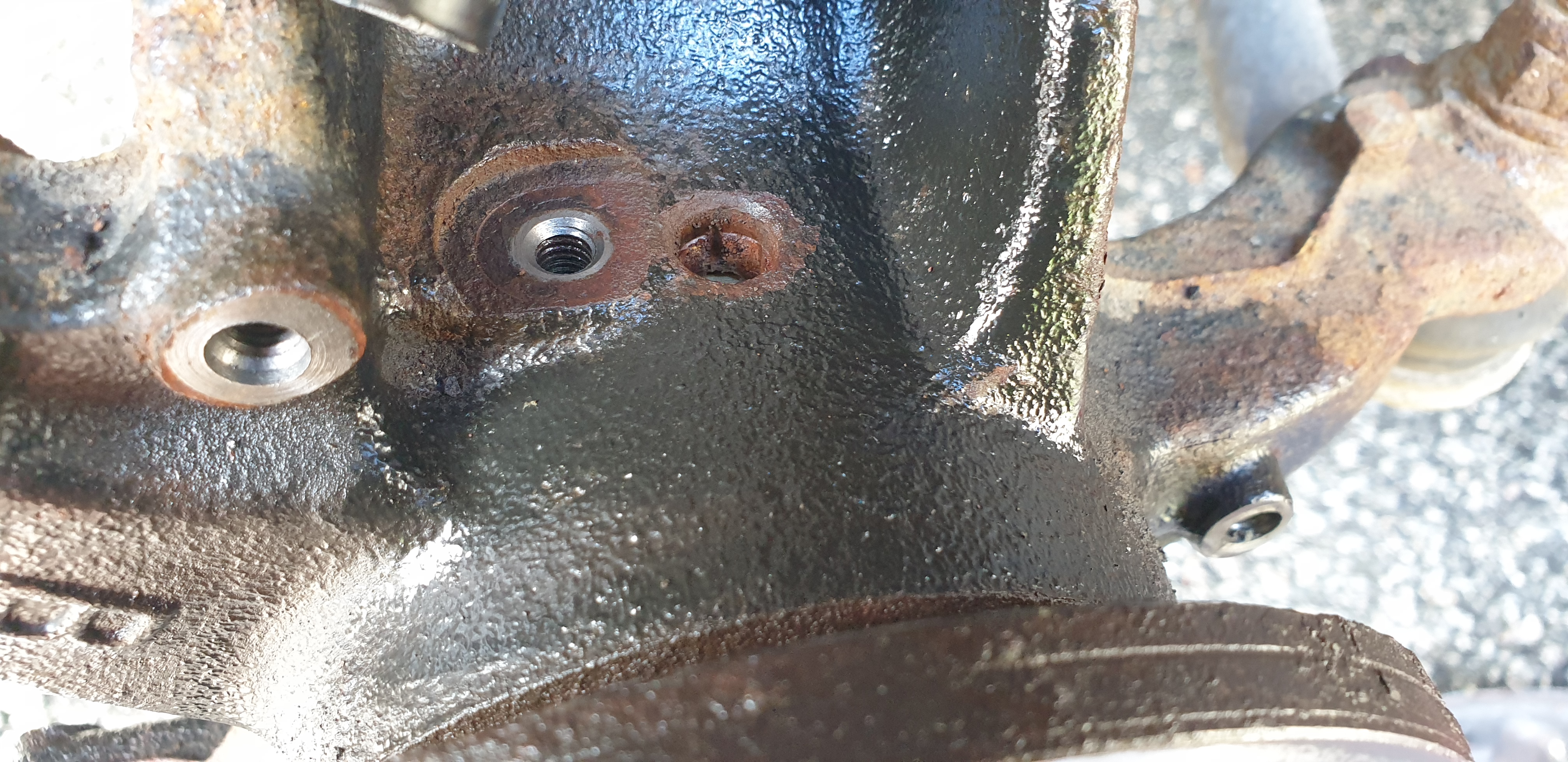

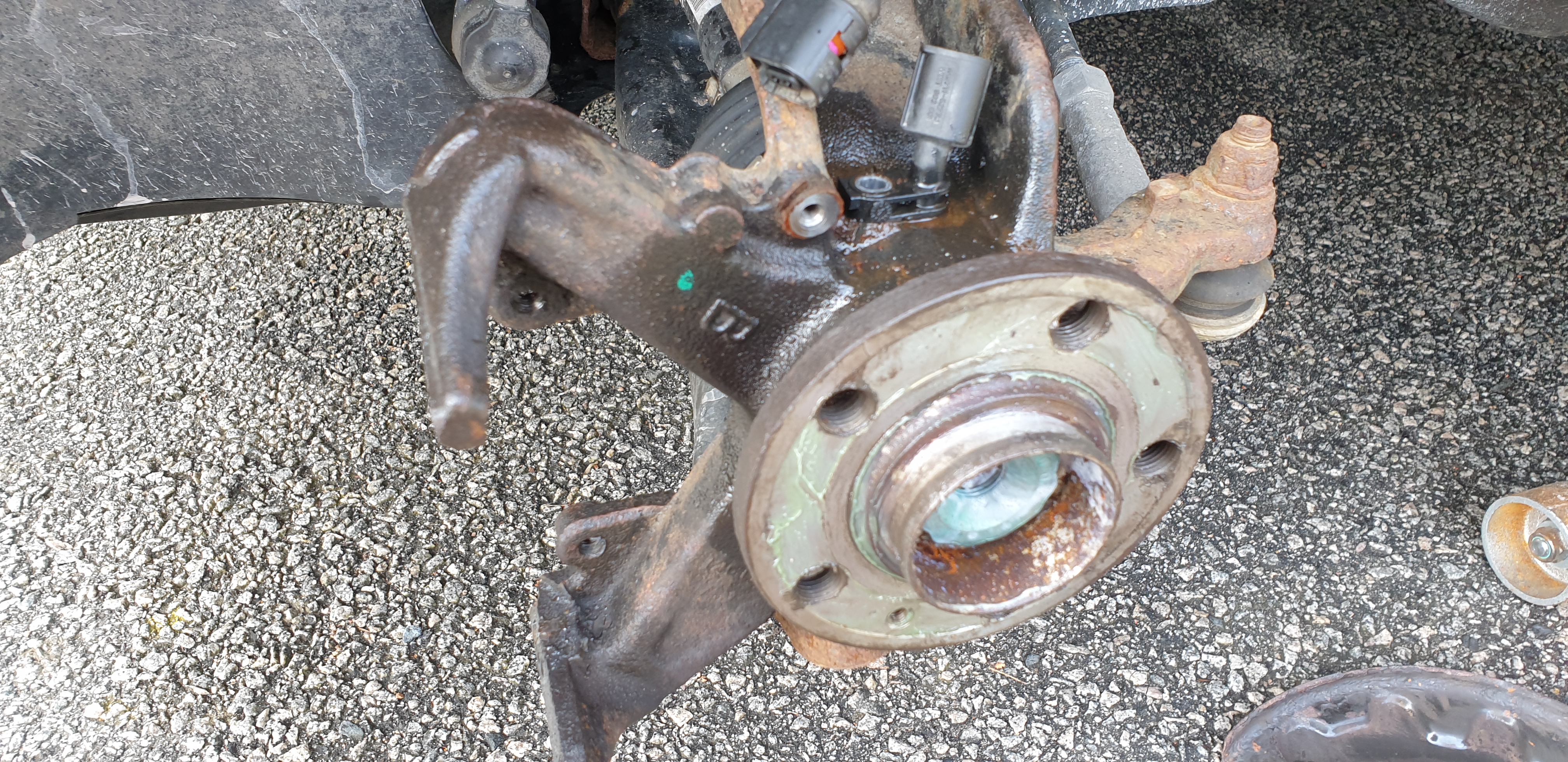

Prep work for bearing change next weekend. Dust shield comes off and ABS sensor pulled. This is the kind of stuff that turns a job into a nightmare. Bearing definitely goosed. Hard to turn and rough.

Fitted the bearing today between showers. Nothing unusual. Knowing the ABS and brake dust shield would come off as I did the preparation last week was a bonus. This is an excellent video if you're attempting it. I ordered a bearing puller tool from Germany. I had to remove the drop link to get the drive shaft out. Other than that, go slow and it's straight forward.
