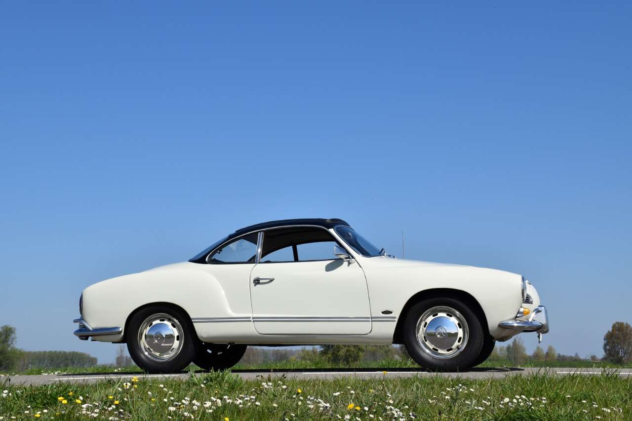

Made some photo's today of the little Karmann. There are two types of Karmann Ghia, the Type 14 (like mine) and the Type 34. The Type 34 is based on the newer Type 4 chassis and is a bit larger. It's like the Golf Mk6 and Mk7. The 14 is called 'Der kleinen Karmann' in German, the little Karmann Ghia.
Of course there are some small things that I need to do:
- Driver side windows (front and rear) don't fully close
- Radio doesn't work
- The rear axle needs to be lowered a little bit
- White walls
- Center the steering wheel
- Small things like the boot opening cable needs a wire end, some new screws for the front indicator lenses

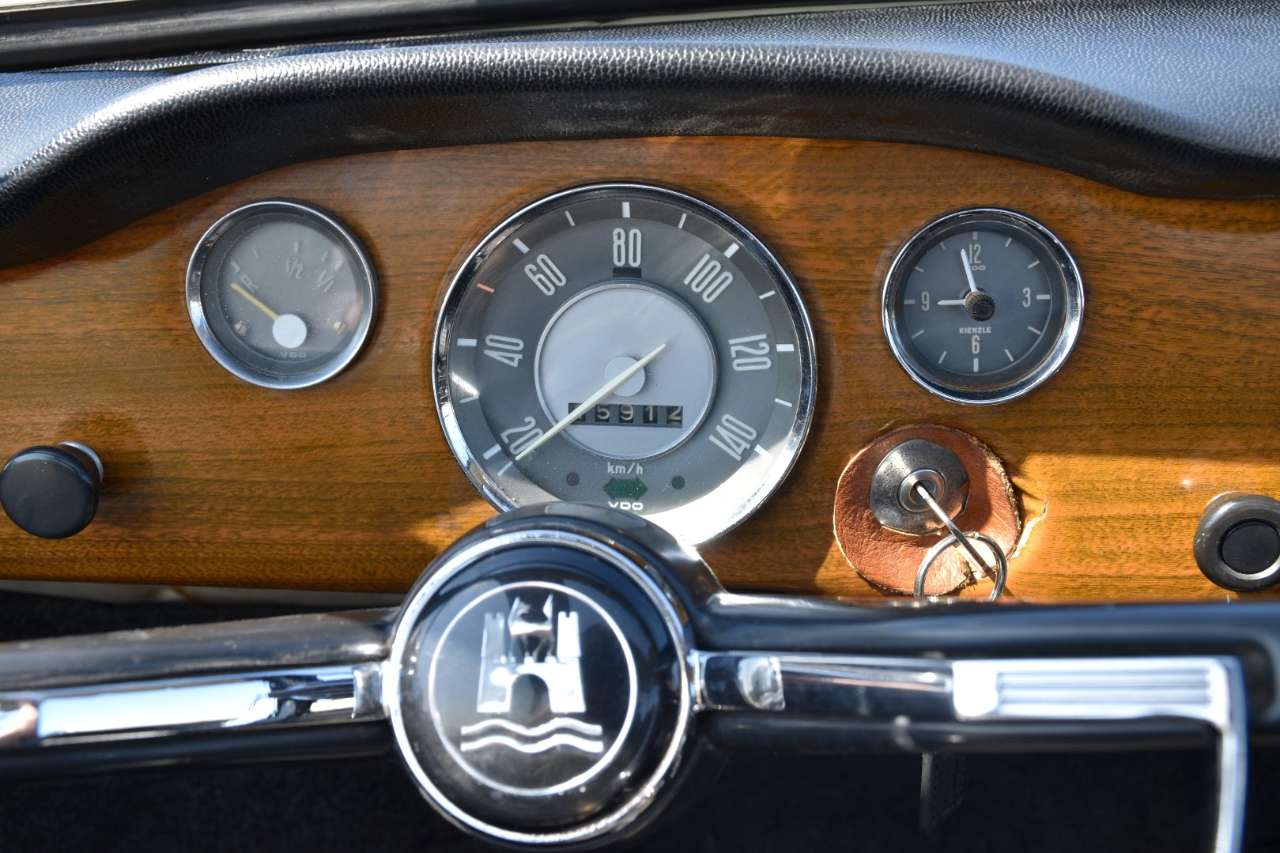

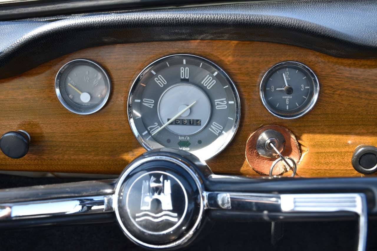

So my Ghia needs to be perfect and that includes a working clock.
The clock, a VDO Kienzle clock, has an internal fuse and in mine it was broken.
Furthermore, the outside of the clock, that is also the GND, was very corroded and was making a bad contact.
I re-soldered the fuse and cleaned the outside. The result is a working clock!
