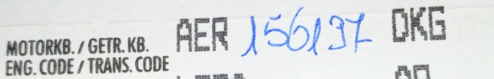

alexperkins wrote: Mon Aug 19, 2019 9:36 am Need to know your engine code please to find the seal you need
Polo 6n1 1.0 50 PL
did I write the wrong code ? is what you needed ? thanks

The seal is N906 175 01
The whole seperator inclusive of the seal is 036 103 464 G. Febi make an OE quality replacement with part number 38773
