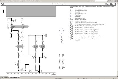

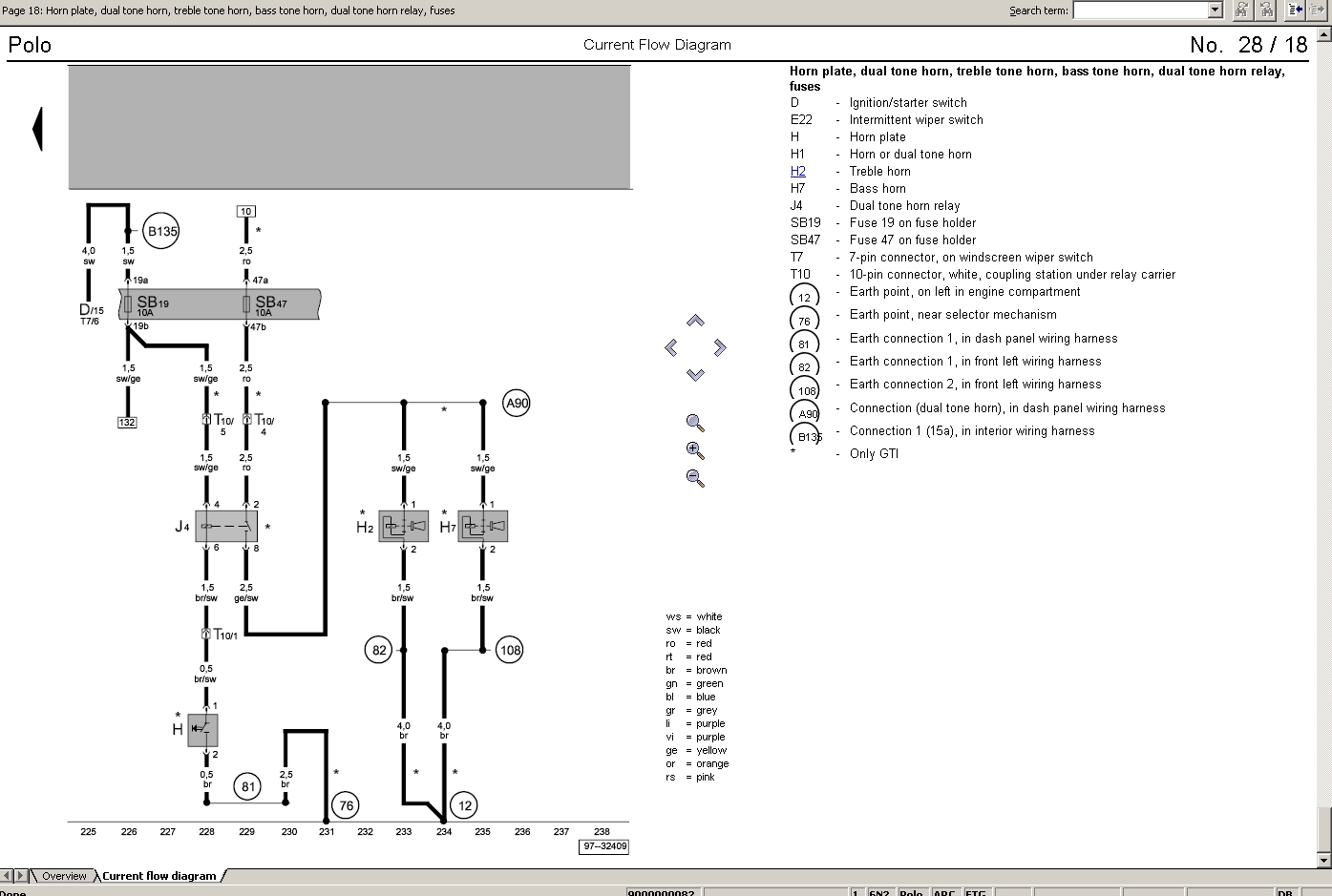

It doesn't make sense that the fuse is blowing when the relay is removed. look at the wiring diagram below and confirm the car is wired as original.

With both horns removed it still blows fuse 47 which from the diagram above is the horn.

Right I have had a quick.look at wiring diagram. Remove the horn relay then check that you have the lives to the relay. If lives are present then would suggest remove air bag and check wiring in steering wheel. The horn plate is part of the slip ring and you should have a contact from rear of steering wheel to slip ring. You will also need to remove steering wheel to check condition. If all looks ok then try bridging horn plate and see if horn sounds/fuse blows..if it blows fuse then you have a wiring issue from slip ring to relay
