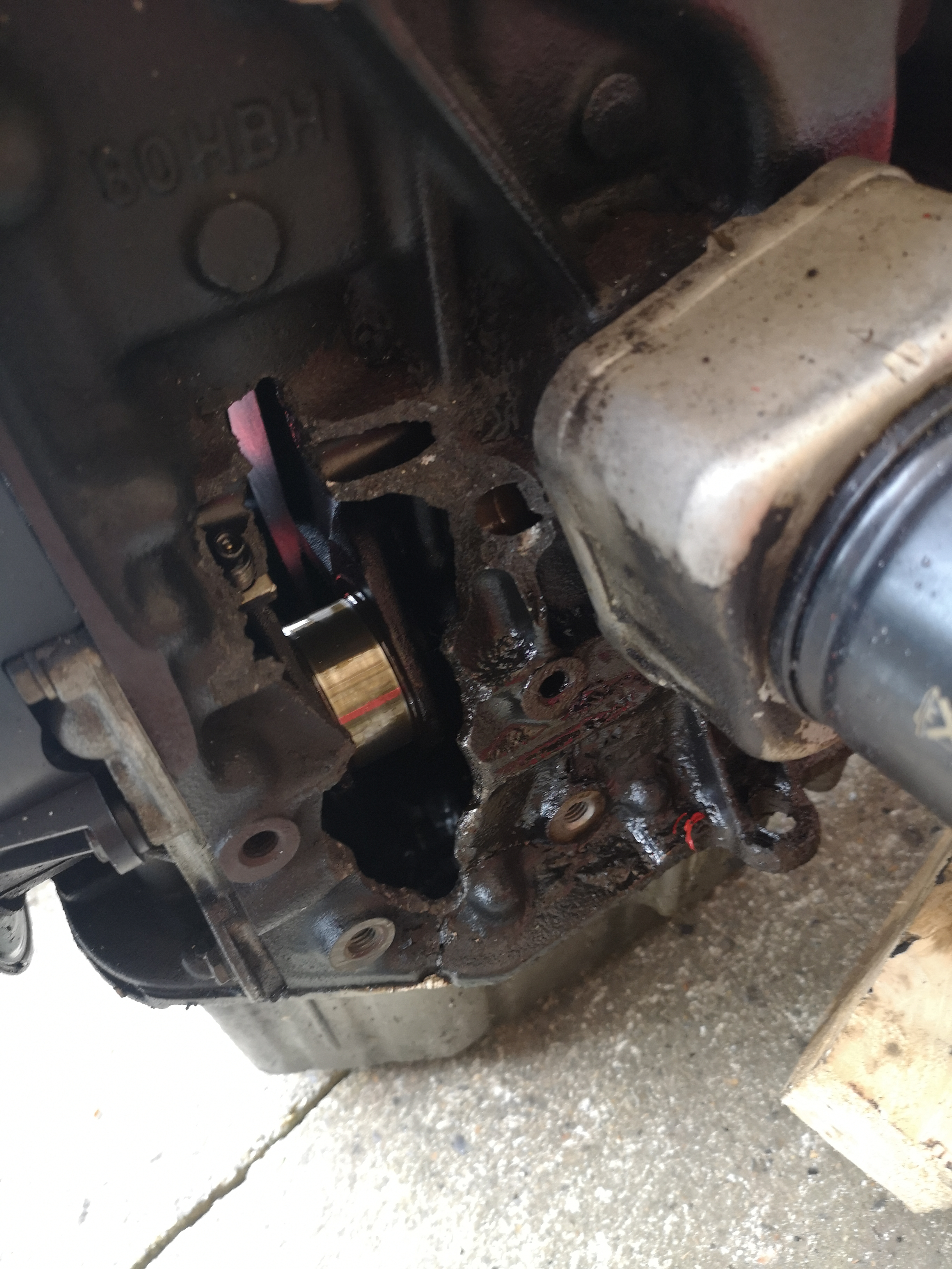

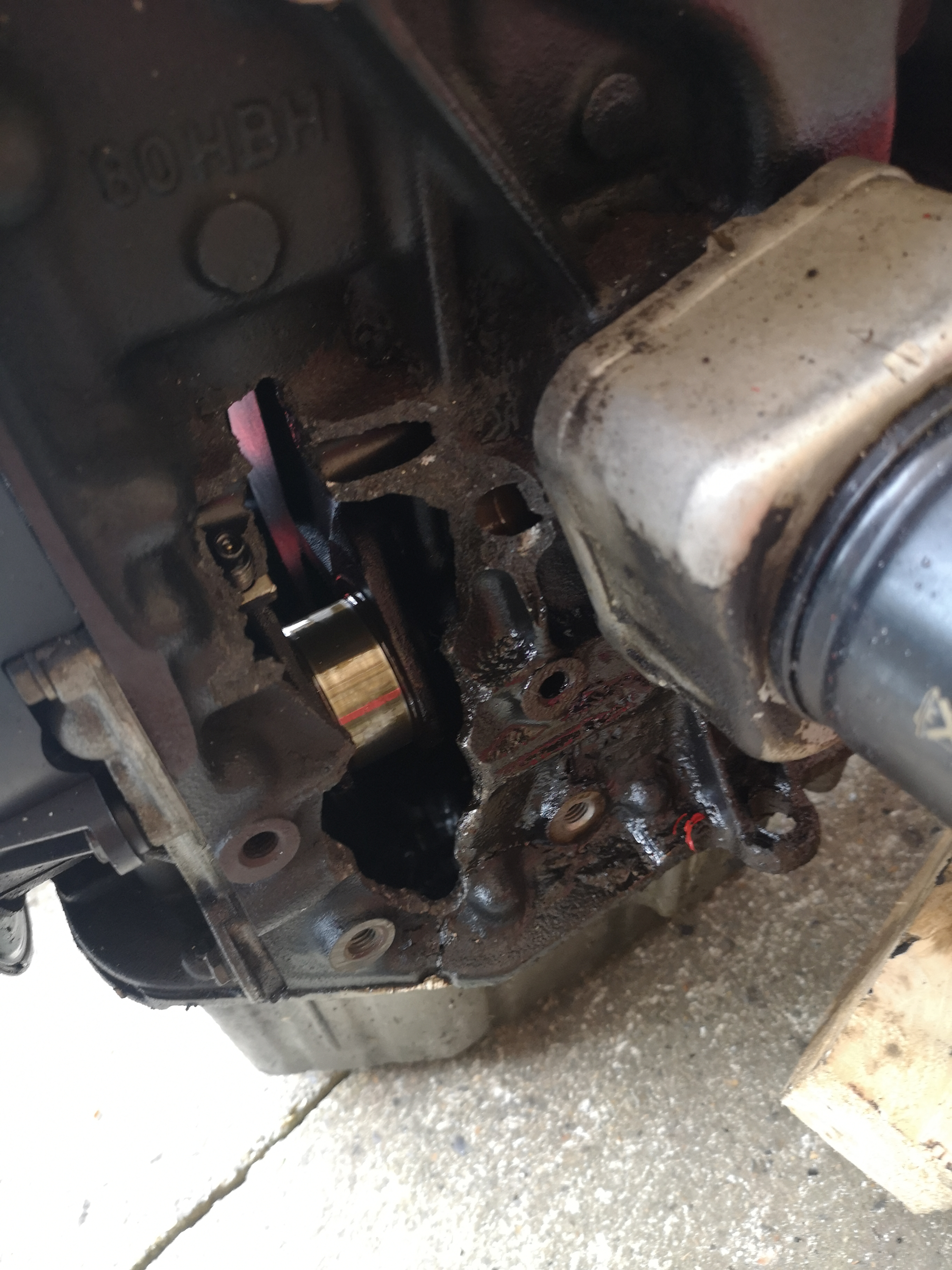

Yeah maybe the seals dry out when the engine has been out of the car, however my polo sat for 3 years without running and never had any issues with the engine until last December I hit a huge puddle and sucked up a ton of water resulting in this......
Hopefully that picture works
It's very frustrating because my original engine was a very good one, it was very well maintained and very clean internally. Now I've got this s**t one haha
If it were the piston rings, would the cylinders need boring or honing to fit new ones? Even thought the car sounds normal
Apart from the smoke and oil consumption I have noticed some hesitant starting, it always starts but when cold it is hesitant, when the car is hot it starts well.

Wow, hydraulic locking with a rod chucked out the side for good measure. Looks like the puddle was also called the Thames estuary :)

Haha the puddle was massive and it was about 2am on a dark country road
