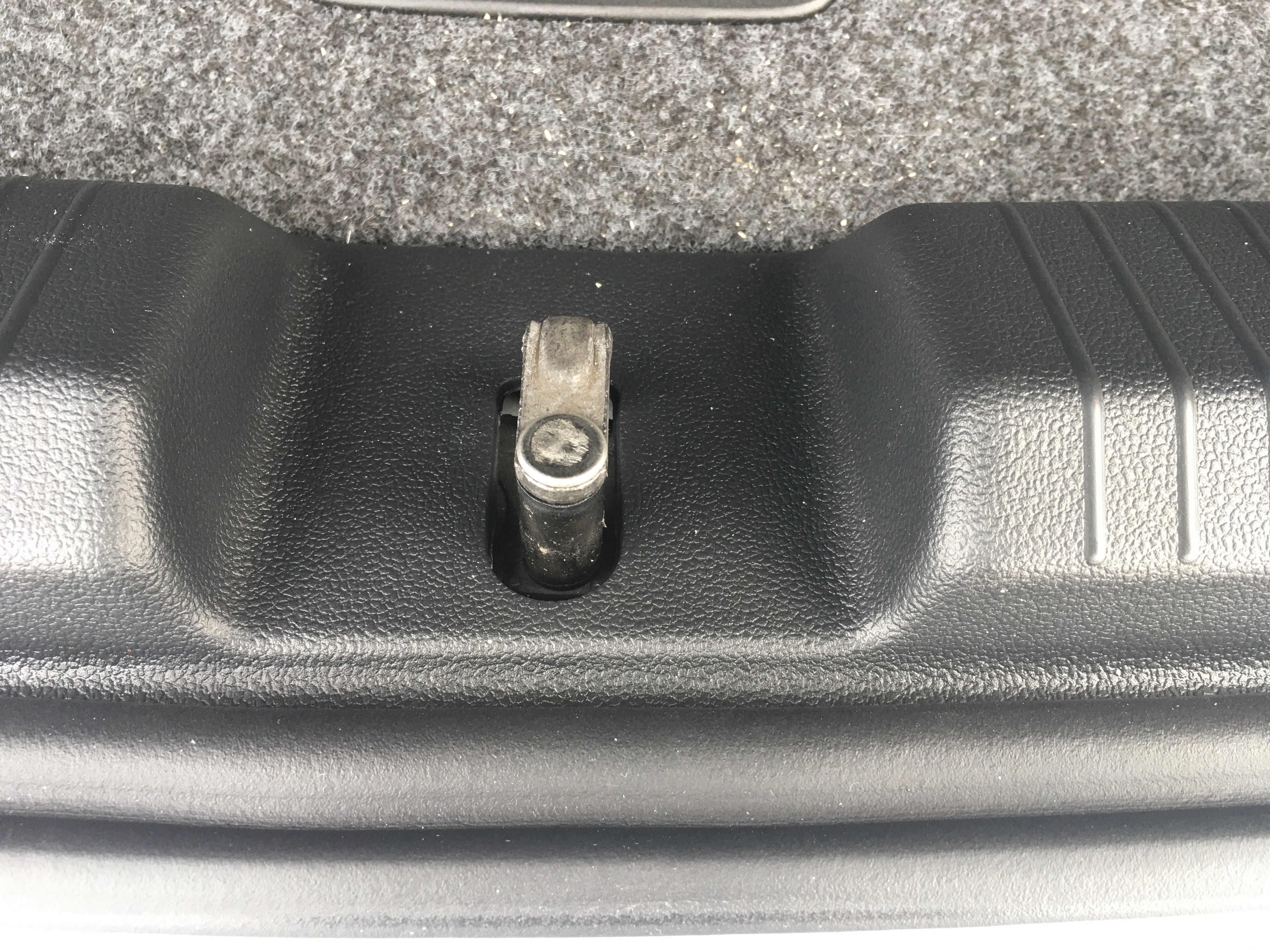

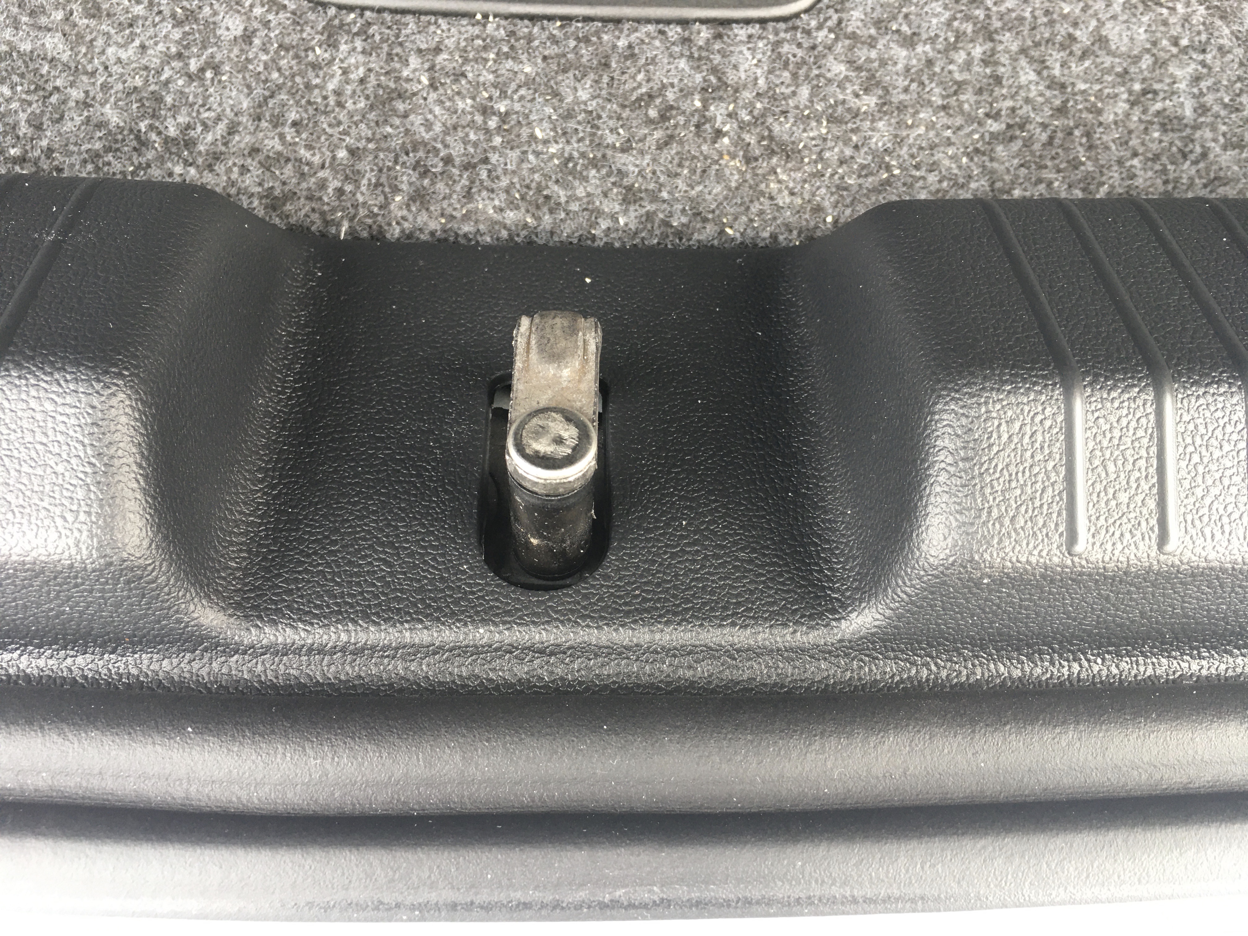

Anyone else get issues with the Boot? I have to give mine a good slam to close it, what i call a normal close results in the warning message showing ... a bit annoying to slam it all the time
- Posts: 2643
Check out page 20 of the "what did you do with your Polo today" thread.
I had this issue with mine. The strike plate that the tailgate latches onto was set too far back, requiring a slam to close the tailgate. This chipped paint on the inside edge of the tailgate in 2 places. VW only give you 6500 miles/6months to sort under warranty, get it back to the dealership ASAP. The tailgate should almost close under it's own weight from a horizontal position.
Thanks mate i will have it looked at by the dealership
- Posts: 2643
If you could post a birds eye view picture of the latch (sticking up from the bottom rim of the boot floor, I could advise if it looks off. It should be quite central in the plastic cutout - mine was to the very back of the cutout and to the left.
- Posts: 2643
I can't quite see from there, it's at a bit of an angle. If you take a pic as you're squarely above the latch and the cutout hole, so you can see the latch and the whole cutout around it, I'd be sure.
From the pic supplied, your latch does seem set back and to the right.
Here's what mine looked like before I adjusted it:-

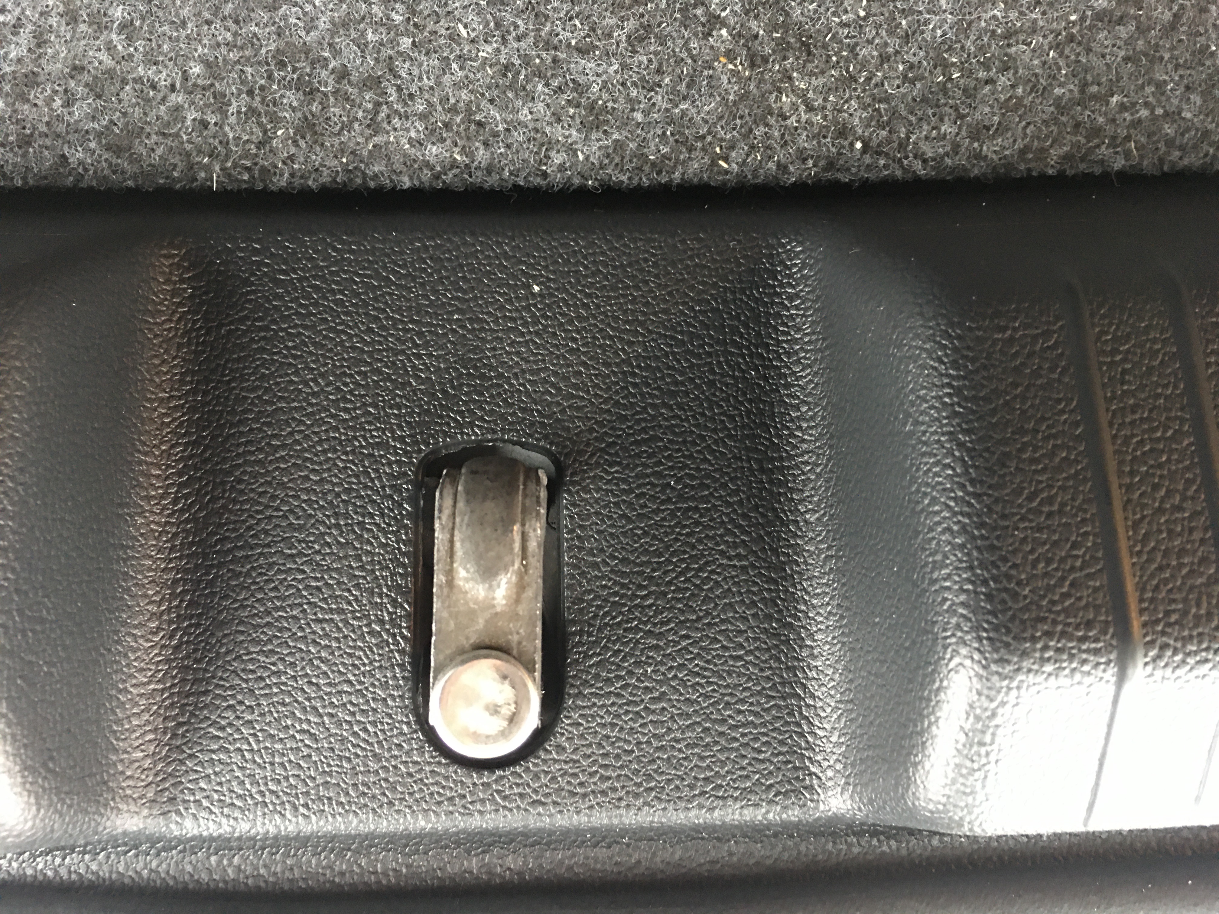

Heres a better view hopefully
- Posts: 2643
That doesn't look anything out of the ordinary, mine was set right back in the slot. If you haven't had the car 6 months then go back to the dealers. You could check the bottom edge of the tailgate for chipped paint (small chips). If you have chipped paint, they should sort that too.
