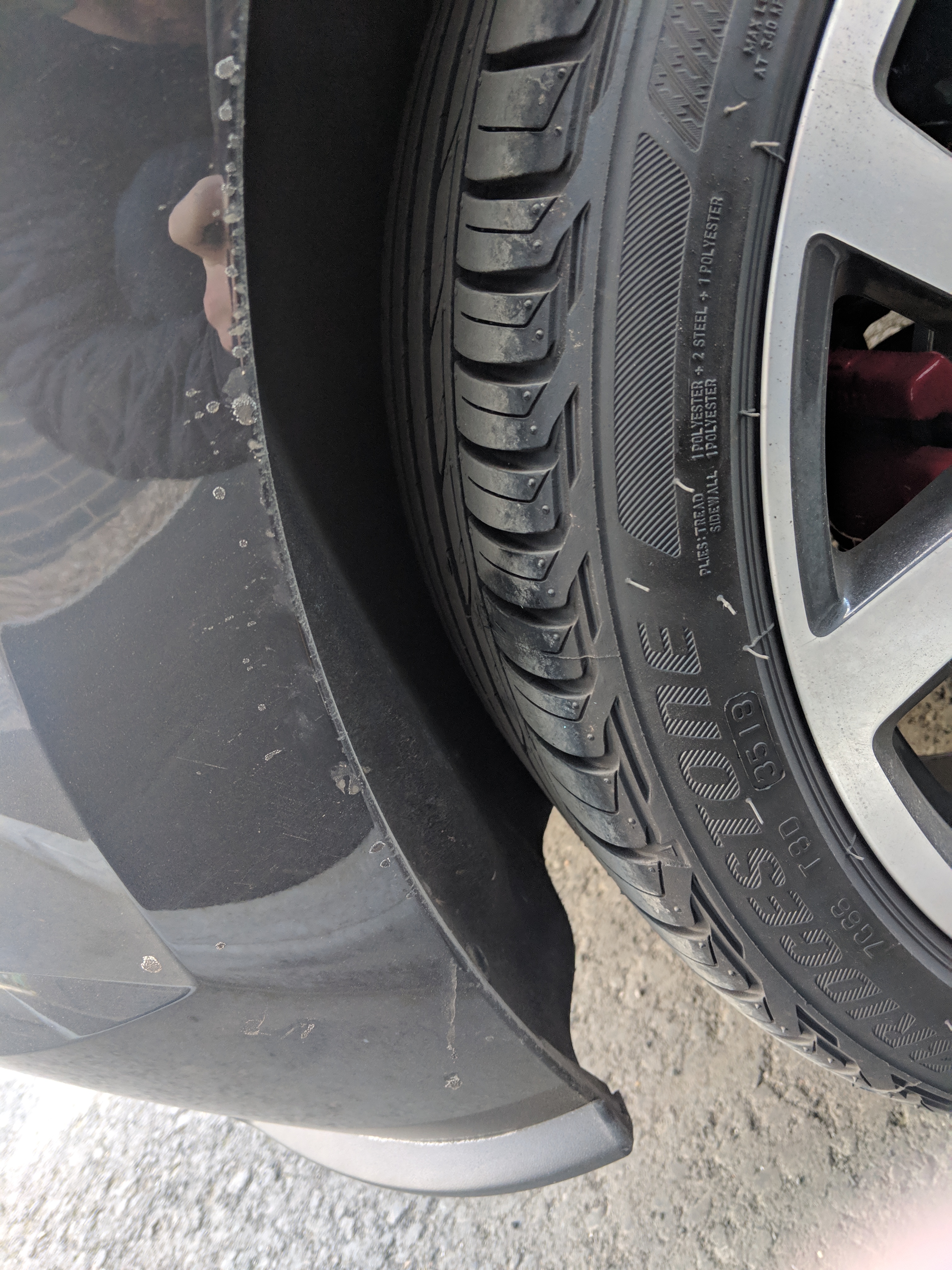

Mine must be misfitted. Might get the wheel off and have a look at the fit of the wheel arch lining tomorrow. Any chance of a pic or 2 of the wheel arch and top of the wheel, specifically where you see the indented tab where the torx screws go into the bodywork behind the wheel? Seeing where yours are to compare to mine might explain why mine is bowing towards the wheel and yours isn't.JMiddo94 wrote: ↑Sat Feb 16, 2019 1:01 pmStandard GTI With 18 inch bresciasmonkeyhanger wrote: ↑Sat Feb 16, 2019 11:47 amIs yours a GTI or GTI+ with the wide wheels and tyres? If not, what size wheels/tyres do you have?

Just checked again and I can see what you mean now in how tight the arch liner is towards the back, I measured mine and both are about 20 mm clearance.
- Posts: 2643
Thanks for looking. From your pic, i'm guessing that you werent looking where I was looking for clearance though. The tyre radius will only increase by 4mm from the wheel centre, so no way it will snag on the end of the wheel arch across the tyre tread. I'm looking at the clearance between the inside face of the wheel and the wheel arch lining.
So, you're looking straight at the wheel and imagine it as a clock face. Between 11o'clock and 2o'clock, you feel behind the inner edge of the tyre in the wheel arch and see how much of a gap you have there without touching the wheel arch lining directly behind it. You can also put your hand right through the top wheelspoke which corresponds to 12o'clock and feel the gap to the wheel arch lining - My wheel arch lining bows out towards the wheel and leaves a tiny 5 to 8mm gap. Is yours the same?
If I had 10mm gap then I'd have no worries about the slightly wider tyre rubbing off the wheel arch lining.

Had the rear drivers side wheel off today to get a good look at the wheel arch lining. This photo should absolutely make clear the clearance issue I've been on about when talking about fitting wider tyres:-
As you can see from the red arrows, this is the bit of the wheel arch lining that flares out away from the 2 pipes (but is nowhere near touching them). I Unscrewed the 2 torx screws and spread the arch a little bit to try and flatten the arch. It worked, to a degree. I have about 15mm clearance now between that flappy bit and the back of the wheel. The intersection of the 2 green lines is where the top centre of the wheel is when the wheel is sitting on its springs.
The right-most blue oval is where there is a lug (behind arch lining) from the main bodywork to attach what I assume is the ABS sensor wiring (as it follows to the brake calipers. I'm probably going to put 2 slits in the lining around the metal pipe (middle blue oval), to thread a cable tie and pull that lining tight in towards it (the pipe was not warm, even though I had just driven home 13 miles). Should have a healthy 20mm gap between lining and rear of the tyre edge if that flare out gets pulled in.
The front clearance of the wheels at full lock is plenty to accommodate a 10mm wider tyre. With the flare-out secure, we'll be sorted for clearance to put on 225/40 R18 tyres, no spacers needed. So for the lack of a few cable ties today, i'll have to do it all in the next few days again (jack the car, wheel off, cable tie, wheel back on, torque up nuts).
