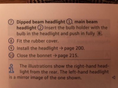

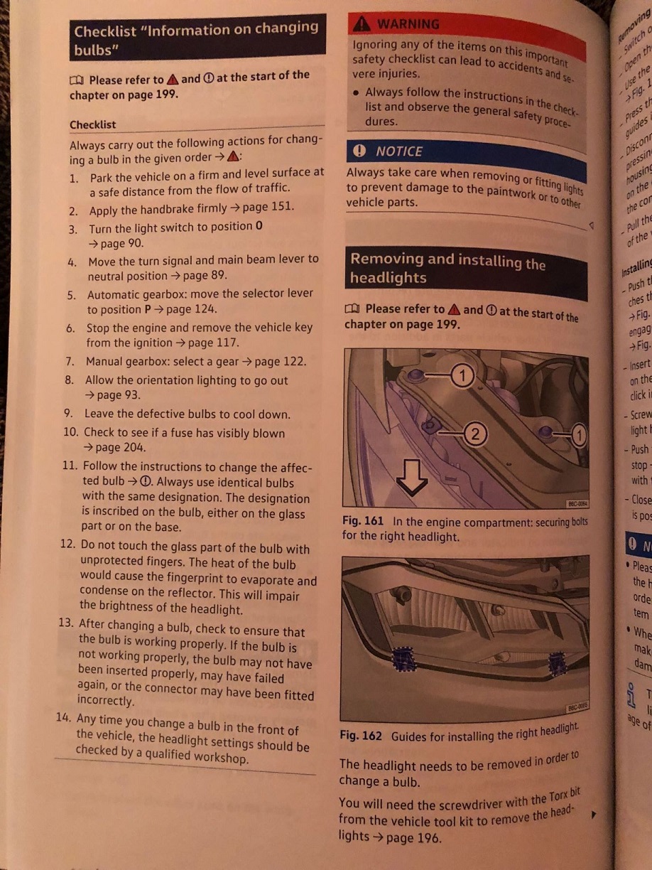

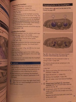

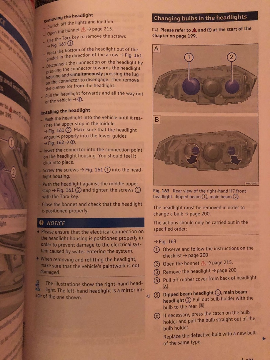

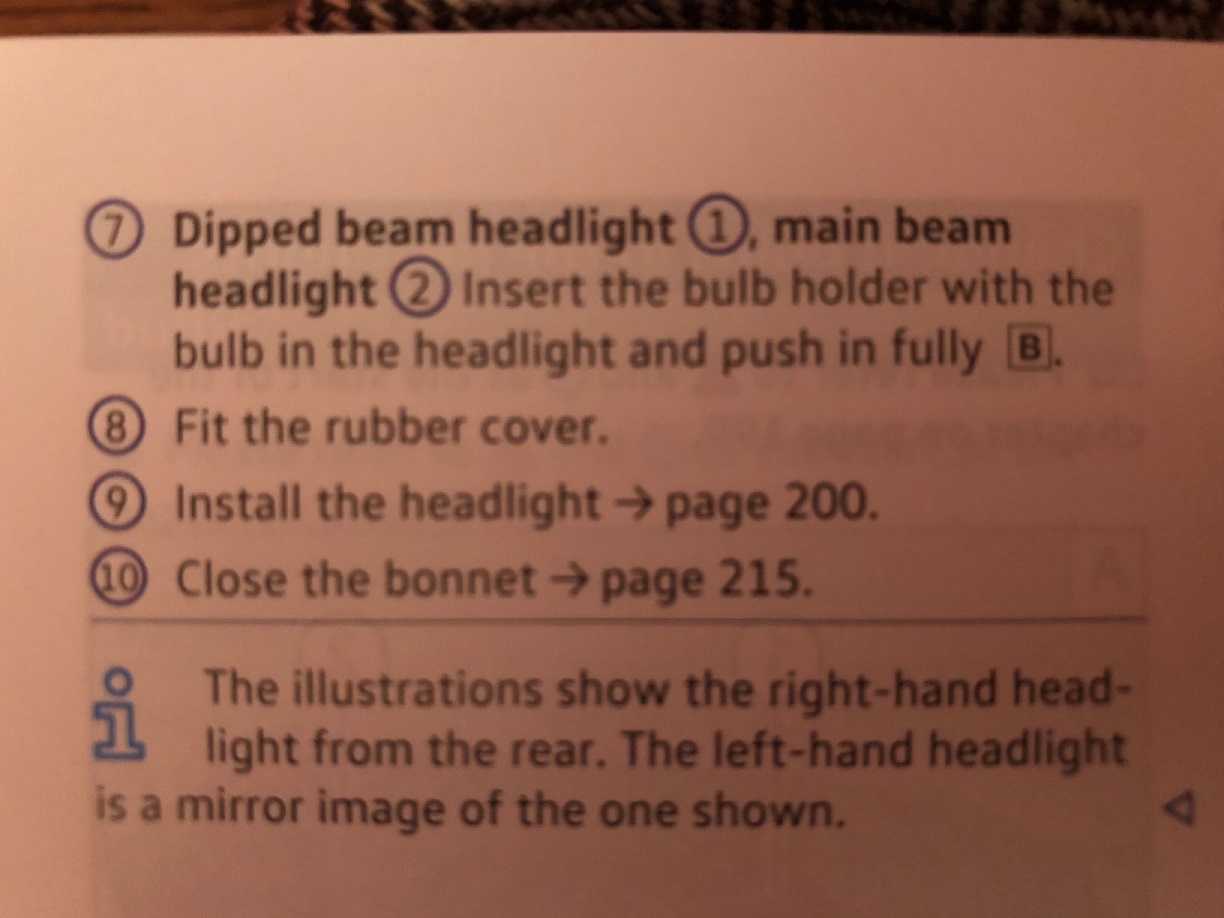

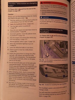

Pages from the manual..

Does that confirm the headlight fitting is H7?

Hey guys.
Just to confirm, the lamp is indeed H7 and here is a small video that shows how to remove the headlight.
https://www.youtube.com/watch?v=RVmvEHYNnh4
Sorry, but the video is not in English, but he says that you just need to remove two screws and unplug the socket in order to remove the headlight. It needs a hard push in order to make it loose. And the same hard push to put it back in place.
Hope that helps! =)
