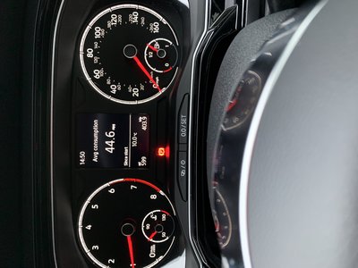

Can anyone explain this pic for me
I used to have this appear on the dash (from start)and it would say it was doing whatever mpgs at the time, and it would creep up the more economical I drove
Now though it’s saying long term and the mpgs are saying 40.5mpgs and it’s not going up or down like it used to
Hope this post is making sense
Can anyone explain why it did this now doesnt
My car is getting average of 40, I’ve seen it do 50-55 one trip

The display cycles between single trip ("since start") mpg, long term mpg and mpg for the tank by pressing the "OK" button on the steering wheel. If you're in "long term" with plenty of trip data (The long term accumulates data from up to 100 hours of driving). Data from a single trip has a tiny impact on long term mpg, unless long term has just been reset.
Re: MPG Question
I think you just need to use the toggle button to change it to since start. Its the little button on the right side inset into your steering wheel. Just have a fiddle you will find it .

You are seeing average mpg rather than current mpg. On the right side of the steering wheel, press the lower button of the 5 button group. Now you should see current mpg. You can use the top and bottom buttons to switch the display to speed, distance travelled, average mpg etc.
When average mpg is displayed, as the others say, press the right or left hand buttons on the right side of the steering wheel to cycle between mpg since start, since refuel, and long term.
