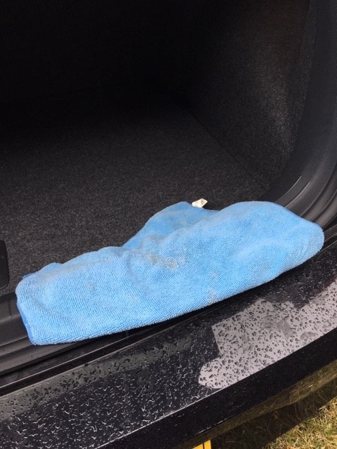

Knocking from rear driver's side 'cured' by insertion of microfibre cloth between tailgate and body.
So definitely the tailgate rattling against the shell.
I'll get it booked in sometime, I'm rarely in the boot and happy to leave the cloth there to save me a dealer trip for now.

For the knocking, try putting a thin cloth between the bottom of the tailgate and the shell.chris.tayler wrote: ↑Tue May 21, 2019 2:47 pm Latest update - Both issues are back again.

If the knocking stops, you've got tailgate issues same as me.
The cloth in mine has stopped me going insane over the past week or so.

I'll give the cloth a shot! Do you have a picture of where you've put yours?Andy Beats wrote: ↑Tue May 21, 2019 2:55 pmFor the knocking, try putting a thin cloth between the bottom of the tailgate and the shell.chris.tayler wrote: ↑Tue May 21, 2019 2:47 pm Latest update - Both issues are back again.

Here you gochris.tayler wrote: ↑Tue May 21, 2019 3:20 pm I'll give the cloth a shot! Do you have a picture of where you've put yours?
Literally bottom right of the tailgate.
Overlapping the seal, but not enough that it pokes out of the bottom of the tailgate when closed.
