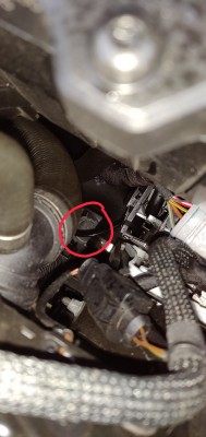

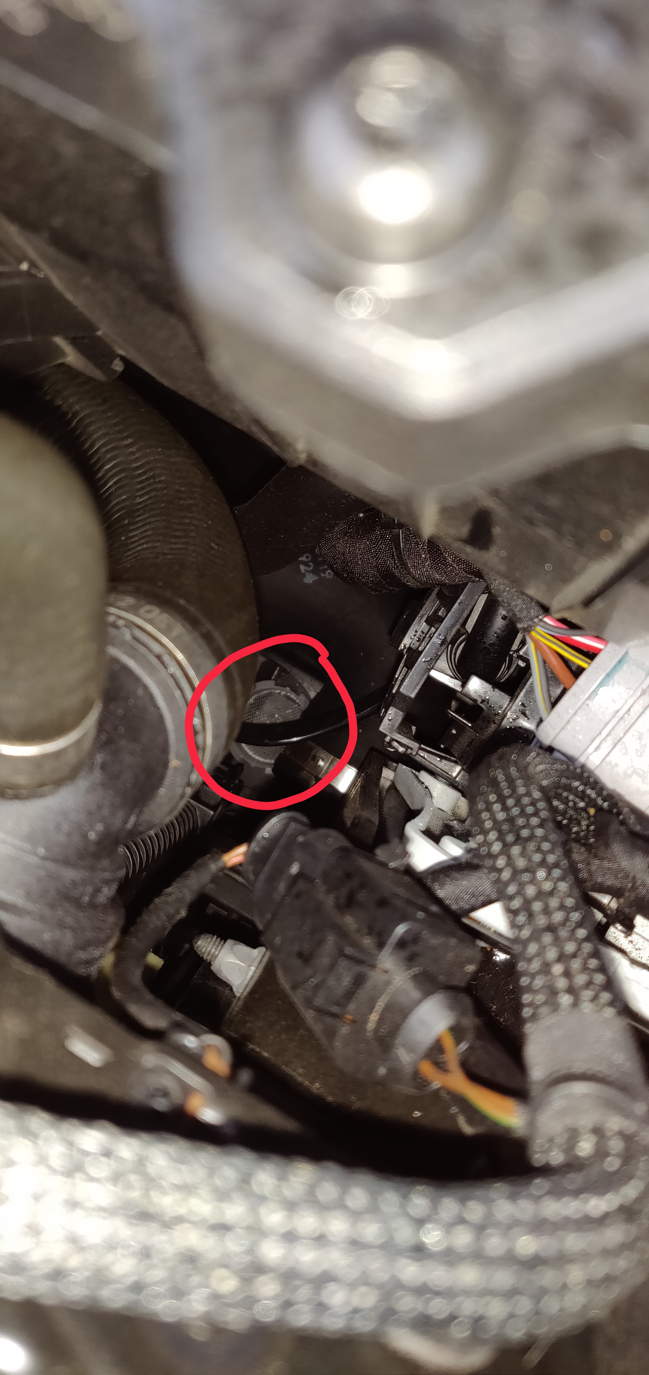

Bit of a mare this morning. Was filling up the washer fluid, had the filter cap resting just next to it then a gust of wind has pushed it downwards.
I can see the cap at the bottom of the car (photo attached). Will this cause any damage? Have tried fishing it out but no luck.

Can you attach some high tack sticky tape to the end of a thin stick or cane and remove it that way?

Rummaging through the house now trying to find something that will reach!SRGTD wrote: ↑Sun Oct 13, 2019 2:02 pm Can you attach some high tack sticky tape to the end of a thin stick or cane and remove it that way?

Stating the obvious, you won't know til you fish it out, plastic can take hard hits but can smash at the lightest touch. Try a length of straightened coat hanger or if there is a Home Bargains store nearby you can buy long-ish grabber devices for £1.25 I believe. It happens though. I once decided it was a brilliant idea to randomly check the oil level of my car. At nite. Using the torch on my fone. Yep, fone fell off top of engine into engine bay . But was easy to see as, well the torch was still lite. Fone was a bit scratched but ok. Now I check fluid levels via the bright yellow thing in the sky ....

Panic over. I've got it.
Coat hanger and some blue tack did the trick.

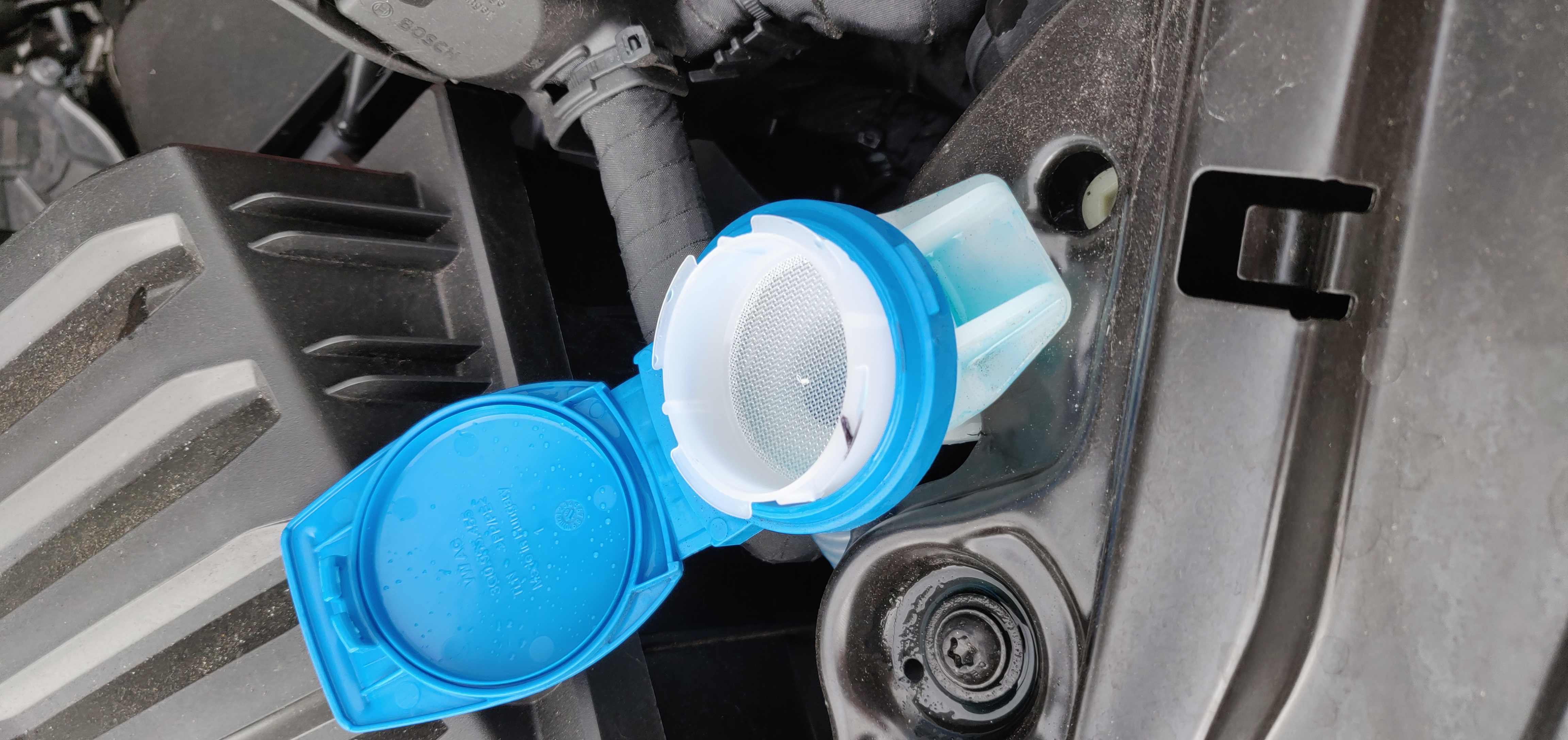

S_94 my gauze filter is not attached to the filler neck either. It has an array of teeth around the outside edge that look like they serve a perpose but there is no way of locking it in. I have nearly lost it every time i filled up as the foam bubbles from the screenwash fluid rise up the neck and push it out.

Agree. This designe is absolutly worst I have ever saw. I always pour it slow and it always bubble to top like mad.johnparker wrote: ↑Fri Oct 18, 2019 7:13 pm S_94 my gauze filter is not attached to the filler neck either. It has an array of teeth around the outside edge that look like they serve a perpose but there is no way of locking it in. I have nearly lost it every time i filled up as the foam bubbles from the screenwash fluid rise up the neck and push it out.

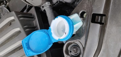

Edit:- looking back at the OP's picture of the filter screen back in place - does it not need to get pushed further down into the neck of the washer bottle so that it gets retained, and if so, is that why other's are also noticing that it can float up and out when the fluid bubbles up when refilling that bottle, or is there now a design change to these washer bottles that has removed that feature accidentally?

It does not go any further. There are groves but too deep and smaller than "wings" at filter. So this is normal position and very easy to remove. Skoda filler cap look little more useful. Anyone know if it would fit?
