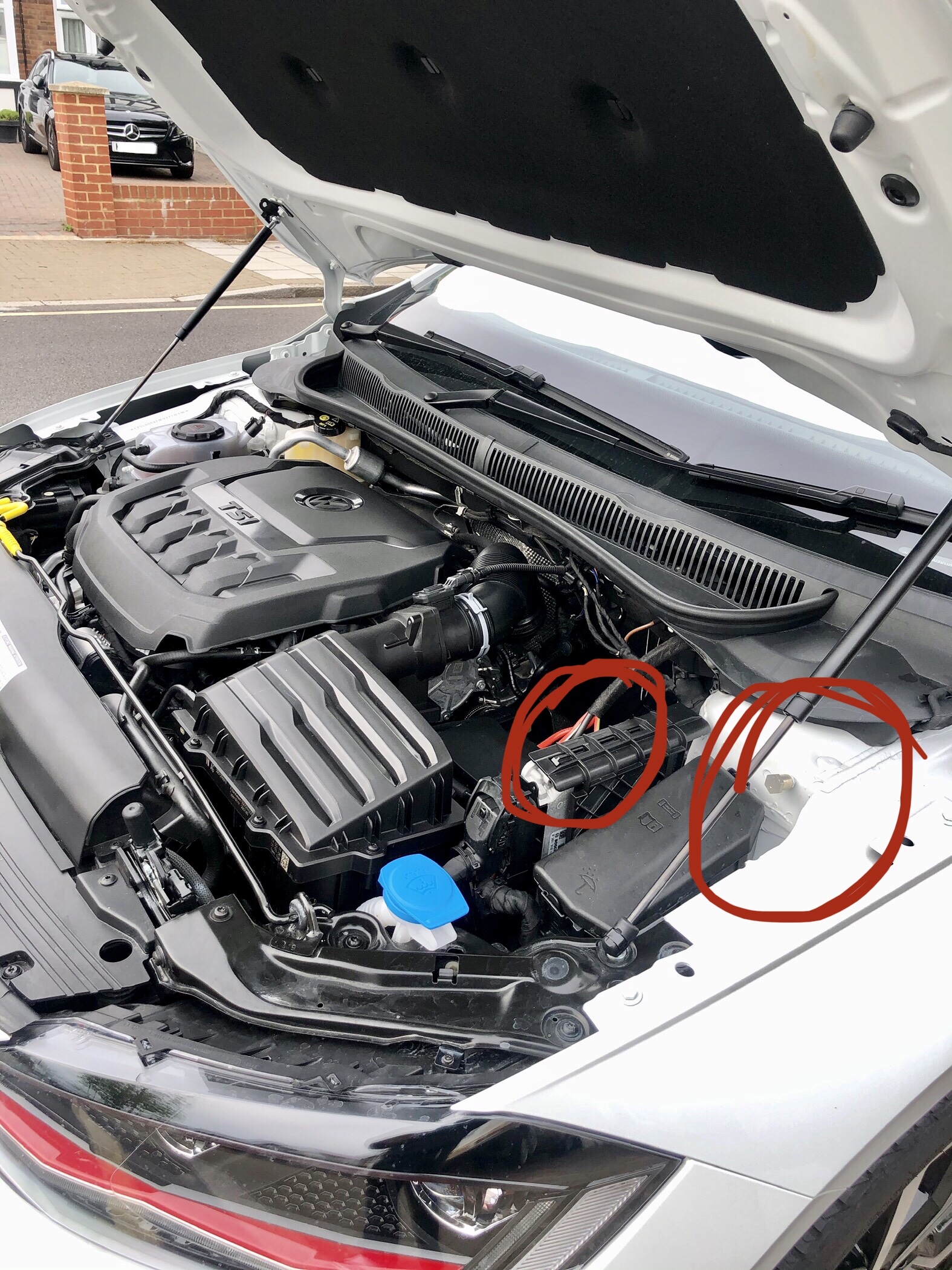

Yes there are 2 terminals in the engine bay, I’ve added a picture to make it easier, one terminal is the earth Or
(- black) in this case it’s the big metal pin & the other is not visible in the picture but it’s just next to the ecu if you spot the thick red (+)wire, I’ve circled them in red in the picture .
Hope this helps .

Yes already found them, but thanks for posting the picture, very helpful.
