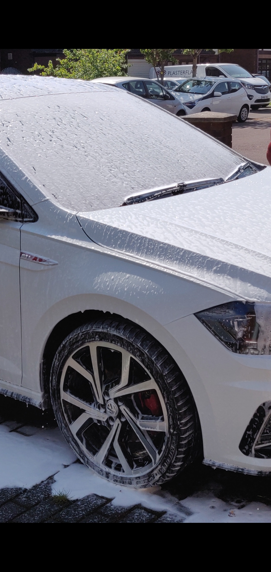

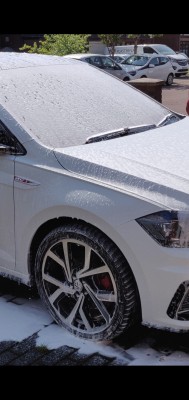

Hi gents I am running 225/40 on Brescia 18” without any issues
Re: The Great Tyre Debate
Absolutely no issues my end either.
Not the best picture but might give you an idea.
