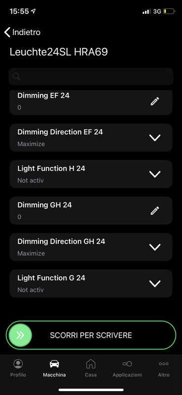

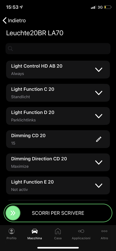

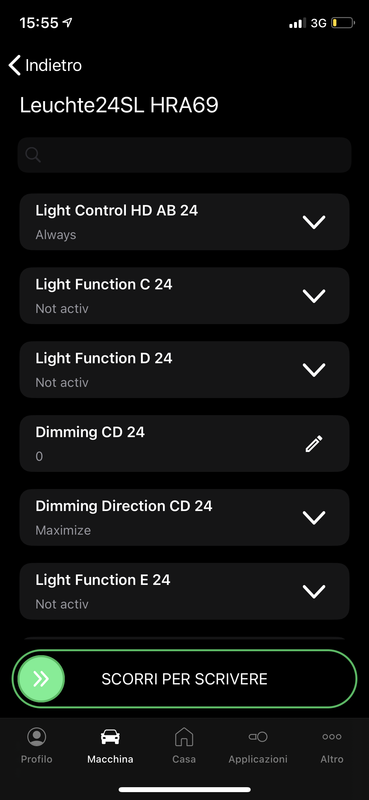

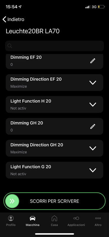

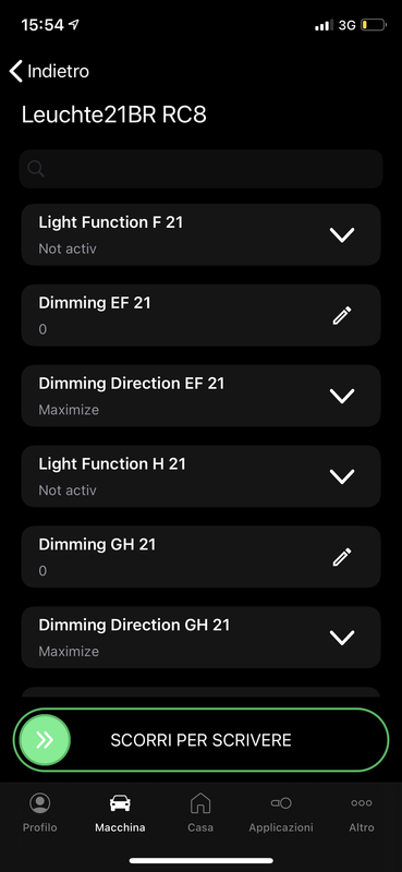

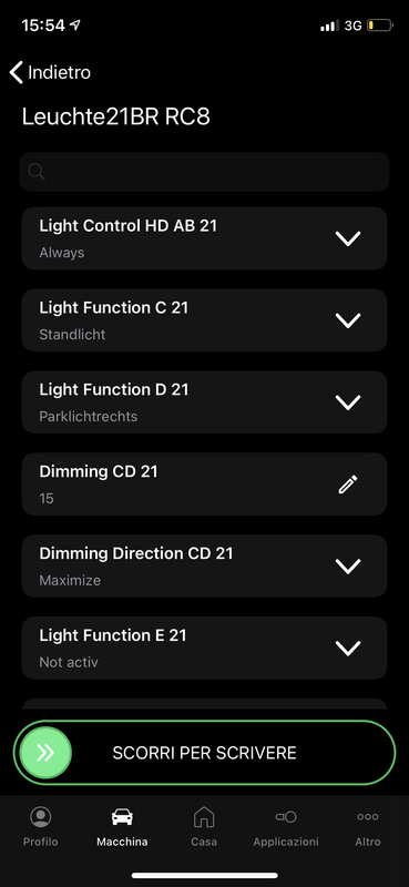

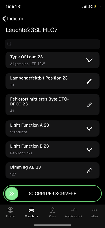

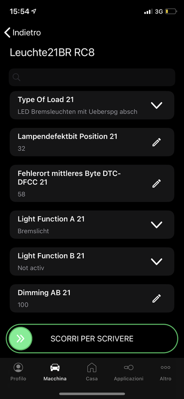

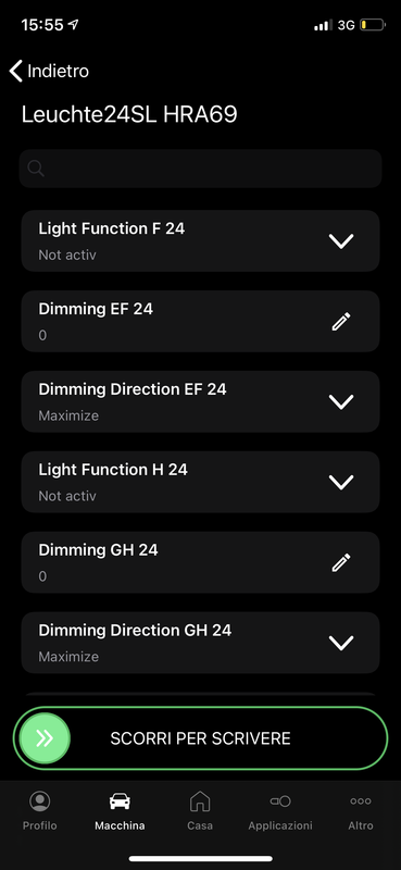

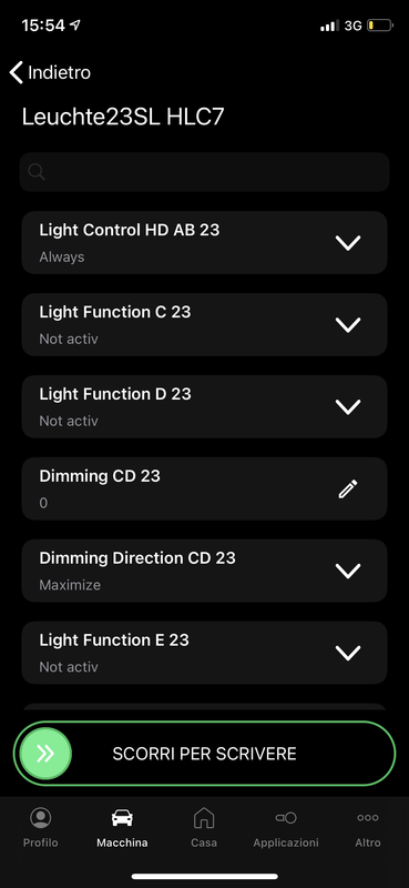

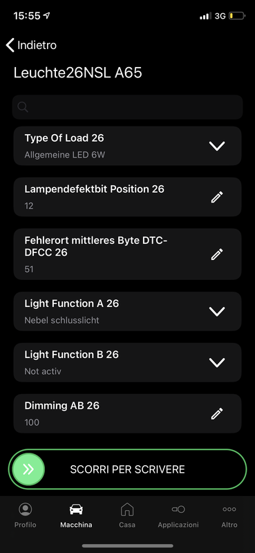

With those settings I fix the errors of the lights, but do I have to change other settings? for example the Dimming of the lights.
Is there anyone who has the original factory fitted LED taillights that can kindly send me the values of these Electric 9 ECU adaptations ?
Leuchte20BR LA70
Leuchte21BR RC8
Leuchte23SL HLC7
Leuchte24SL HRA69
Leuchte26NSL A65
Thanks again.
