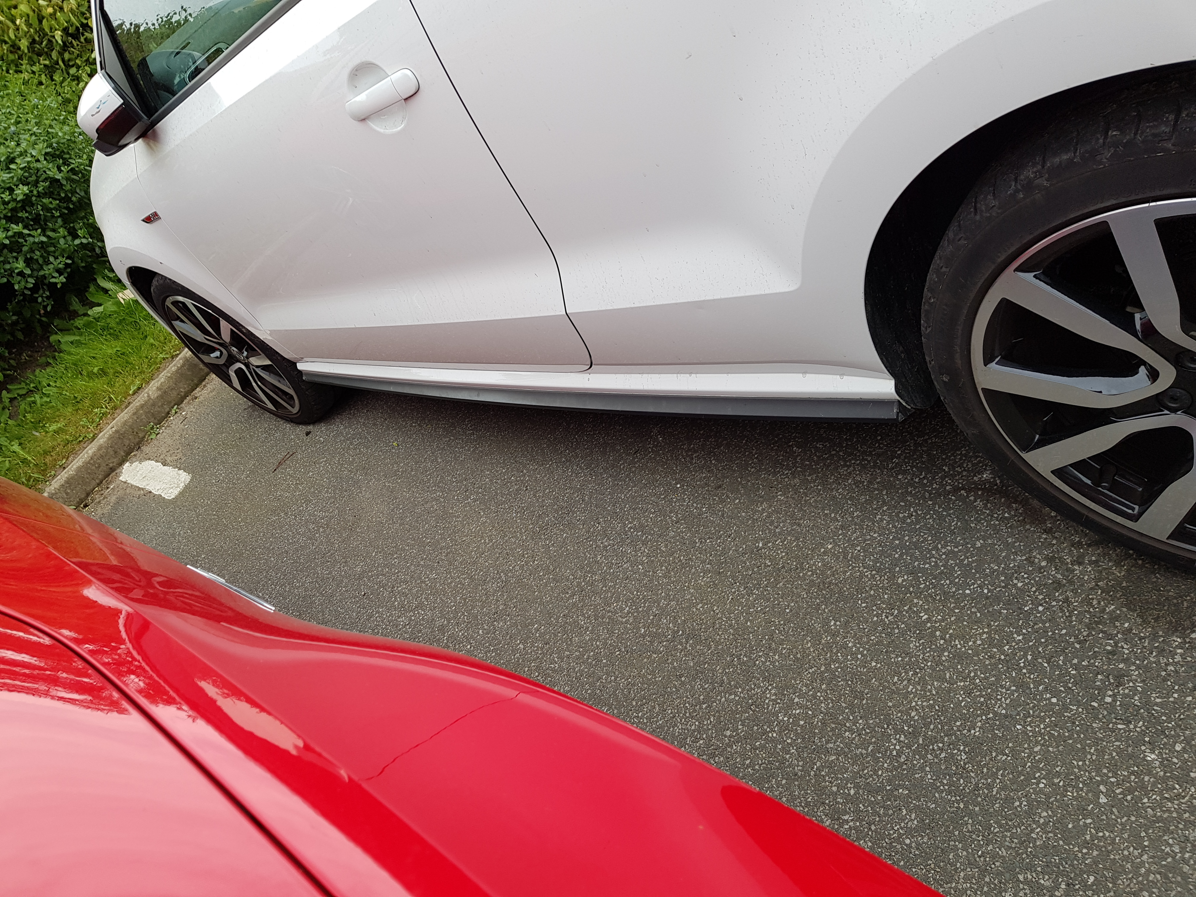

I know this is an old post but does anyone know how these are fitted, any diagram?
Looking at fitting a pair to mine and vw say I will need a bracket for either side too?
I've attached a pic of the parts I want to fit .
Thanks in advance.
Thanks in advance.
